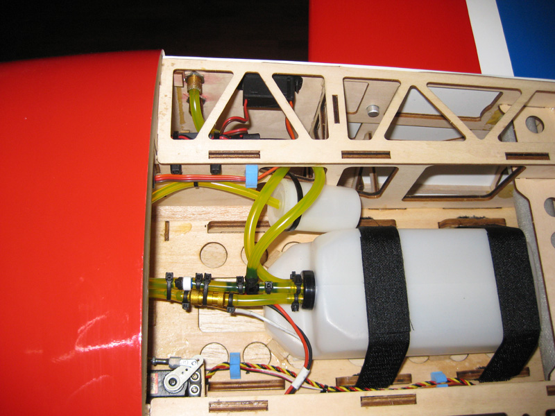

Is anyone running a filter on the carb side? I have one in my fuel can, one on my fuel line in and on the carb side. I'm wondering if getting enough fuel to the carb with the dubro final filter?

ORIGINAL: Rocc
MStam....
That's a little confusing. Let me see if I got the photo right. Fuel in through large filter, out through Hanger 9 filter?
MStam....
I got my gas tank from Jersey Modeler [link=http://www.jerseymodeler.com/id26.html]2.5RHP-R + TRAY Combo.![/link] which already has a filter.
First picture shows the carb vent, medium Tygon fuel line that goes to the little tank/film container. The film container's lit is glued with CA, hole a bit larger than the tubing.
Second picture has a better view on the fuel setup. I have one fuel line to fill/drain the tank and the other with the t-joint is the return overflow line and tank vent, the valve to keep fuel from getting to the engine box. This setup allows clean filling of the plane w/o spilling fuel, a fuel line outside the cowling etc.
Tank inner setup:
One line to the engine with clunk and a piece of brass tubing to keep the line from snapping forward.
Second line with a small piece of fuel line, rest brass tubing bent so it 'lies' on the bottom for fill/drain.
Third vent and overflow, little piece brass tubing bent to the top of the tank.
Use fuel barbs all around, CA and tie all connections in the tank, tie connections outside the tank only.
Hope this is clear [8D]

it is still confusing to me,if it isnt too much to ask,could you post pictures of all the lines going to both the carb and tanks?thats if you dont mind doing it,you know what they say...a picture is worth a thousand words,by the way i also got my fuel can at Jersey modelers,they're the best ever and service is outstanding,love the fueling systems they have

I would be concerned with the check valve on my vent line, it could cause problems with the pump on the carb. Why not just run it to the outside? I know that you will spill a little fuel but you could watch the fuel line on the vent side and when it starts to get fuel to it stop.
Have you run your plane with this setup?
the Jersey modelers fuel can comes with a overflow fuel return line so no mess and no spilling
Yes I had about 20 flights on this bird now. I don't see a reason the valve could cause any issues unless you use it in the opposite way. The valve doesn't have any effect on the pump whatsoever. Air can still get in the tank, fuel can't get out during filling. Very clean and no line at the outside, just 2 standard fuel dots.
