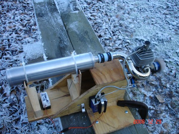

Posts: 7,816
Received 10 Likes on 10 Posts
From: Upplands Vasby, SWEDEN
Default RE: DL-50 engine
Hi!
...Only 6500rpm on a 22x8 ! My MVVS 45cc turns a 24x8 Mentz at 6600rpm.

RTK's Avatar
RTK
Joined: Apr 2003
Posts: 4,890
From: Left Coast , CA
Jaka-, are both on tuned exhaust??? and tuned properly??
