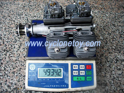

" DLE-222 222CC 4 Cylinder Gas Engine will release out soon! "
I just came across this. They also have a video.
http://www.cyclonetoy.com/listzt.asp?id=1284
ID:	1149226   Click image for larger version
ID:	1149227   Click image for larger version
