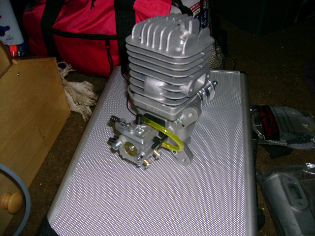

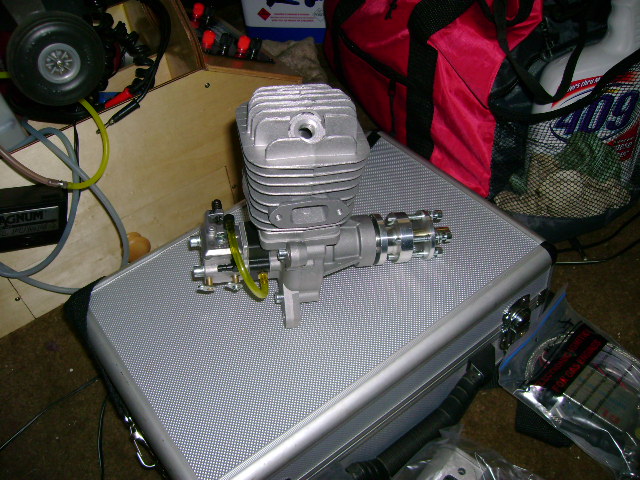

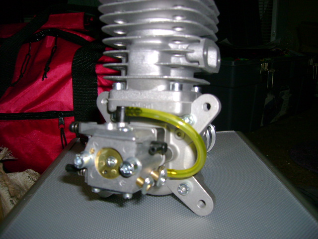

Got mine today Can't wait to get it on my bird and fire it up. What brand props are you guys and maybe some gals running on theirs??? Thanks Eric

3 gallons ashless mineral oil.
Standard muffler: Vess 22A break-in, 22B or 23A after
Tuned pipe: Vess 22A/B, 23B after

Is that a DLE-55? If so what size props do they recommend? Xoar, NX, JXF, or VESS. All very good props. The best prop for your money has to be a JXF. Call Tom at ValleyViewRc. He can drill it for you at no extra charge. I'm running a 27X10 on my DA-100. Great props and there cheap. Tom does a great job drilling them also. Just tell him how you want it drilled.

It say made in 12 of 2008 so I think it is just a DL but that is fine with me. Does lawn boy oil sound right? That what I was told for break in and then bellray there after. I have been flying a Showtime with a Saito 125 in it and what a blast. I would think this is going to be jsut one great buzz flying this motor in my Giles 202 I am going to start at the first page of this thread and read the whole thing. Thanks Eric

Do yourself a favor and ditch the stock plug, it lasts for about one gallon of gas. "The spark plug that comes with the DL50 engine is an NGK CM-6 or equivalent, gapped at 0.018in. to 0.020in. " quoted from the DLUSA website. I haven't had any problems with the NGK CM6, just the cheapy plug that comes with the engine.
