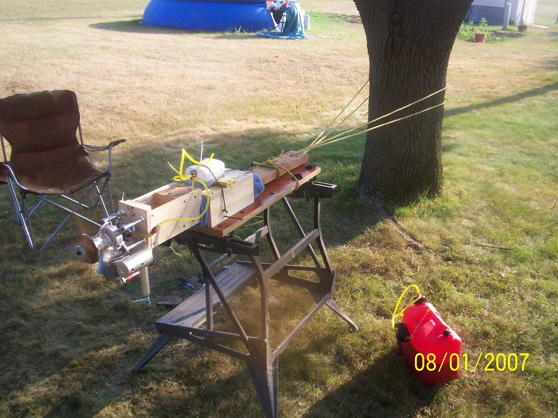

One thing - when you do get it and start breaking it in on the ground, mount it on a dedicated test stand. Not your model.
I just got mine yesterday and I would really like to do the ground running before I'm able to mount it on the airplane which will be awhile. I'd really like to fire it up before I can mount it just in case there are any issues, which I don't anticipate. Plus I really want to hear it run!
I know that DL says not to use a test stand but I have to believe that unless you mount your engine up to a big ol' block of steel it should be able to move around enough to not break the mounts off. I've seen plenty of videos of this being done. If run on test stand, what's the best way to do it?

Just make a long engine box out of some ply you have laying around. That's what I did. Leave the top open and the bottom extend far back to clamp it or wood screw it to a table at the field. I could take some pic's but really it's pretty simple. IT has had several gas engines on it now. A friend used it too. I even have a throttle mount, reciever and battery with switch. Being able to control the engine from a distance is way cool.

Yeah, that's kind of what I was thinking. If you make a test stand that's similar in design to your fuse it should be OK. I'll do that this weekend. I can't wait to hear it run!

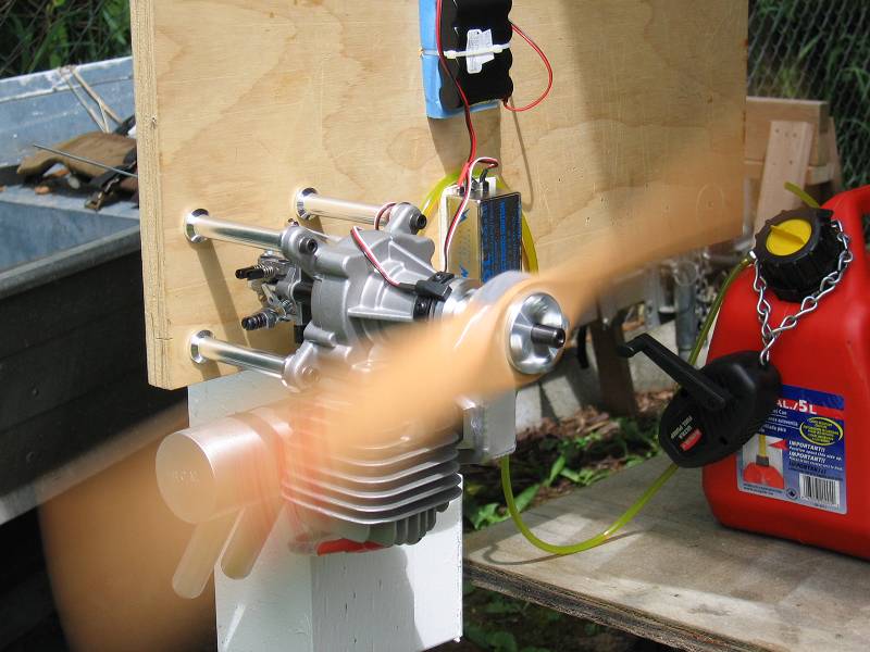

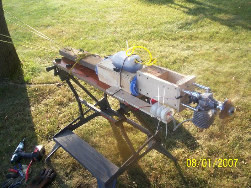

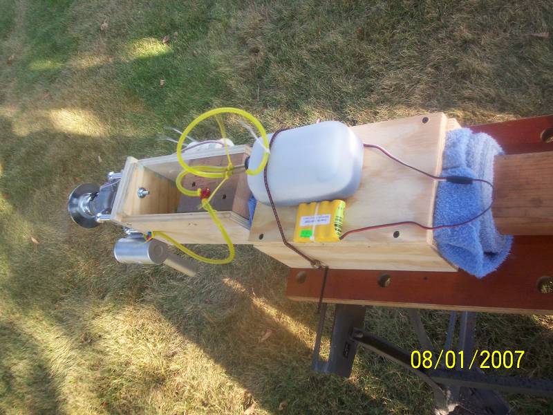

Here is my stand.

It can be much more simple, just a piece of plywood screwed securely to a 4x4 post.
