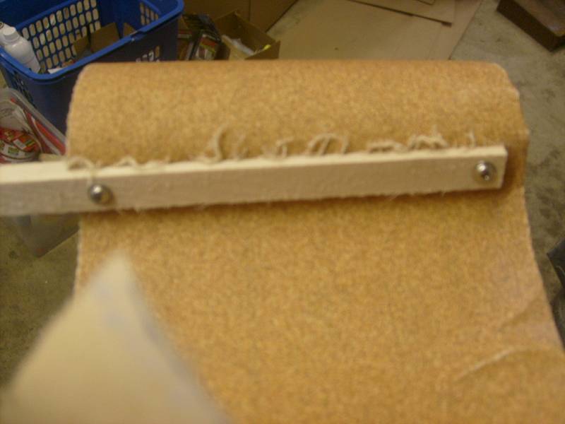

One more thing I tried to post this on the Giles thread but got no answer. Can you guys help me my wing tube it so very tight it is hard to get it threw the plane. But the wings man it feels like they are going to break off just trying to slide them on. Any ideas please? Tried the soap and a little sanding but they did not work please can any body help?

Thanks I got that. Now does anybody know how to undo a tight wing poll? Like I said it is so tight it feels like the wings are going break just putting them on. Any help will do? I have tried to sand the pole a little bit, but that did not work and the soap did not work. So any help would be great please. Thank you... Eric

is your tube inside the wings cardboard? If yes wrap some padding foam around a 3/8" wood dowel. Then wrap some sand paper around the foam (pay attention to the correct direction, depending on you cordless drill) and run this seet up, chucked up in your cordless drill, in side the tubes. Run it back and forth several times 'til the wing tube will fit smoothly. You can do this also on a fiber glass tube. Just takes a bit longer. Don't sand the CF (or Alu tube) that goes inside the wing tubes.

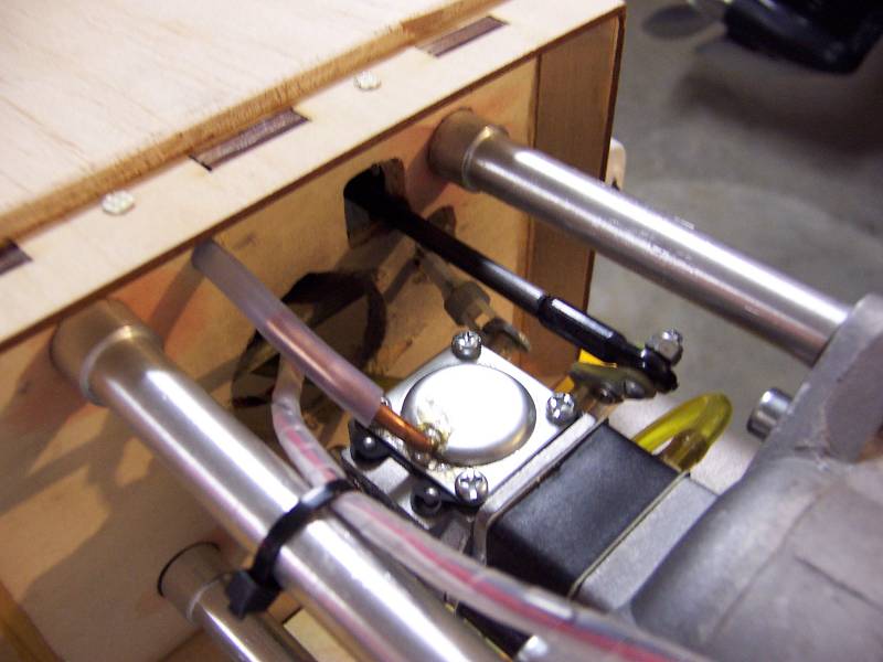

Try to set-up my engine and was wondering what you guys are using over the throttle level to attach to your throttle pushing rod ?

Wrap some sand paper around a wood dowel that's close in diameter to the wing tube. Glue or tape the sand paper to that dowel. Keep sanding till it fits. I just did this and it works.

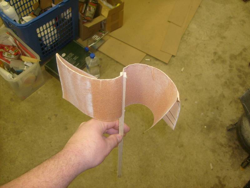

Eric its alot easier then that, just take a full sheet of sand paper and cut a slot up the middle of a piece of dowel or square stock. If you use square stock you'll have to round the end to fit it in the drill. I then put in two screws to hold the sandpaper The dowel just has to fit in a cordless drill. Chuck it up and bend the sand paper a little and stick it in your wing and run the drill till the tube fits. You don't need any thing fancy. Here is some pictures of my rig.

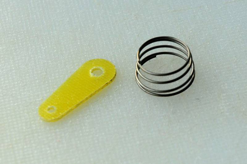

I got this two parts with the engine. Is that the arm i have to attach over (or instead ) the little throttle level ??? And what that spring for ?
If is that arm i have to use, how i fix it ? Remove the actual level and add the new one with bit of threadlock ?

Maybe this will help.

the lever goes on top of the original throttle lever on the carb for easier, better and higher resolution throttle arm. you attach your ball link to this fiberglass arm.
the spring is spare part. there is another one in the spark plug boot. the spare is there in case you lose the original one.

A picture say everything....
Thanks Kevin and liquid
