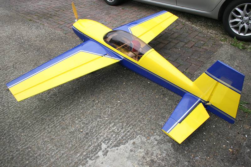

  #1799
Joined: Nov 2004
Posts: 283
From: Oxfordshire, UNITED KINGDOM
Default RE: DL-50 engine
Lastest DL installed and happy!! Ignore the prop, all i had at the time, now on a Mejzlik 23 x 8.
Old 05-16-2008 | 08:09 AM
  #1800
Joined: Nov 2004
Posts: 283
rest of plane.....if interested...lol
