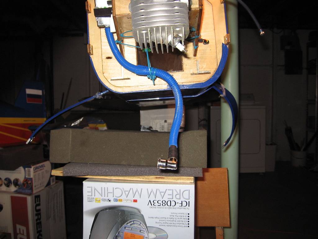

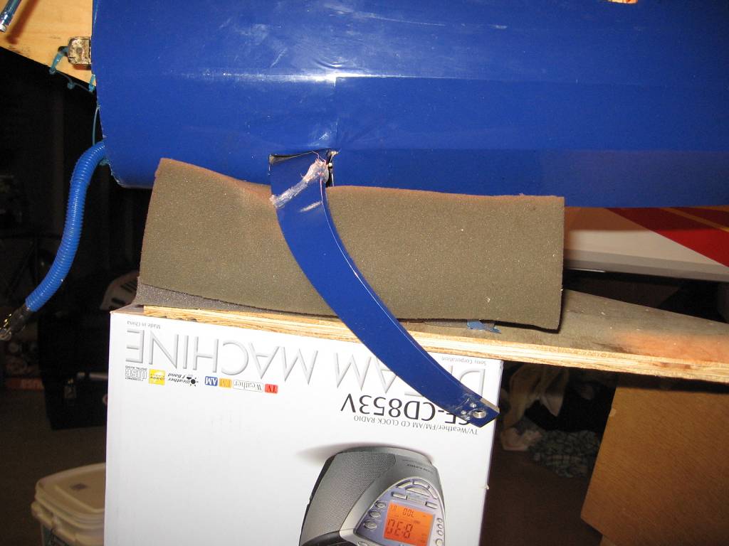

Joined: Aug 2003
Posts: 10,259
From: Milwaukee, WI
Default RE: DL-50 engine
Yeah I pan caked it into some long grass last weekend. [] Luckily it was all minor and is all fixed now. Extreme Flight makes tough planes. You wouldn't believe how straight I got that gear (I didn't believe it myself).

ORIGINAL: JoeAirPort
Wow that gear Amazing it didn't torn the fuse in pieces.
