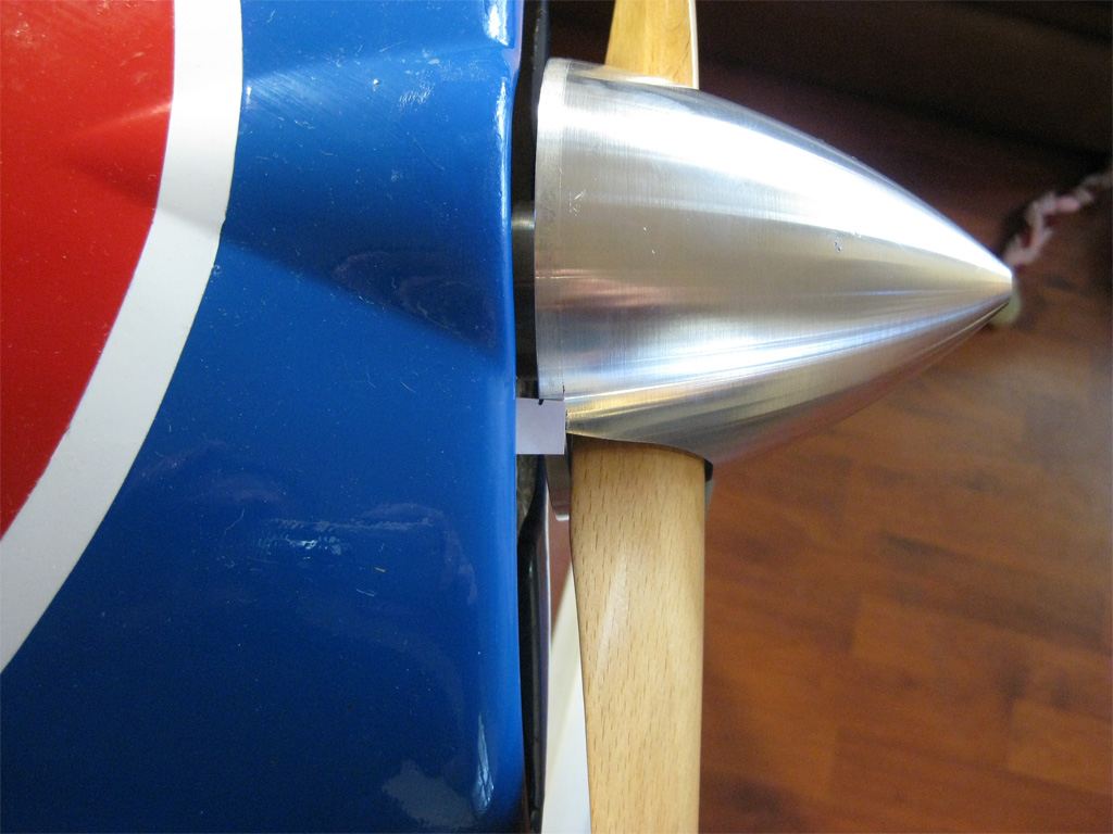

Absolutely. Only thing I noticed is that the spinner wan't centered. Took it off the last flight and the crankshaft looks straight, so does the spinner backplate. Strange...

man,,,that could be anything from loose engine bolts or firewall to the allen bolt that secures the spinner ,off balanced prop ,bent prop stud ,off center crank  failing bearings,whew,,,you got alot to check,unless its obvious,if you havent had any prop strikes or crashes,,,,its easy ,not to look for off balance/center,then all of a sudden you check,i found a off center crank  on another motor,that way,ive noticed on my 50 ,,that theres a hair of endplay ,if one was to move the prop up and down,check yours.

I noticed the tip of the spinner wobbling about a quarter of an inch and the distance of the backplate to the cowling wasn't consistent either. Took the spinner off and the backplate is 100% flat/straight. Maybe the spinner screw, will check tomorrow. Never had an impact.

without having a dial indicator and knowing how to properly check runout,you may never really be able to see ,but if youre getting a wobble on the backplate and the nose ,might sound like something slipping on the prop drive ,,dude,,,i dont know if you have kids,,maybe one of then knocked it off the table ,and didnt say a thing... oops,,,

The propbolt it needs to be locktited, it holds the propdriver on.

Martin, maybe the hub is not pressed on all the way. Or maybe the prop centering bolt is not on all the way? I haven't taken one of these apart so I can only help so much. []

See the difference in the 2 images. That's almost 1/8.
Looks like the DL has its expiration mark set at 30 gallons. This engine got 35 gallons trough it. Even though I ran it for 2 hours earlier this week, it now also makes a loud clicking sound when I turn the prop over.
Gonna ship it to Jody for repair. What is the turnaround time for repair? Not that I'm impatient

Pull the spinner, backplate and cowl. Check to see if the prop nut is tight or if you can loosen it with little pressure.
If it won't come loose get a strap wrench and a deep well socket to take the bolt off. Then pull the propdriver off and inspect it. The problem with the wobble must be in this area. Clean it all with denatured alcohol and reassemble with blue locktite amd torque that propbolt down. It will save you the postage.

Well my other concern is the clicking sound. The bearings feel rock solid though and I just recently replaced the piston. I believe I need to make a tool to hold the hub or IMO use a strap wrench like you mentioned. What is the size of the prop nut?
I'll make a short video about the clicking sound in a minute. Hate to take the engine apart AGAIN.
