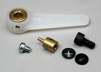

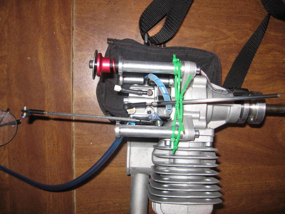

I have a question, i am building a cap 232 27% and putting the dle55 in her, this is my first gasser and what an experience it has been already lol, i am by far not a master builder however i enjoy the heck out of learning. I installed the engine with some da-50 3" standoffs and 1/4 ply added to the firewall so i could get the proper distance from the firewall. i disconnected the throttle spring to get rid of the tenision on my servo, as i am sure you gentlemen are aware, the choke is behind the throttle (closest to the firewall) and is in the exact line as the throttle arm. how can i hook up the choke ? i dont really want to use a servo, i have enough weight up there already. i cant go through the front because the throttle is in the way, i am sorry if i sound ignorant to building, but i am teaching myself as i go along.

My carb's are rotated. It works either way...the choke is on the bottom if the carb is in the stock position (throttle and choke on the left side).

You can flip the throttle arm 180 and screw on the supplied composite arm, or replace with something like a hitec 1" servo arm and a 4-40 bolt, this put them on different levels, and all works neat

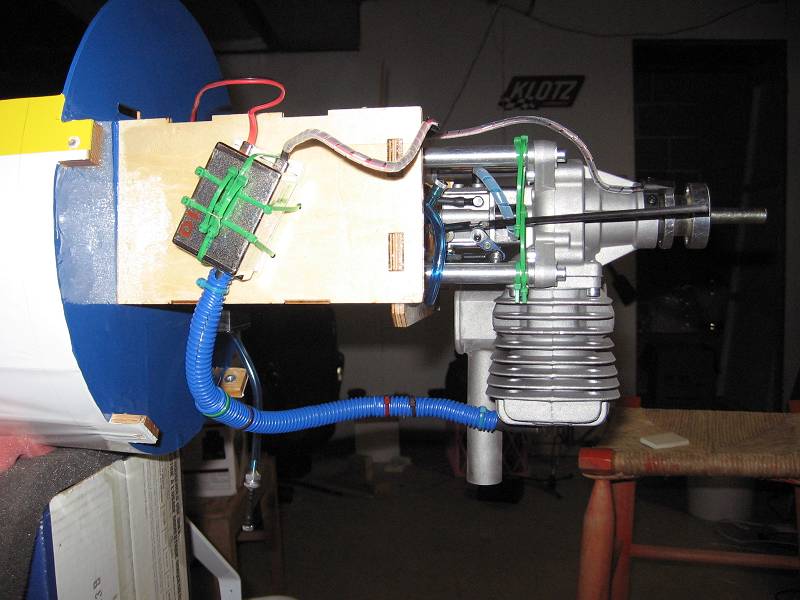

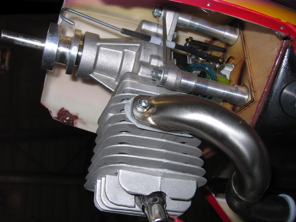

Thank you for the great pics, the problem is that i already have installed the push rod for the throttle and epoxyed the pushrod tube, so i dont think ill be able to flip the throttle are on the carb, is there a way to flip the arn on the choke ?

http://www3.towerhobbies.com/cgi-bin...?&I=LXD847&P=0

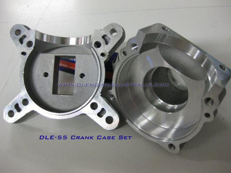

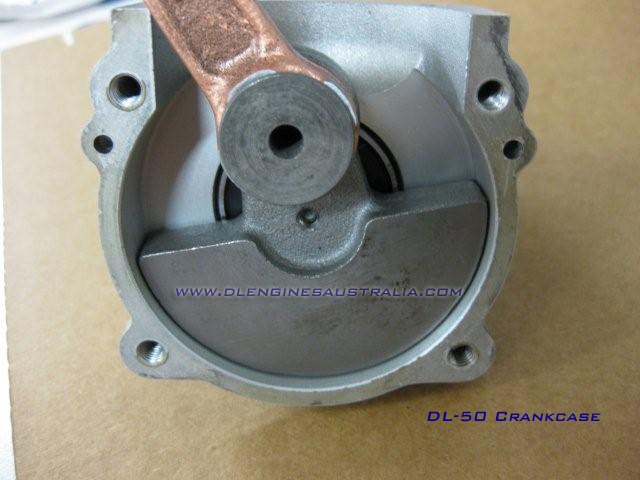

Just for info heres some pics of the DL50 vs the DLE55 crank case. The 55 now has a lip and a recess to improve the seal/increase the surface area of the two mating surfaces. The 50 didnt have this....must have been enough of a problem for DL to want to make a change. Good to see they are always making improvements
See pics.
