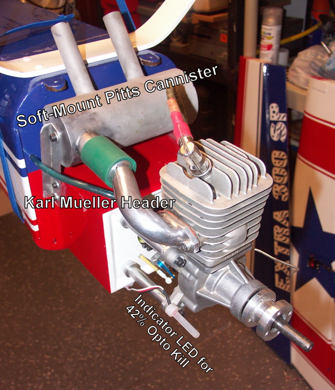

this might sound like a silly question, but can these gas engines mount in the horisontal position? Some of the other brands have a carb mounted on the left side. The DL-50 doesn't, so with a custom exaust does it run ok? Is the cowl the deciding factor?

Thanks Jody, I like the idea of hiding the engine in the cowl, pics of most extras and edges etc have the engine exposed through the bottom of the cowl. i will have to keep my eye out for a pitts style muffler from the horizontal.

Paul,
If you need a Pitts muffler for a horizontal mounted DL50, check this out.
http://www.rcuniverse.com/market/item.cfm?itemID=500589.
It mounts under the engine box. With the right header, it will work with any installation. Just mount the engine so the exhaust would be pointing down.
FYI, you can get a beautiful custom header from Karl Mueller at [email protected] for a very reasonable price. Send him an email.

Those look great. Can you guys tell me what servo you are using on your throttle?? I was thinking about a Hitec 82MG????????????
