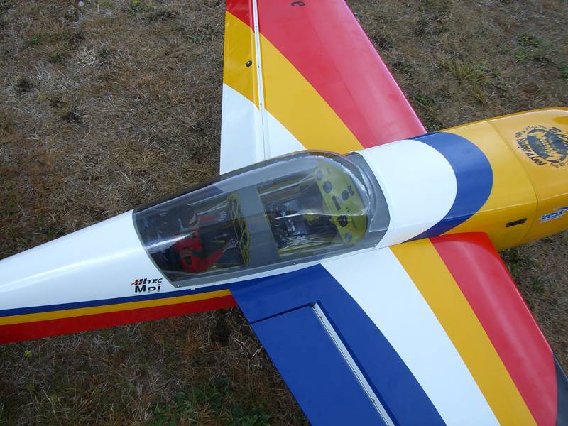

You mean this one???? I have a 3MM 53cc in this one swinging a Vess 22A for break-in. Flies as steady as a rock. Great for 3D!!!!!

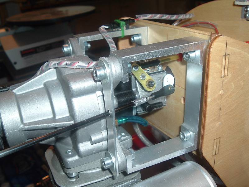

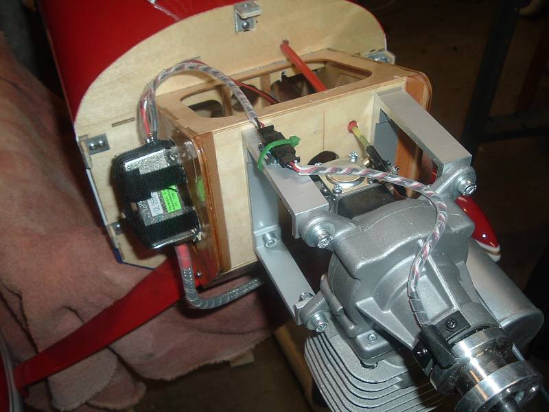

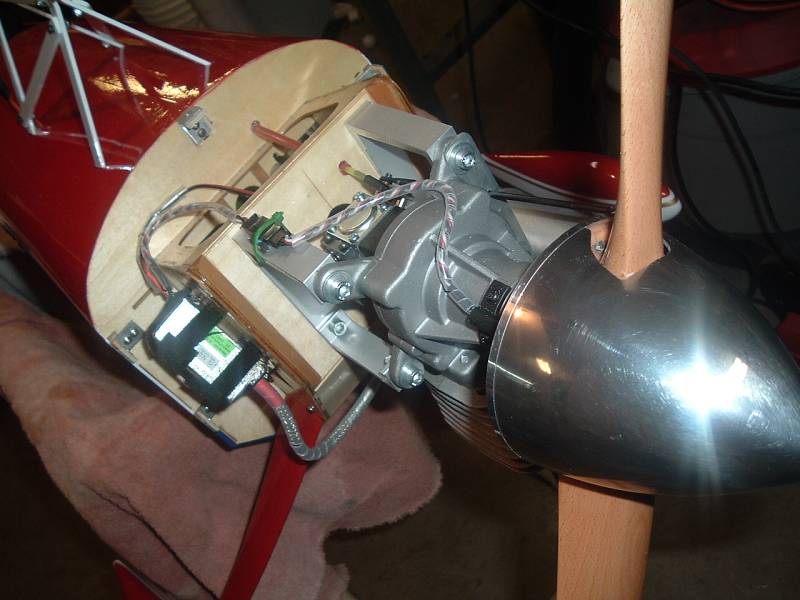

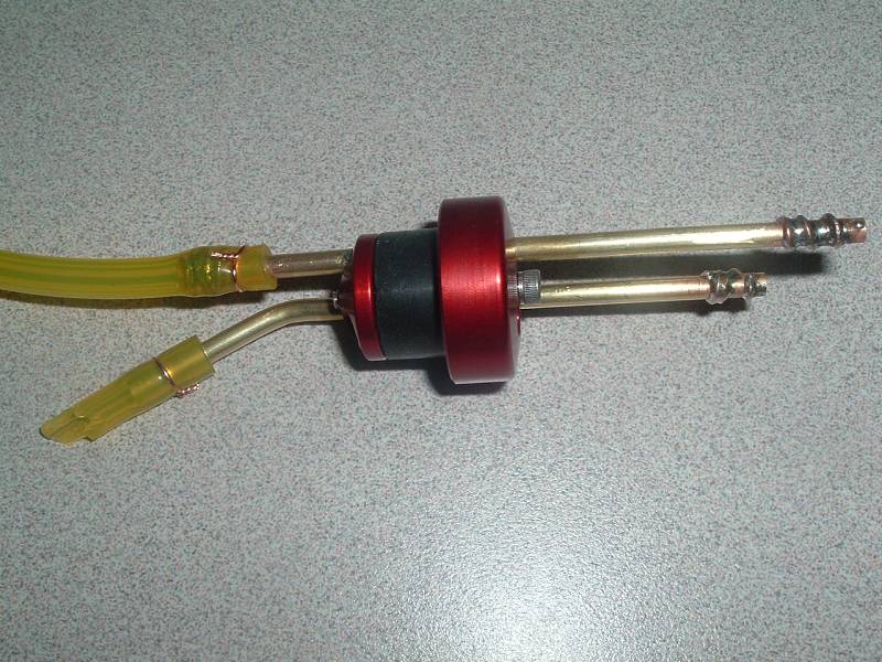

Just got a Vess 22a for this DL50. NICE prop, well finished and very hard wood. Drilled and checked balance and there was not need to. A first for me on the balance thing. Prop bolts only go 2/3 the way through the hub. I assume getting longer bolts will be the right thing to do. I did not have any fuel barbs so here is what I did. Thin solid bell wire wrapped around end of tubing and soldered in place then used wire tie to secure.

VERY clean install - this is better than many do after dozens of gas engine setups! And this is your first!!!!!!!! Well Done! [sm=thumbs_up.gif]
Choke rod is very nice... but will get sawn in two in short order from vibration. I'd overdrill the hole, and stick a grommet in there, or a thin piece of fuel tubing on the carbon rod, maybe? A little friction won't hurt, and you'll want to dampen vibes.
Correct on the Vess, and the longer bolts... I think my longer ones are 45mm for mine.... fortunately, the Vess hub is standard, so even the 23" is the same. One set of "extra" bolts is all you'll need.
Great looking install, Wayne... really!

Nice setup.
Three comments though.
1. The color of the fuel stop is black. Make sure it is for gas (not for glow), as mine is brown.
2. definitely get longer bolts for the prop.
3. watch for the engine standoffs. cases have been documented in earlier posts in this thread that the square standofs failed.

Very nice clean install. I'm using the same stopper you have and have not experienced any problems with it. I would suggest that you either change the mounts in favor of stand-offs or check the mounts every time you fly the plane. In particular, look at the internal corners on the mount. That is where the cracks will appear when they start to fail. Where and when did you buy your engine BTW? It appears you have the older style that I have. The new ones being shipped have thicker ears on the rear case and come with stand-offs.

AL, thats a great looking plane on the last page is it an arf? if so whos kit? and i put my vess prop on today, just took one drop of c a to balance it, and hub didnt need any.

Need to back the thread up for a sec- nonstop is right about the stopper. If you are using a dubro tank and using the black one that came with it, it will work for a while but over time it swells and deteriorates. Eventually it will break up and bits of it will contaminate your fuel. At some point your engine will not work right and you'll have to clean out the carb. I've seen it on multiple occassions.
