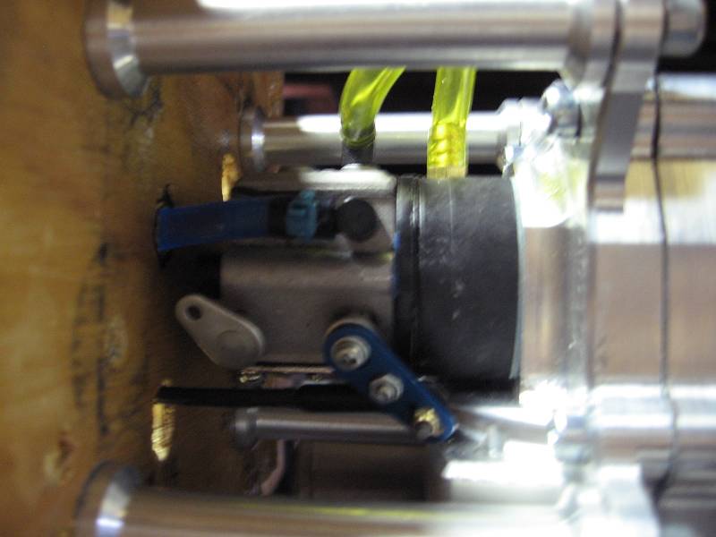

Try putting a pressure tap on your carb vent and plumb it into your fuse. On another site Al Lewis shows a good picture of this on a thread. It might be the turbulants hitting this vent which effects the mixture. It can make it rich or lean depending if the vent is seeing a positive pressure or negative pressure with respect to "true atmospheric pressure".
FYI this mod totally made my engine run better. I highly recommend it. I probably still get drafts into my rear induction but I can't do much about that.

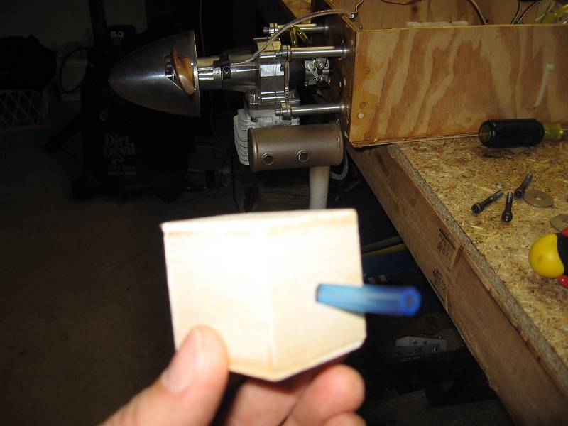

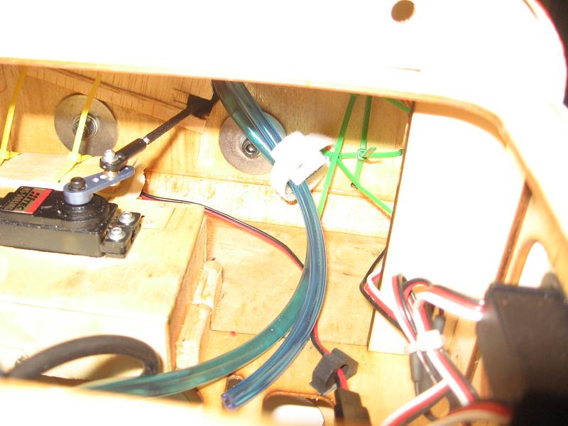

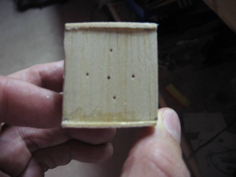

Well allrighty then !!!
The first one shows the carb, the 2nd shows the tube roughted into the fuse.
I made this balsa box and never used it. I'll post some pic's of that too.

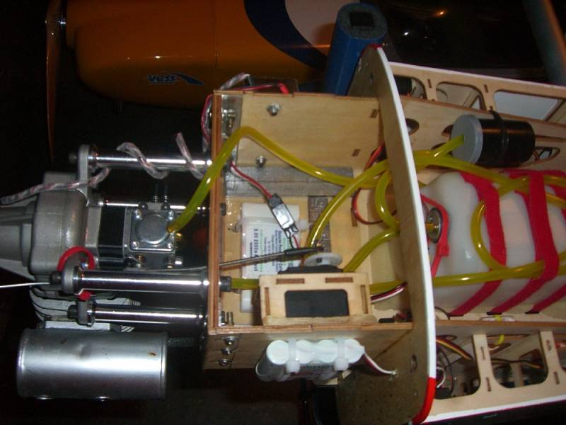

hey JoeAirPort,
is that an extra 260 plane?
re: black round bottle(med bottle) in the fuselage, did you drill holes to vent it?

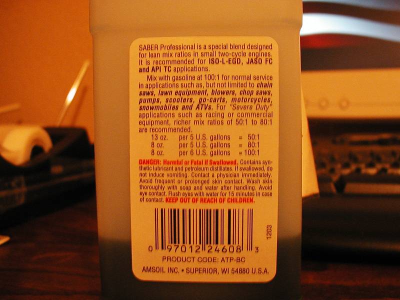

ORIGINAL: mstam1971
. Amsoil Saber is designed for lean 100:1 mixtures. Running it much richer than 80:1 isn't recommended. Many pages back there's a person with a DL100 broken in with a rich oil mixture and his engine is a mess. Wouldn't run anymore.
Simply follow the manufacturer's recommendations and your engine will last you for years.
Not to be argumentative, but,,,,,,,

Is it really considered "Severe Duty" for breaking in a motor especially since you shouldnt be doing any high load vertical climbs?

ORIGINAL: adamasonyx
hey JoeAirPort,
PAU 30% Edge 540.
Not sure how to answer the 2nd question. I just ran the fuel line from the carb vent to the inside of fuse. I didn't use a black round bottle (med bottle).

The ratios specified for the oil during breakin is a property of the oil, not of the break in process. A high quality mineral oil is used to "bead/seat" the rings and the 30:1 ratio of most mineral oils is dictated by the oil manufacture and not by DL/DA/3W etc. The mineral oil is used due to the fact that it is "rougher" than a high quality synthetic. Using a synthetic oil at a higher ratio than that specified by the oil manufacturer will only cause a carbon build up in the head which will will lead to problems in later life with the engine and the motor will never be broken in properly.

i thought it was an SD model extra.
I was referring to this image you posted a while back.
