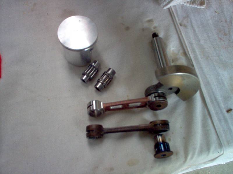

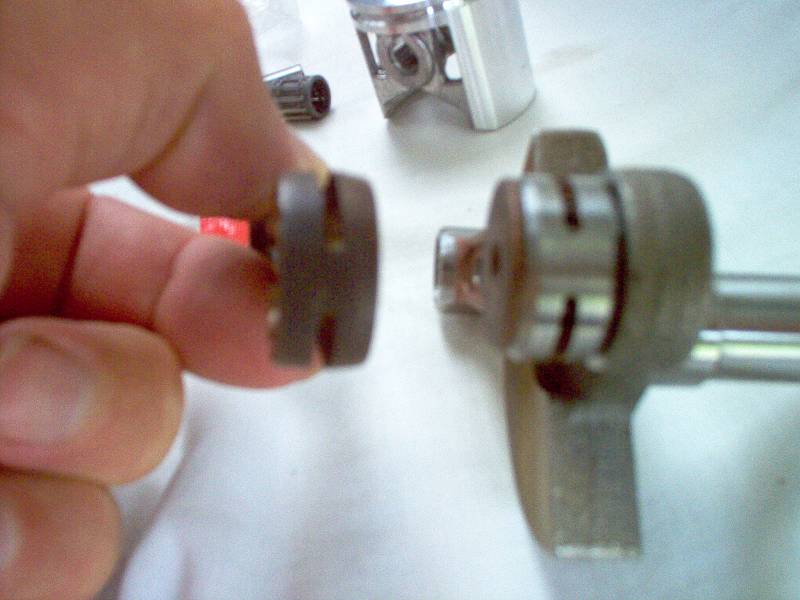

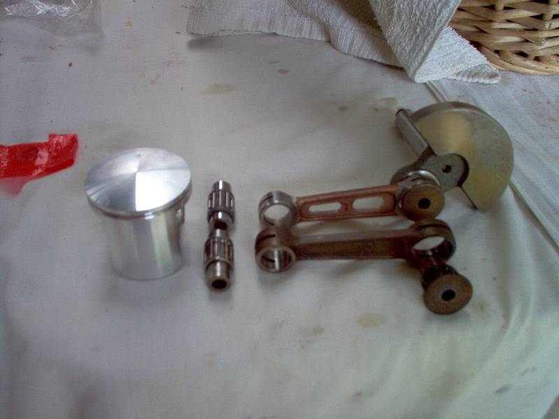

That is very posible, my engine was the old style engine with box section motor mount and thinner engine mount ears, it may have also been as you say rejects of some sort?. I would not bie a engine from over seas now but at the time there were no sellers in Australia, now there is several. I also contacted the Hong Kong seller but he never replyed to me so thats it for him. Apart from the outside changes to the engine I suspect that there are inside changes to the engine as well, when I get my new conecting rod I will no for sure but from the picture of the new part the connecting rod does not look to have any or as big a slot in it and as the rollers were cracked in between the slot maybe they realised the problem and changed the design so the later engines may never have this problem. When I get my new parts I will compare the new and old and put a picture up here and also if there is any problems with the rebuild if the parts are slightly different. I am looking forward to getting this engine going again and having many happy hours flying.
OK ------ now the new parts have arrived and some comparison pictures, there is indeed a slot at either end of the new connecting rod and it apears to be exactly the same in shape and size. the only difference that I can see is that they have lightened the conecting rod by removing metal and on my old rod at each end there was no machining accept for inside and on the new rod they have machined the outside as well and they have put a peval on the outside lip at either end.

Stew when did you buy your motor? I bought mine last September. I was just wandering if my motor has the old crank.

I bought it about mid 2007 but mine from Hong Kong could have been old stock or rejects or something, if you got yours in the US it is probibly OK. I will confirm and document any changes to the inside of the engine when I receive my new parts but I would not get to worryed about it as if your engine is out of warinty and as long as we can get parts they are quite cheap and no more complicated than a glow engine inside you can have a new engine inside for around $100, thats new crank, bearings,connecting rod, piston, ring, gasket set, the conecting rod with big end bearing and conecting rod all come as one part so if the big end bearing goes as mine did you replace the hole crank assembly not just the bearing this hole assembly cost me A$44 . and mine may be the first and only one for this to happon to. As Bob said if it developes exesive play when you rock the prop back and forth (Mine was a good 10 - 15 degrees of slope at any angle) at all 360 digree positions not just at top dead centure as some play here can be normal - my engine was very evident that something was rong and really ratily then stop using the engine or you will have a majour falure shortly after. I hope I have not got every body parinode about there engines, honistly it will stick out like Dogs balls if you get this problem so if you are not really sure then the engine is probibly OK, a few people new something was wrong with my engine by the way it sounded, thats how noticible it was both on the ground and in the air. Go fly and have fun.
