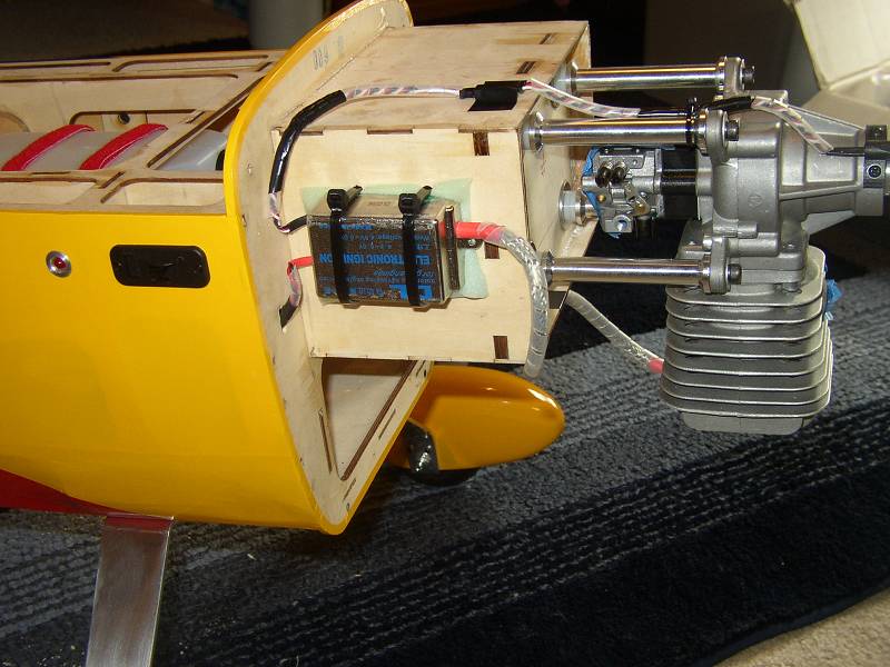

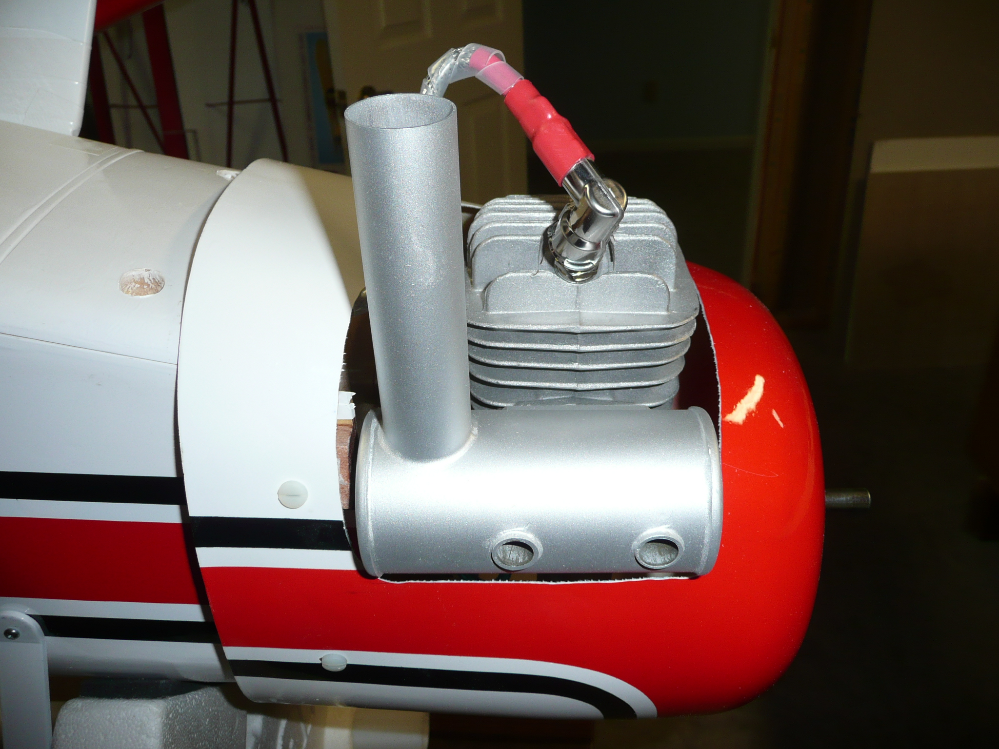

Got my DL installed in the GP Giant Aeromaster. My choke lever did not close the choke completely so after 25-30 flips and I still didn't see any fuel in the lines, I was getting frustrated. Finally realized the choke problem that when fixed, drew fuel thru the lines in about 3 flips, popped on the fifth and fired up on the third flip after choke was opened. It took about an hour to run 24 oz thru at 2000-2500 rpm. Bob at DL USA says I can fly it now with gentle throttle control till I run the rest of the 32:1 Lawnboy mix thru then switch to synthetic. I ended up with Bell Ray MC-1. I know Bob P is a big proponent of Penzoil. I just happened to find the Bell Ray first. I was prepared to use either. Next will be a decent prop, probably Vess 22A. AUW is just a few ounces short of 17 lbs. I need to find a better gas pump. I am using a Dave Brown six shooter converted to gas but man it is really hard to crank. About wore me out putting 24 oz in the tank. What do you guys use.
Here are some pics.

So what does the muffler cutout side look like? I've got the same motor for the Giant Aeromaster. Inquiring minds want too know..

It looks like you don't have any clearance around the spark plug wire as it passes into the cowl. The rubbing will eventually cut through the plastic wrap and the plug wire.

John--scroll over, a LARGE closeup is located to the right of the first photo. Shows the substantial cowl cutting for the muffler.
Thanks Chuck--Before I ran the engine I took up a lot of the slack you see in the photo. I just sort of quick installed the cowl for the photos. The plug wire now does not rub on the cowl and in addition, I wrapped numerous layers of electric tape where it may contact the underside of the cowl.

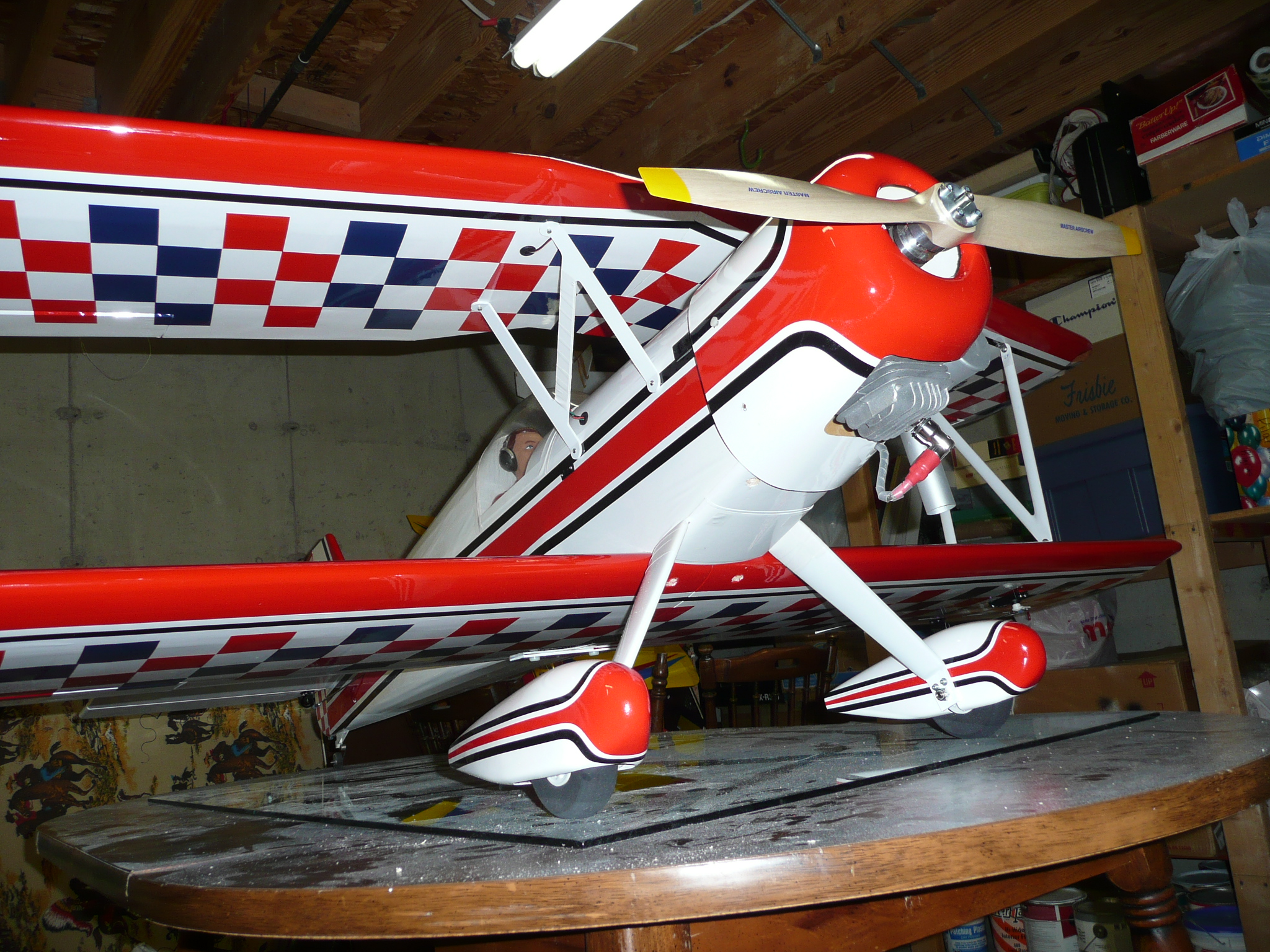

BTW here are some pics of the DL on the WH Edge 540T.
Don't mind some of the tape thats where clips are going to be installed....LOL.
I also ordered one of the back plates from Rich Fabbre that will hopefully help strenghten the DL50 mounting case ears, sense I have one of the older DL50 models with the thinner ears.
Mike

You might want to consider cutting a hole in the firewall by the carb per the DL50 instructions because I believe the clearance is slightly less than an inch. At least it was on mine.

Thanks for the info Chuck,
There is about 1 1/8" right now and it appears that should be good to go.
