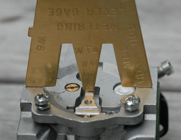

I am learning to use my DL50 on a Nosen Giant Stick. I can't seem to reduce the low and mid range burble no matter how much I lean out the low end. Seems to run best at slightly over 1 turn out on low. At 1 turn low it quit at mid throttle right after take off. High is adjusted slightly below peak rpm. Transitions well, just burbles a lot. Seems to me I have the needles very lean although the plug does not indicate that.
I am using the stock stand off and the firewall is flat.
Now I am wondering if I may be starving the carb for air. Anyone had experience with this issue?
#2242
My Feedback: (198)
Posts: 6,707
From: El Reno, OK
It's far more likely that your specific carb on THAT specific engine has the inlet needle lever inside the carb improperly set. There have been examples where the symptom you report have been absolutely cured by re-adjusting of that lever. If you're not familiar with it, I would contact your seller, and see about trying a "known good" carb to isolate it.
The metering needle lever CAN create exactly the problem you're reporting.
#2243

Hi jjcollett.
I had the same exact problem you are describing and Bob suggested the metering leaver adjustment. The adjustment did the trick for me, it took 7 tries, but I found that it was not difficult to do. But as Bob suggests if you are not comfortable doing this adjustment you may be able to talk your engine seller into a new carb.
If you have questions about the adjustment you can PM me and I will try and help you as much as I can. The article I followed is here.
http://www.geocities.com/farellus/idle_adaptation.html
A couple of tips I can give you now >> be very very careful with the little spring it is very squirrelly and will zing out or your fingers fairly easy. I lost mine for about 5 minutes on one adjustment; I was lucky to find it. After that experience, I left the metering leaver and the spring attached to the carb base. I used two very tiny screwdrivers to bend the leaver into the correct position; you need to be very careful using the tiny screwdrivers, as you may damage the pop off needle, if you putt too much pressure on it.
If you set the metering leaver too low you may run the float cavity dry and your engine will quit. Run it on the ground at full throttle for a couple of minutes to see if it will run without running out of gas, be careful not to overheat your engine.
Also do a spark plug test to see if you are running to lean.
Good luck with it
Geppino

Thanks for the suggestion Bob, the metering leaver pop off pressure turned out to be my problem with my DL50. I did not have a gage so I used the trial and error method. It took me 7 tries and probably would not have gotten it correctly if I had not read the article below on Walbro Carburetors.
It turns out that the needle leaver needs to be lower than the carb base. Mine was at the same height as the base and running rich causing the mid range burble and a lot of mis-fires. I was making adjustments to the leaver a few thousands at a time and getting nowhere. Once I read the article and set the leaver below the base by what looked to my eye about 2 mm give or take, it ran like a top, all the burble and misses are gone. It idles and accelerate a lot better as well, and an added bonus >> I get a couple of extra flight minutes out of my tank.
I also did a spark plug test by running full throttle for a minute and shutting it off. Then I removed the plug and now it's a perfect tan colour.
Geppino
Here are the instructions and a photo from the article.
The Metering System is very simple: It consists of a pivoting lever working like a seesaw with a spring on one side and an Inlet Needle (with a red rubber tip valve) on the other.
If you don't have the pressure-testing tool, don't worry, just make sure you clean the carb, blow it dry and use new diaphragms & gaskets and set the Metering Lever height; The resulting pop-off and reseat pressure will be functional as long as you don't damage or modify the Metering Spring:
1) Don't deform or cut the small Metering Spring. If in doubt, replace it with Walbro part Walbro part # 98-320-7 (OEM # 503 28 12-18; WG8 carburetor).
2) Set the Metering Lever at the correct height as explained below.
The height of the Metering Lever on any diaphragm carburetor is critical for controlling when and how far the inlet needle 'pops' open, thus configuring the engine's acceleration characteristics. If the Metering Lever height is set too high, it may create a rich condition, while a Metering Lever set too low may create a lean condition. The height of the Metering Lever must be 1.7 mm or 0.067" (WG carbs) and 1.45 mm or 0.057" (WB carbs) below the edge of the carburetor body. Walbro sells a calibrated brass plate gage to be used as depth meter (Walbro item # 500-13-1) available through most power tool shops.
