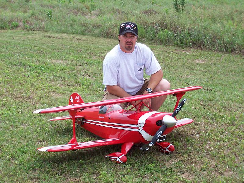

Hello been reading up on some of this thread really thinking about one of these DL-50 's for my great planes S2c pitts been running a Super tigre 3250 with not much results works really well when its running !!And that is far and few between its been sitting in shop all summer with three flights on it just tired of fighting the engine. So would this engine do me justice the price seems right for my budget. with the 3250 my weight is 15pds I had a christen eagle with a Fuji 50 its weight was 20 pds it flew really heavy in the air and wasnt very comfortable to fly [ like tryin to fly a brick with wings ]!!!! Really dont want to go back to that kinda weight if possible.

#2192
Posts: 594
From: RIDGENew York
Drop in that DL 50 and enjoy the the crazy power to weight ratio you will have on that pitts. you will also save a pound or two over that Fuji and be able to swing a better prop like a vess.

I'm flying an RCGUYS 1/3 scale Pitts at 15#. with the DL50 and 22-8 XOAR. It will do more tricks than most pilots can handle, and will vertical out of sight.. You'll be happy with this combo.....
