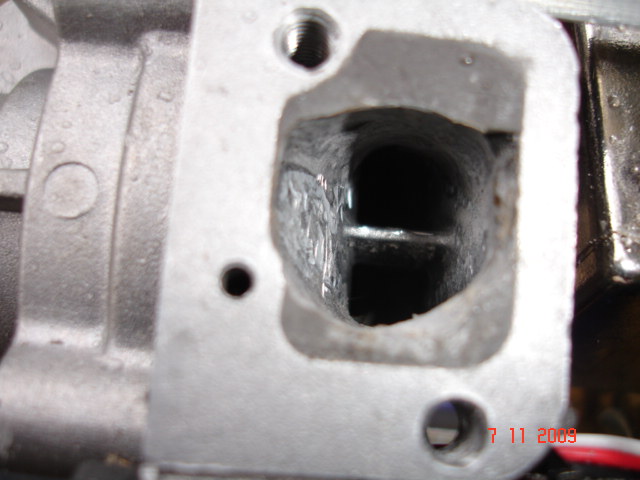

I see the guy over in the other forum packed the intake manifold with Bondo and made a gradual blend from the insulator plate to the reed ports.
He said he used JBWeld <strike>but there must have been $45 worth of JBWeld in there if that's what he used</strike>
I stand corrected
He just used common sense porting practice. <strike>Probably took him a few days because he had to let the stuff cure out?</strike>
There's a couple pictures but if you have your engine manifold apart you can see what must be done.

For you guys that missed it, here is a link to a completly stock DLE30 that would quit in a split second when moved the wrong way. Easy cure so you can at least fly it and get it broke in more yet. That will help to. Again...I like my DLE30 and I am not any kind of dealer...just a person who likes engines! Capt,n http://www.rcuvideos.com/video/DLE30-Tilt-test-run

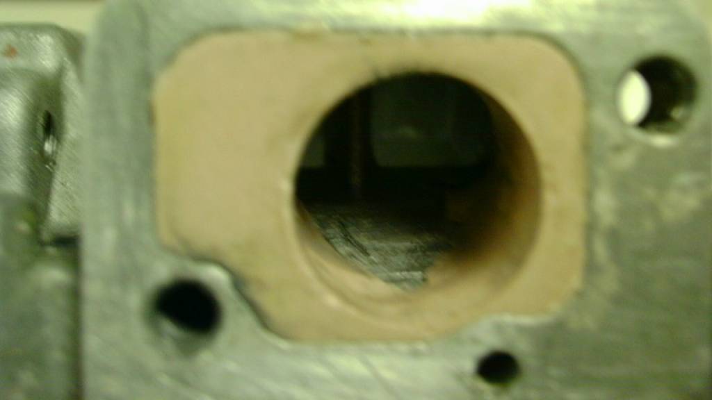

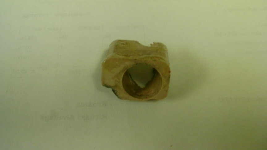

ORIGINAL: mstam1971
Now you made us very curious Jody about that complex fix Is it the backplate, porting, ...?
No, It's not backplate porting.
The problem, as Jody so well indicated in his post before yours, is that it requires thought, time, materials, and a little skilled effort to perform. Done wrong and an engine has the possibility of not running at all, or running well for a little bit then not running after an improperly installed correction detached from its installed position. Ideally, you would not want just anybody making the attempt to manufacture and install a home brewed fix since so many are a little bit hazy about mechanical endeavors. We now live and play in a buy and fly hobby atmosphere and so very many that are involved are very limited in mechanical ability, and/or patience. For them to make attempts and then fail would only perpetuate the original issue and likely generate new ones, ones where they would wrongly want to hold the manufacturer responsible.

Terry, that is a nice part you made, maybe you will have a market to do a few other engines. A chance to make some side money!!!! Capt,n

Now ya did it Terry.
That IS the immediate solution ot the fuel puddling condition. More could be done in other areas to improve things further, but the re-worked intake plenum handles the primary concern. My concerns lie with the number of people that will try this on their own, manage to do something wrong, then take a grinder to their work to clean it out and start over. I can forsee the need to have a lot of aft case halves sitting on the distributor's spare parts shelves.
