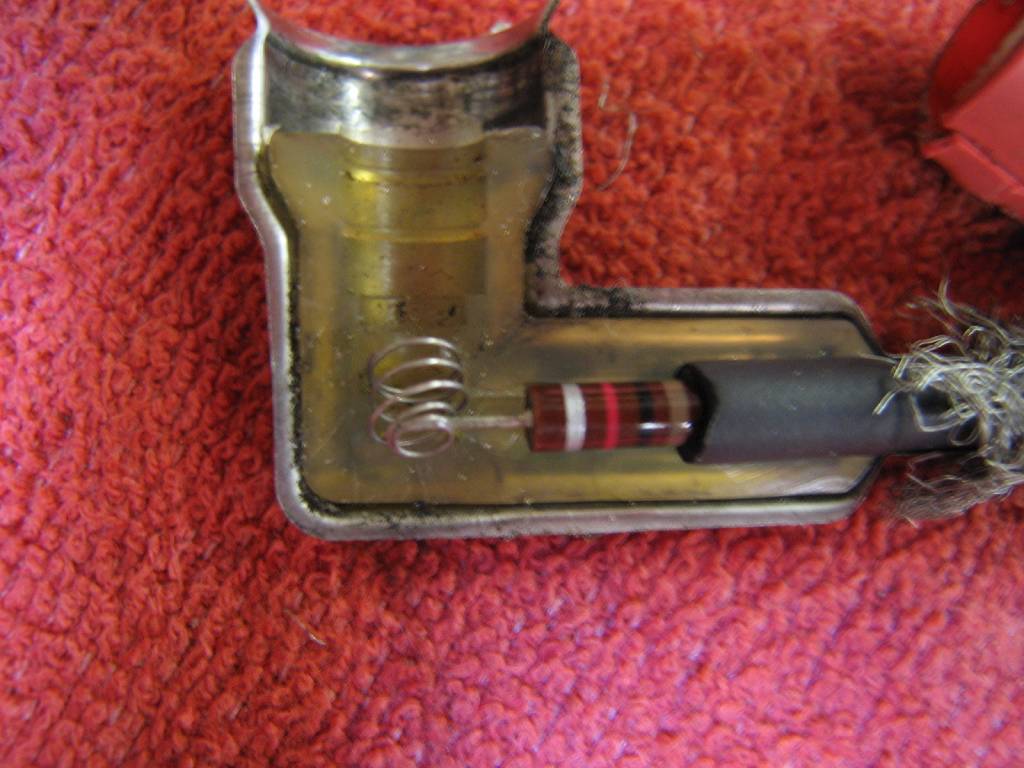

Hi all. very frustrating today t shirt weather not a breath of wind and it wouldnt start. i took the cowl off checked everything and there was no spark. checked a different spark plug and there was still no spark. Can someone tell me inside the plug cap is there a spring or a metal bar which passes the spark along to the plug if you get what i mean? what would be really helpful would be a photo of the actual plug cap
Many thanks

Default RE: NEW DLE30!
http://www.rccdi.com/news/Accessories/14.html
You should see a coiled spring all the way up in the boot that fits the tip of the plug

Here's a picture.

well the spring was off but u dont solder them i dont think, wat i think has happened is it has been put in originally the wrong way so it could go through the bottom just need some heatshrink now and hopefully it will work

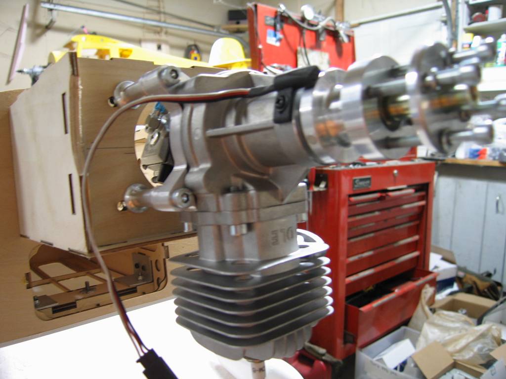

Old 04-11-2010 | 10:25 AM
  #2286
Joined: Dec 2005
Posts: 824
From: Ballwin, MO
What is the overall length now? (from stand offs to prop hub)?
Old 04-11-2010 | 10:31 AM
  #2287
Joined: Aug 2007
Posts: 31
From: , CHINA
ORIGINAL: trpastor
Don't know, i haven't mount it yet.
DLE told me that the engine mount is 30mm longer than old version.

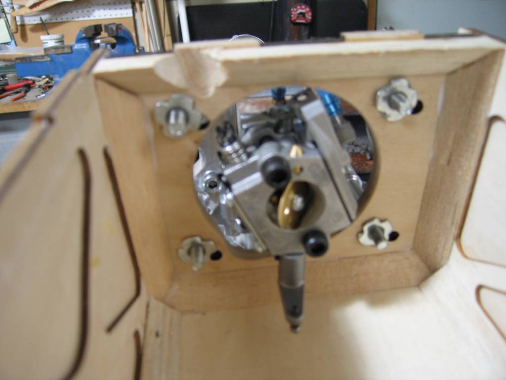

If the hub is going to be 30mm past the old version, that's going to create some problems for some of these planes that have been designed around the original version - isn't it?

Sorry guys, there is no free lunch...You add length to the back, you need longer standoffs...
Be careful what you wish for...
ALL the original 30s I sold are working just fine...The returned ones included...
The one I made with the rear carb is on C&Hs test stand, so the length is no problem...It works just fine too, same power, no better...
If you can't live with the dying problem, much of it self inflicted, go electric...
I still can't see a new rear case and reed for $15....If they ARE indeed $15, I will buy any of my customers who want one and sell it to them for that price, plus shipping, you install it yourself...And get your own longer standoffs..
Good luck on this Jody,
Only problem I've had is some sheared bolts on my single bolt adapters...Can't understand how four 5mm grade 8 allens can shear on a 30cc engine...I'm sending the customer a new hub with EIGHT 5mm allen bolts...This setup will work on a 150cc twin, no way it will not work on a 30...
UPDATE..It will have eight SIX mm grade 8 allens...

ORIGINAL: trpastor
Why?

That must be why we don't need resistor spark plugs..... because there is one built into the cap ?
ORIGINAL: jedijody
Here's a picture.
Old 04-12-2010 | 11:22 AM
  #2299
jedijody's Avatar
Joined: Mar 2005
Posts: 2,812
Correct.
