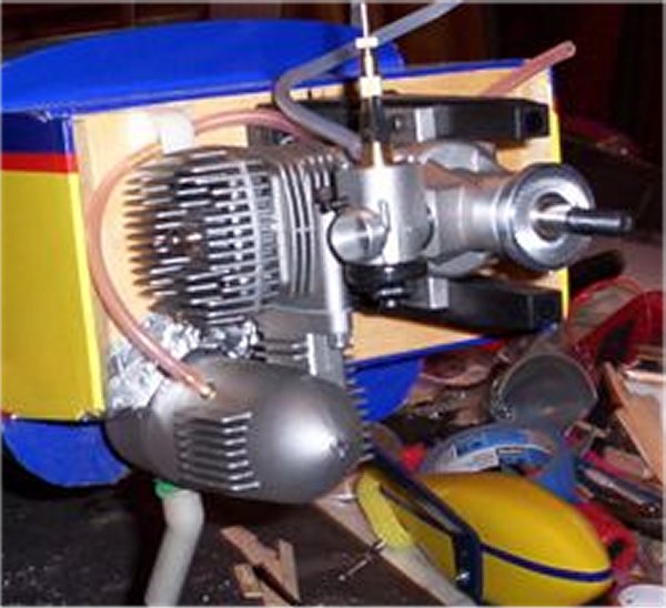

Alright everyone, here's one for ya that I haven't read yet.
I am running an "interesting" setup after HOURS of unsuccessful carb tuning and have "interesting" results to follow...
Perry carb (non)pump
Large fuel tubing on everything
tank placed on carb center line
18x6 Mezjlik (sweet!) 9K rpm
OS f plug
Bisson Pitts Muffler with one tube blocked
And UNIFLOW tank setup.
15% omega
ok, so here's the deal
I am getting great transition from idle to full UNLESS I let it "Idle for too long" OR try to punch it after it's been at full thottle for a while.
Here's what happens:
1. I set idle to around 2K running pretty good then punch it and it gets real rich in mid-range and chugs up to full throttle
2. After running wide open for more than 5 seconds, I slam it back to idle, and try to punch it to full again and the engine goes WAY too lean and dies.
thought: It's a backpressure issue
Defense: The Engine will Idle forever with the muffler pressure line disconnected (won't run at full throttle though)
SO then my question ( WHY the inconsistancy in throttle response? )
Please respond to this thread if you've had decent experience with the 2300, and any proven ideas.

So it may very well be an atomization problem being that the carb throat is too big for this 1.4 engine.
Do you think uping the Nitro will help in transition? Or will I have to settle for the magnum carb???
Yes, but I wouldn't go over 15%.
Magnum or OS 7d seem to be the front runners when it comes to replacing the stock carb. These are the only two carbs I have not read anything bad about after the swap. Perry and Jett seem to still be a little off. I chose the magnum carb for price alone. It works great on my engine, with none of the problems you listed originally.

The inner carb opening on the 2300 is 11mm according to Tower Hobbies and the inner opening for the OS 160 is 9.5mm. That means the 2300 has a larger carb than the OS160 and that might very well be the problem. I think the reason I saw better transition with homemade glow system is that it kept the glow plug light and prevented it from going out as the unatomized fuel poured in. I still saw hesitation even with the continious glow system.

Your engine is loading with fuel at low idle, thats why it only stumbles after long periods of low idle. The fix is simply turning in the low needle until it will idle low for a minute or more with only a minimum of stumbling when the throttle is opened. The other part of your problem is that the carb bore is too large for the rpm you are turning. Find a smaller carb or sleeve down the stock one until the peak power comes down 100 rpm or more, at this point muffler pressure will not be needed.

I think at this point I am thinking placing a restriction in the carb inlet is my best option. I'll try to homebrew a cyclinder to fit inside my Perry carb. When I do, How much INSIDE diameter should Be left open????

Depending on the diameter of the spraybar, about a 9-10mm bore. Sometimes a restrictive airfilter will help with fuel draw but is only effective at full throttle. Reducing the venturi increases the velocity around the spraybar where it does the most good. Rotating barrel carbs are limited in their ability to draw fuel at part throttle but are easy to make and the most forgiving over a range of applications.
