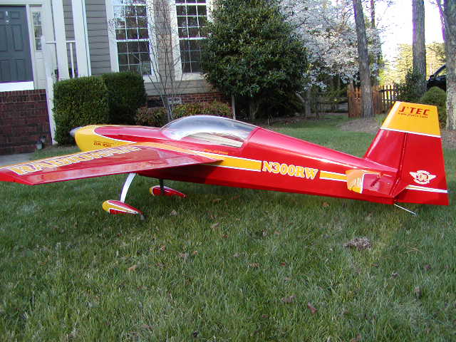

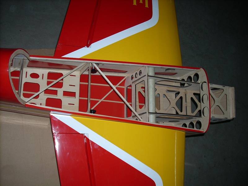

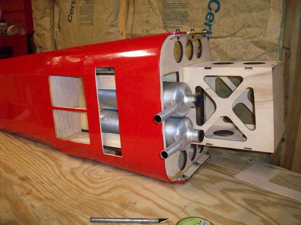

here are a couple of pics of customers airplanes that I have on my pc.
the first two are of a 2.7m that has a DA85 and KS 1090 tuned pipe. Jon actually did a thread on here showing his install of the KS 1090 in it.
The three pics after that are from one of our customers David Thompson who is shown in the one picture.
Hey Kevin,
Thanks for the photo's thats a big help. I also looked at Don S. build blog for his Extra, so I have some good idea's,....greatly appreciate it.
I ran a two reciever set up some years ago in my 40% Cap's and it worked good,...but far less servos in those than in the JTEC Extra. I eventually used the I4C Isolators with each reciever with two batteries per Isolator. I dont' think with my 9Z-WC2 I can do that,...I tried it with the first Extra that went in. However,there were some issues with the servos know one knew about like you cannot put the 5645 on Y-harnesses with out having a resistor removed. The servos would constantly fight themselves looking for center. Secondly,...at the time the program speed said .15 to .20,...found out from tech support that 18 was about it. if you went lower than that it aggrevated the centering issue even worse with Y-harnesses. The end results was on the second flight it pulled the 2-4200Mah NICMH packs to the point they dumped. I had a seperate battery on the reciever,...but no power to the servos....a beautiful down lineline all the way to the asphauldt...[:-]
Anyway,..I think I will try the Powerbox Royal with a 2 reciever setup with the LCD readout,...pretty kool!
Again,... Thanks for the great support!!
Bill Holsten
