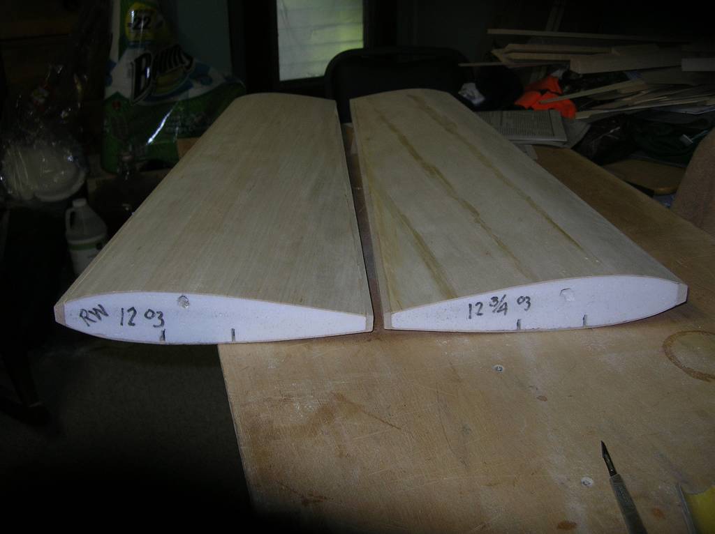

I have removed the wings from the laminating process and trimmed and sandes all of the edges and sanded in the dihedral. I was about to epoxy the leading and trailing stock in place and found that the airfoil or wing thickness at the center of the wing was thicker than that in the plan. I did not want to laminate material to the stock that I had on hand for the leading and trailing edges, so I have ordered the proper sizes from the Balsa Store that will fit.
The flight surfaces have been lightly sanded to contour, without any flat spots and just sitting in the shucks for now.
The wing cores with skins and landing gear blocks with the walls and floors in place have a weight of: L/W 10 and 3/8 ounces and R/W 10 and 1/3 ounces. Not too much more to report.
Jim
Well, today another hickup.
Jim
sounds like you are right on target. At a touch under 21 ounces you have about 4 ounces left for TE, LE, tips and ailerons and chin. You might need 5 or 6 tops so your wing will be 25-26 ounces. Your sheeting might have been a tad heavy or perhaps a little too much glue. In any case, it is hard to build a 60 size classic with wings in the sub 22 ounces unless they are thin airfoil wings like in the more modern designs (e.g., Aurora, Beetle, etc.).
Remind me what you are planning to use for servos.
BTW, are the cores symmetric or did one core TE end up being different than the other? I had that problem with the GP cores I built of which I posted pics in this thread. I had to fix it prior to sheeting (about 80% fix) and then the remaining 20% afterward by sanding the wood to even thickness in each panel. My Tipo 10 cores were perfect. The wing was a snap to build - each panel just tracked the other like a mirror image - the beauty of good, exact cores.
David.

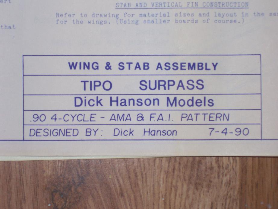

In order:
[ul][*] Tipo 720 - the original classic[*] Tipo 750 (eventually also became the Illusion with appropriate fuse mods - this was moved by Dave Brown primarily I believe) [*] Tipo 825 - also known as the Hippo Tipo. It had a recess in the right side of the fuse for the pipe to use RE engines as shown in the pictures above.[*] Tipo 850 - not sure about this one but I believe there was a larger version yet than the HT and it didn't have the pipe tunnel recess.[*] Tipo 686 - known as the Tipo Surpass - designed for 4 stroke 90's with conventional gear. Aimed for the start of turnaround pattern. This model was 61" square.
[/ul]
With some luck, Mark (impaqtiq - another Tipo fan) or Dick Hanson will be able to confirm/clarify my response. This is off the top of my head and I've never owned a Tipo other than a T720.
David.

This morning I managed to get the leading and trailing edge contours to match the wing airfoil. I used an old square exacto blade to cut the epoxy from the leading and trailing edge being careful not to get into the planking. It just took a lot of time but it is done.
I took pictures of both sides of the wings and will post them. The right wing weighs 12.00 ounces and the left wing weighs 12 3/4 ounces. At least the weights are comprable for a side mounted engine. The tips and the remaining parts are not included at this time.

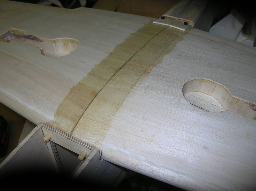

Jim,
A suggestion/recommendation. When you join the wings, first glass the center section to produce a rock solid center section. Other than the stub spars to support the core in the landing gear area, the Tipo has no cross panel spar so it is important to glass that center area well.
There are different school of thought on this but my preferred method is to use 2-3 layers of cloth in decreasing weight and increasing width. Basically, I join the panels with epoxy (30 min or slower) making sure they are dead level with each other. Before you join them, butt them up at the root and keep the wing tips level to the table. The sight down the wing from the front and back making sure one is not twisted with respect to the other. Parallax help here to sight them equally. If you are happy with the levelness, join them and don't worry too much if the roots are not perfectly matched. So long as they are within less than 1/16" difference, you can sand the joint smooth after the epoxy is cured.
Then, once the center section is sanded smooth, glass the center with 6 oz cloth spanning 3" wide. I use finishing resin for this step and here I do cut it with alcohol to thin it out - after all you're glassing not gluing. Once that is cured, you then can go out to the inner edge of the wheel wells with 2 oz or lighter cloth. I actually use a 2 ply of 3/4 oz cloth to give me a 1.5 oz weight so to speak.
When I do the glassing, I apply masking tape along the edge of where I want the glass to end. Then, once it has been wetted out, I wait for the epoxy to start setting up (about an hour or two - depends on climate) and then take a #11 blade and cut the glass being careful not to go into the sheeting along the inner masking tape line. If you do this at the right time, the masking tape will lift with the excess glass and leave a nice straight line along the edge which you can pat down with an alcohol wet finger to fair it into the wing. I sand all glass in between layers after curing.
This is really still wing construction and I typically leave "finishing" glassing until the model is complete and all radio equipment and engine has been installed. When you get to that stage, you can then proceed to glass the remaining wood on the wing with 0.5 cloth and polycrilic. I don't believe that the poly holds over epoxy so make sure you do a clean job on the center section. Before you glass the wood with poly, you do need to seal it first and sand it out. Good stuff is Minwax sanding sealer but you can also use Hobbico white wood filler watered down and brushed on - the former should be cheaper. Then once everything is sanded smooth and filled as needed (with automotive filler), you can prime the model.
In short, delay finishing glass work until the end.
David.

Well, the wings are joined and the center section will be glassed tomorrow. I have included a picture of where I am.
The leading radii is completed and the hinges are positioned in the trailing edge of the wing. The ailerons are now chamfered but the hinge holes are yet to be put in.
I will use the laminating epoxy for the fiberglassing of the center section and then I will built the front of the lower center section to match the lower part of the fuselage where the nose gear is. I will get the dowel in place for the front of the wing as well as the hold down screws. Not too sure I can get all of this done by tomorrow but that is the goal.

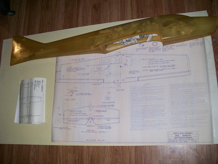

#119
ORIGINAL: doxilia
David,
that's a sweet looking T825. It needs to be polished up and made flight line ready for some serious flyby's!
What' it got for engine and gear? It'd be interesting to see some pics of the radio install, tank, etc - might assist Jim.
David.
David,
David.
David, just getting back to revisiting this thread. My Tipo has a Rossi RE and pipe, although it could be an OPS RE. I need to get the photos you mentioned posted here.

The wings are now rough fitted to the fuselage, meaning that they are centered side to side and perpendicular to the rear of the fuselage. I have only marked the side of the wing with an ink pen for reference so that when I am ready I can get close to the correct position easier. I need to recheck the angle of incidence a couple of more times to get some confidence that what I have done is in fact where it should be. Can't be too cautious here.
The center section is glassed and sitting on the bench waiting to cure.
The ailerons are hinged and are put aside for later installation. I have not however put in the 4-40 threaded hole in the dowel for the aieleron horn. That will come later.
Kinda done for the day.

The wing is set into place with the proper incidence relative to the thrust line. (+.125 inches) and the two front dowels are installed such that they go through former "A". I have not tied down the trailing edge yet. That will come tomorrow. I have to install some dowels and flush them out along with a piece of light ply backing on the underside of the wing.
When the retracts get here I can start working on creating the front belly pan. I am thinking about making it removable for access to the retract.
Jim

Update:
The wings are now joined to the fuselage. I have attached a picture.
The next task is going to be to fabricate a removable cover for the front retract. This will allow me to access the tank without removing the wing and deal with any unforseen issues with the retract.
Jim

Nice work Jim!
Glad to see you decided to go with the front dowel approach - much cleaner and easier to just mount two bolts than 3 or 4. While it probably isn't required, it wouldn't hurt, for a little additional insurance to add a 1/8" ply doubler to the front of the former where the dowels go in. The laminate of the two pieces of ply, provides that extra bit of strength. I'd also add two pieces of 3/8" tristock on the side where the ply bonds to the fuse sides. Weight gain will be marginal. Some builders also like to encase their 1/4" hardwood dowels in aluminum tubes, this keeps the diameter constant and prevents them wearing down with fuel, elements over time. A nicer alternative, I think, is to use bamboo dowels - that stuff is rock solid and will last an eternity. Some Japanese kits used to come with bamboo.
One other suggestion would be to apply a second layer of glass (you're looking for 1.5 to 2 oz cloth) out to the edge of the wells. This should be roughly 6-8" wide if I recall correctly. This is structural glass since the wing joint has no strength other than for this glassing unlike other pattern wings which sometimes use flat cross panel full height spars. When you apply your finishing glass over the entire wing, that is really for paint prep and it doesn't contribute a great deal of strength to the joint although it does make the wing that much stiffer overall.
I look forward to seeing a frame up of the model - some bench flying is important! [8D]
David.
David.
