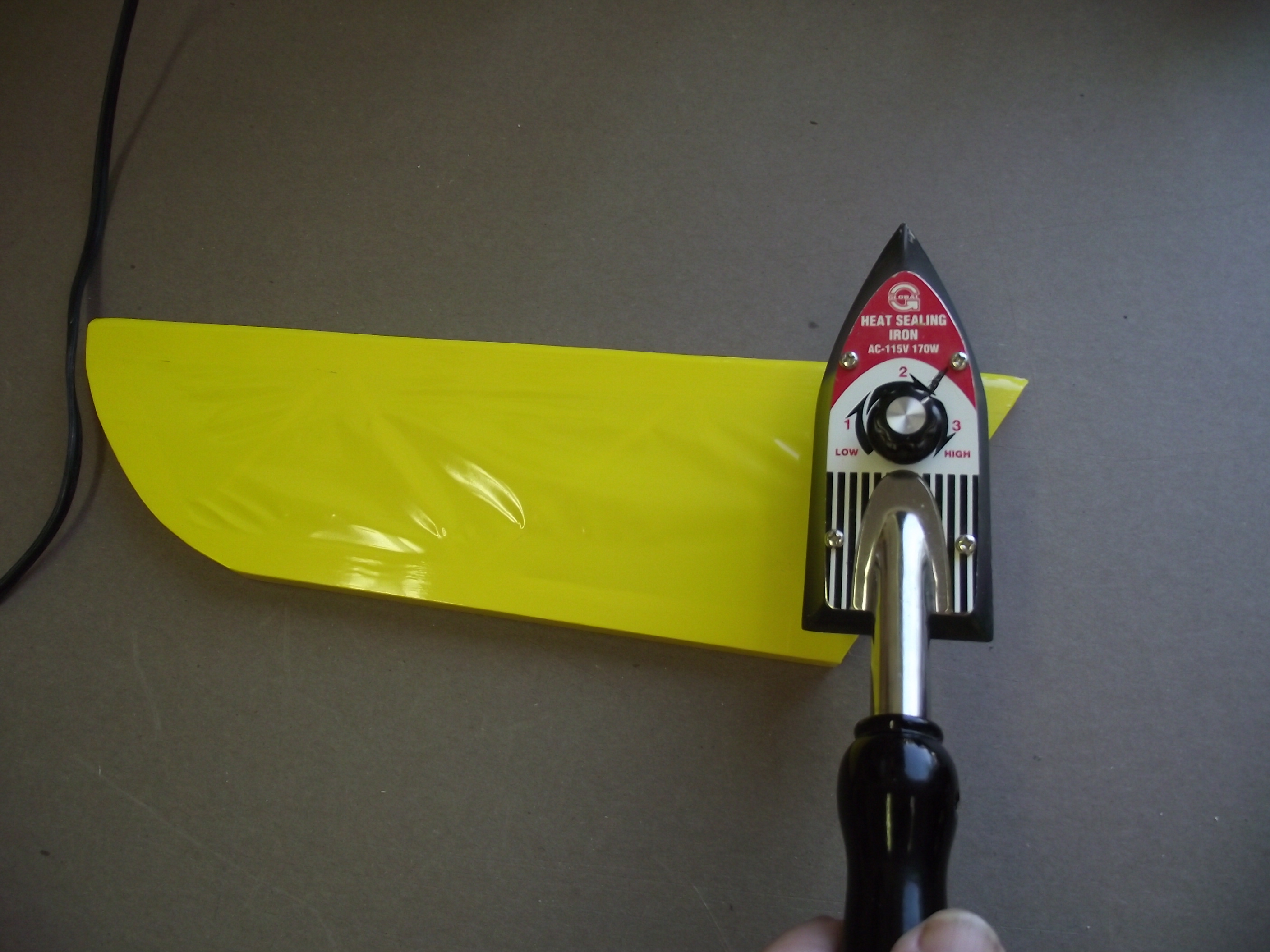

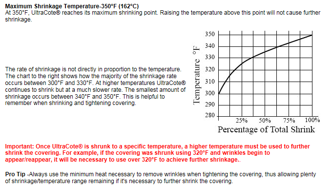

I have to say thank you for all your suggestions, but I've tried working the MonoKote almost going through an entire roll. A tip with this many compound curves is very difficult, and while talking about tacking ,and shrinking the covering when it adheres sounds plausible I simply am left with to much covering at the leading edge. If I try not to shrink the covering, and simply attach it then the amount of excess becomes even larger. MonoKote only has an available shrink of about 10%, so I'm not saying it can't be used on these tips, but with an investment of how much "trial, and error time"?
I'm about to buy some Ultra Coat, and give it a shot. I have researched their site, and they offer some outstanding instructions for download on Oracovers website. They really explain in great detail about using the two temperatures one to adhere, and one to shrink. They also explain that the covering when shrinking at 300 degrees does so in percentages easily exceeding MonoKote.
I know it's been a long time debate as which covering you prefer, but that's a very hard detail to overlook considering how much time it saves, and error correction is as simple as heating an lifting the covering without fear of the color being left on the model.
Check out the chart I attached with Ultra Coats details on its ability to shrink. MonoKote simply doesn't offer that. You must apply MonoKote virtually wrinkle free from the start, or you risk locking them in place.

I've done a repair like this before. It can be done in one piece of covering. The trick is to use your heat gun for application and stretch the covering at the same time you are shrinking it. Iron the covering down without shrinking it on the flat part of the wing, stopping where the curve at the leading edge starts to tighten. Then you can pull on the covering at the front to stretch it as you use the heat gun to activate the adhesive. That will pull most of the wrinkles out of that annoying section between the spar and leading edge on the wingtip. Then use the same pulling technique to adhere the covering to the edge of the wingtip by wrapping the covering around and pulling from the bottom while heating the top. You'll need to aim the heat away from the first seam you made, so you'll need a glove to protect your hand. Once it's stuck all the way around, you can keep using the heat gun to wrap the covering around the radius of the wingtip. The last step, if needed, is to use the iron at shrinking temperature to shrink out any looseness that remains over the open structure.
I'm trying to envision what your describing in my mind. I have stretched MonoKote to apply it multiple times, and one thing I know for certain is that when you stretch it you distort it. If I stretch the covering towards the leading edge while its tacked to the flat area of the wing the seam from the new piece of covering will distort, and no longer be straight. It's like stretching pin striping you can stretch it, but the stress on the material makes its line uneven. Maybe you could do it as I'm certainly no expert, but I believe the real issue here is the amount of shrink I have to work with. The leading edge taper is tight with a radius bend as well. I thought even pulling the covering diagonally towards the leading edge while being heated would work, but I simply can't produce the amount of shrink required to tighten the covering, while pulling, and trying to keep the covering from attaching itself to the wing to soon.
Honestly it should never be this difficult. It could very well be my technique, but judging from all the hundreds of posts on how difficult this covering is to work with I might as well try Ultra Coat. I've spent at least 6 hours trying to accomplish two wingtips, and could have literally built a new wing in that amount of time. I think MonoKote is fine for flat surfaces, and typical wingtips where the compound curve isn't quite as extreme. I had no problems applying it to other surfaces, it's simply not modeler friendly in this case.
A roll of covering for $16 is well worth my time, and effort to see if it's a matter of skill, or product.

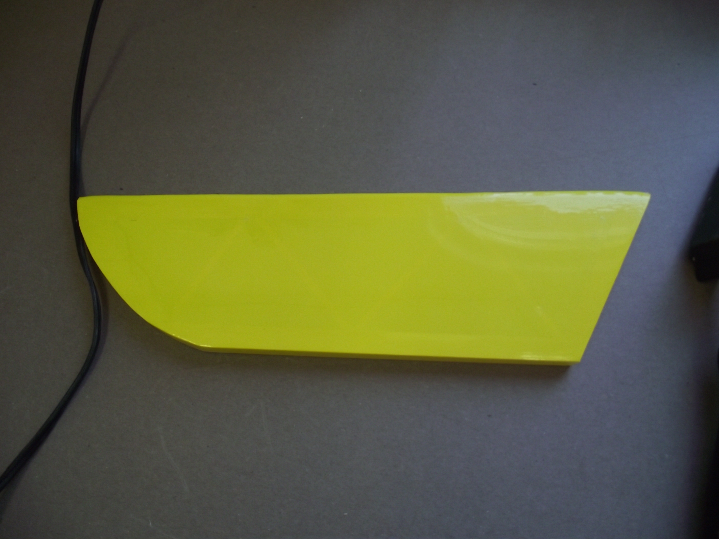

Gray, I'm sorry for not posting sooner, but I got my problems ironed out..
as the picture reflects. I was using just a touch to much heat. I dropped the temp by 10 degrees as I tend to hold the covering to long while heating( learned from using monokote.) This film is so much easier to work with. When heated it becomes very pliable where MonoKote you typically have to work the wrinkles out with so much pulling resistance. Some wrinkles on the flat surface came out that I can't believe did. MonoKote with the same wrinkles, and you better start over cause there done.
Anyone reading this thread read all the suggestions about adding blocks of wood to the tip. I didn't do this. The only change I made was from MonoKote to Ultracoat, and the problem was solved. I can't imagine if covering a compound tip like this can be done how fast applying it to typical structures would be.
Overall money very well spent, and you wrote something very true. The finish on the model should be fun. I enjoyed working with the film, and taught myself a couple new techniques at least there new for me. I found tilting the iron on about 45 degrees, and using the edge to apply downward pressure on the film very effective for attaching, and getting the last of the wrinkles out.
This made me realize MonoKote should really only be used for trim, and that's what I plan on using it for.
The other huge plus when working with this covering is removal. If you need to reposition it simply apply heat, and gently lift. You simply can't do that with MonoKote without the losing its color layer. Trying to remove MonoKote is usually more time consuming then building a new part, and covering it literally.

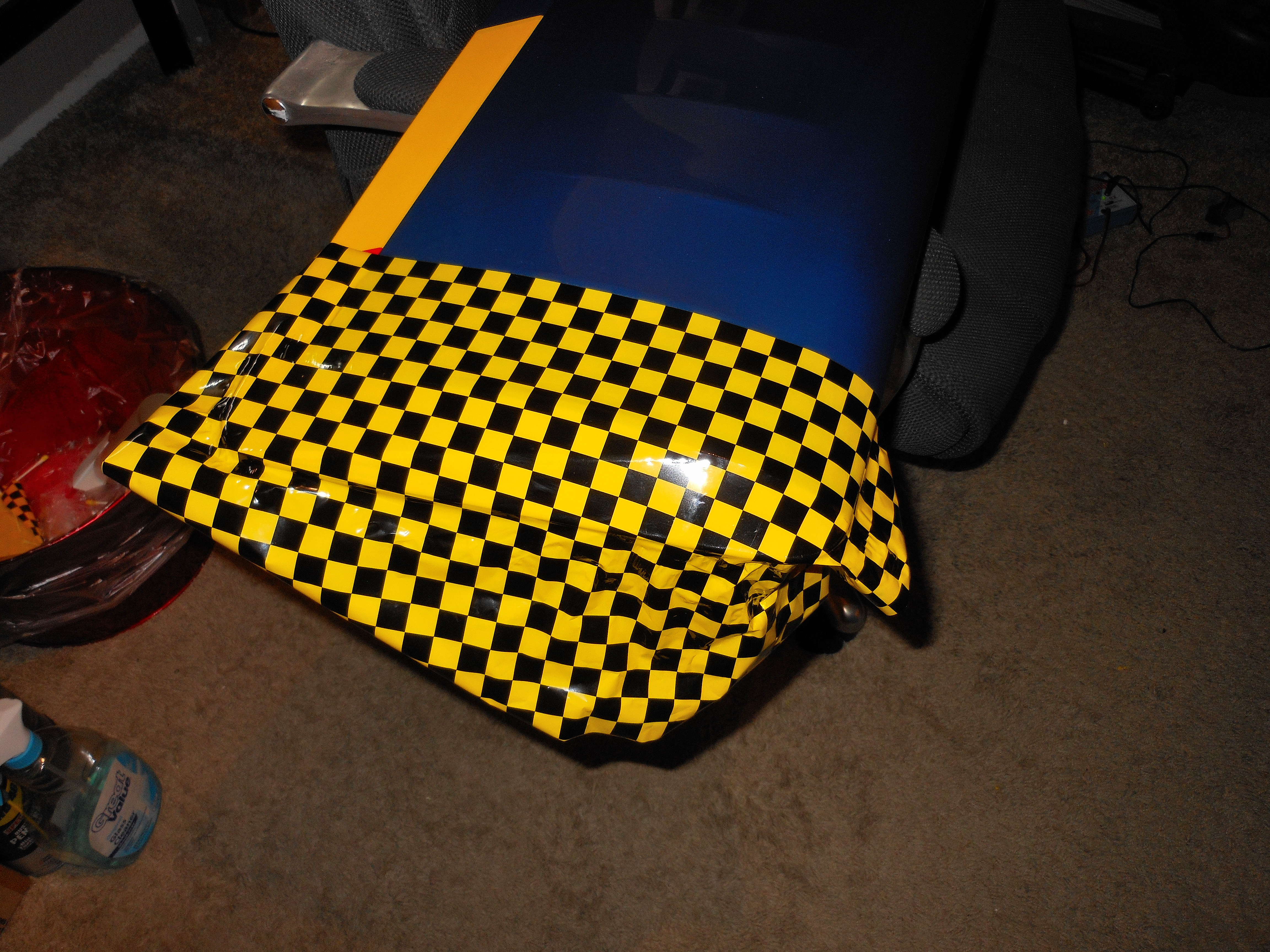

Glad to see the OP got a solution. Just thought I'd throw in my $0.02 for anyone else facing this issue and not wanting to switch coverings for whatever reason.
Monokote can ABSOLUTELY make this curve. I had a nearly identical wingtip on an old Stik design a couple years ago. What I finally figured out with Monokote is that I have to work in very tiny areas at a time for shapes like this, and I must pull the covering quite hard as I work the iron, while simultaneously tacking down the edge AND shrinking the area at and near the edge to make it conform to the edge's shape. I end up with some minor wrinkles in the middle of the covering, but these area easily ironed out. Bottom line: as long as there are no wrinkles on the edges (that is, the areas you can't fix later because they are bonded in-placed to the airframe), the rest will iron out.
Monokote is very "shape-able"...think less about shrinking the covering and more about shaping it. On something like that wingtip, for instance, I will start by tacking down at a point that represents (roughly) the geometric center of the curve. In this case, that would probably be right at the front corner of the wingtip. I then start working the hardest parts (so, working forward), but I don't actually lay the covering completely flat before ironing: I deliberately put some wrinkles in the covering to take up the slack and prevent having a huge pile of extra covering by the time I am finishing the curve. The key is that the amount of excess covering I absorb as I go is not more than what I can smooth out with careful iron-work. This is achieved with gentle pressure as I pull the covering against the airframe, followed by firm iron pressure to tack it down...if you press the slightly-wrinkled covering hard into the airframe right away, you will get a bunch of permanent wrinkles. I am not working against the airframe at first, I am working against the pressure I am holding on the covering with my other hand. This forces the Monokote into a new shape before it is fully tacked down. By the time I get to the end of the job, all that excess covering that the OP was having trouble with initially, is now down to about the same manageable amount I've been absorbing all along.
I used a similar method on a Cub tail, but I would say it was actually harder due to the smaller working area, tighter curve, and concave shape of the final covering. I posted some pics in this thread:
