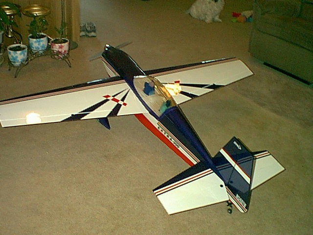

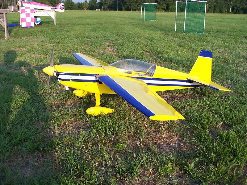

Finally got some flight time. OS 91FX , APC 16X6, 17 oz graupner tank, around 10lbs. Needed to increase elevator throw on low rate to flair for landing. With alum gear forward a bit no problem on grass. Blocked one exhaust outlet on Bison. Engine runs great but won't shut off unless I block intake. Smoothest flying plane I have ever owned.

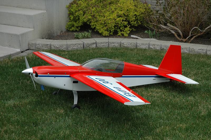

I posted earlier on this thread but never added any pics of my plane. These are a little fuzzy but you can get the idea.
I use a 91FX with a bisson muffler glass cowl and gear. 2 elevator BB servos plus 2 BB 77 oz aileron servos a pull pull on the rudder Hi torque 635 HT.
The plane weighs in at 9.5 lbs and flies like its on rails. I did go to a larger tank 14 oz I think can't remember now. The 91 FX sips fuel. I have a 120 YS I considered putting in it, But i'm not going to cut the cowl up to do so, when the 91 is plenty for most of what I do. I did make a larger rudder when I built it, But I don't fly it 3-D I have other planes for that, so why mess with perfection.
IMO its one of the best all around planes ever designed.
If you look close you can see the QA inspector eyeballing things over up in the corner of the one pic *S*

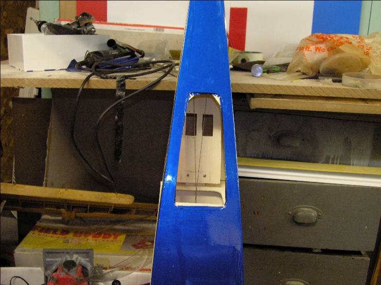

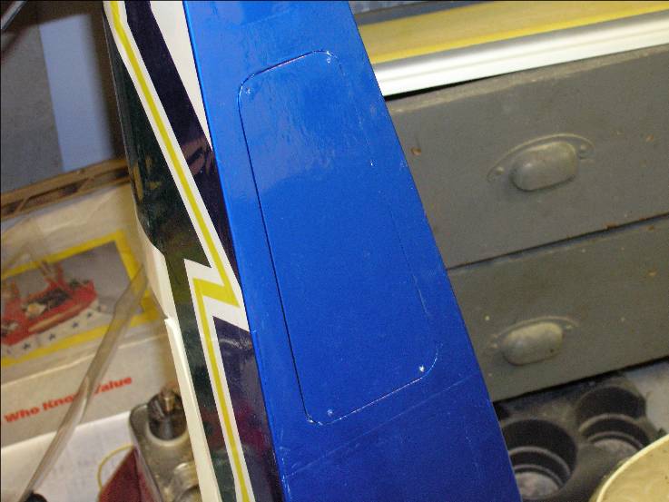

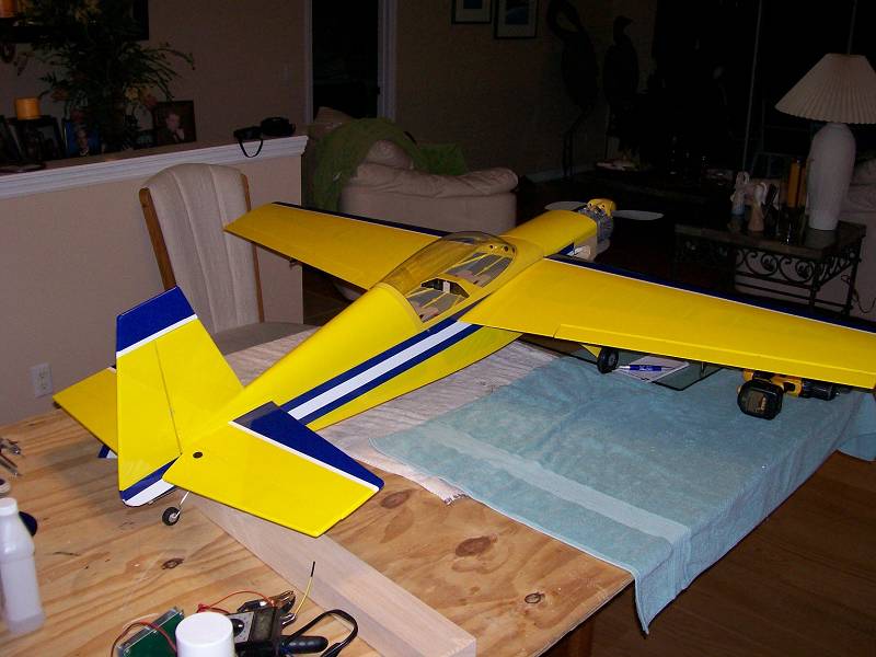

I have finished most of my CG Extra build. I am still waiting on the Fiberglass Specialties Cowl and wheel pants.
I really like this plane. It is my second build and hopefully will last me longer than my last. I tend to crash with less air time than I have time building.
I think that the build went very well with the exception of the landing gear mounting. I new from the start that I wouldn't use the stock wire gear. When everyone on here talked about the plane nosing over on the runway I decided to tilt the geat forward. I think that I went too far. I think they are ugly. Maybe the wheel pants will hide most of it. I am worried that at that angle they will be aero dynamic the wrong way.
I got a couple of runs on the engine yesterday and it ran very good but I did see alot of air in the fuel line. I first thought it was foam but when I tried to empty the tank it wouldn't pull anything but air and foam. I must have a air leak in the pick up tube above the fuel level.
I hope to maiden this saturday so I too pictures first.
Mark
Mark

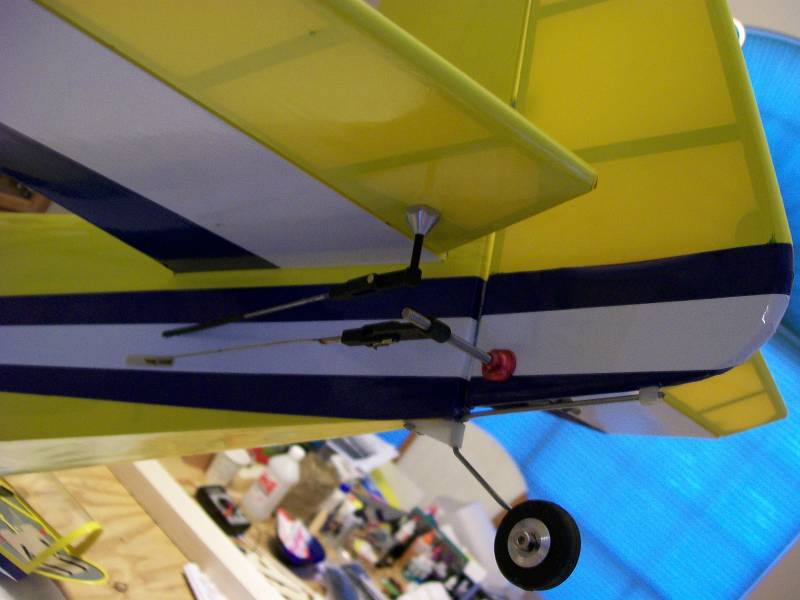

#148
Thanks, I just would have prefered to move the mounting forward rather than slant it forward but then you have cowl clearance problems. I think I am a good bit ahead of the leading edge. I had heard that one before. I may end up angling it back a little at some point.
What is everyone using for a rudder pull-pull servo. This is my first p-p setup. Seems like there will be a lot of tension and wear on this servo. I am using a JR 821, which is digital and BB but I am wondering if two bearings and metal gear would be best. I don't want to overkill but don't want problems.
I have upgraded all of my linkages and horns. I am putting a long arm and ball ends on the rudder servo tonight.
Mark
Mark

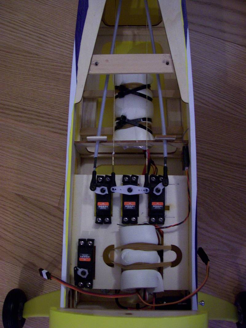

#149
This control linkage stuff is so neat that I probably got carried away.
I used Dubro Heavy duty control Horns and arms on all surfaces, ball links at the servo ends, dual servos w/ Sullivan Gold-n-rod pushrods for the elevators, Sullivan Push cable for the throttle and Dubro Heavy duty Clevises all around.
This thig is ready to maiden but the wind has been 25 to 30 knots every day this week in Florida. Maybe this weekend I can get out before the wind picks up.
Mark
Mark

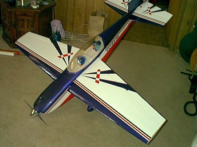

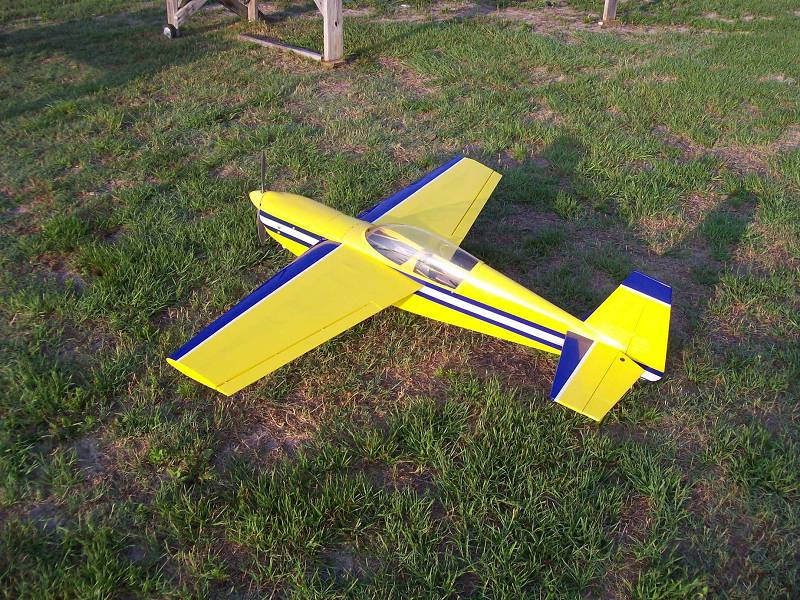

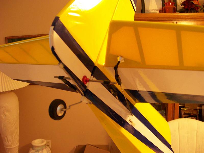

I just about have the plane the way I like it. I can pick it apart and find things to fix but in general it came out very nice.
If I were to pick, I would repaint the cowl and pants as I did it when it was raining and they turned out less than glossy.
I found that my motor offset was way off, I used washers and did not measure. I just lined it up to the cowl and I found that Goldberg had put the cross hairs wrong on the firewall by 3/16" so lining up the cowl gave me 8 degrees insead of the 2 degrees recommended. I have remounted the engine and it loops much better now.
I have included the most recent pictures and here is a list of parts.
CG Extra 300 kit
OS 1.20 AX
16x8 APC prop
Fiberglass specialties Cowl & Wheel pants
12 OZ dubro fuel tank
fuel dot for third fueling line
1/5 scale pilot (not installed yet)
Gold-n-rod pushrods
Dubro heavy duty control horns & ball links
Dubro fiberglass landing gear
Spektrum AR7000 receiver
JR DS821 Digital servos all around
Dual elevator servos next to pull-pull servo
Li-po battery
Angles LG forward to prevent tip-overs
AUW 10# 1oz.
