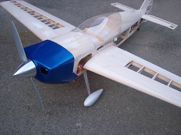

Old 01-28-2006 | 08:01 PM
  #163
whaturi's Avatar
Joined: Nov 2005
Posts: 747
From: harrisburg, PA
Default RE: GP .46 Giles---Misc Stuff
well i got tired of the white and green real quick. so here it is.

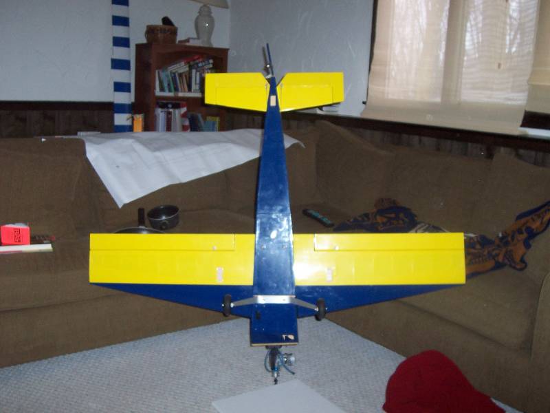

Old 01-30-2006 | 09:38 AM
  #168
My Feedback: (10)
Joined: Aug 2002
Posts: 373
From: Worthington, IN
I am in the process of covering. After that it will be ready to go after the engine break-in.
