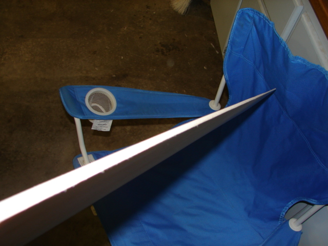

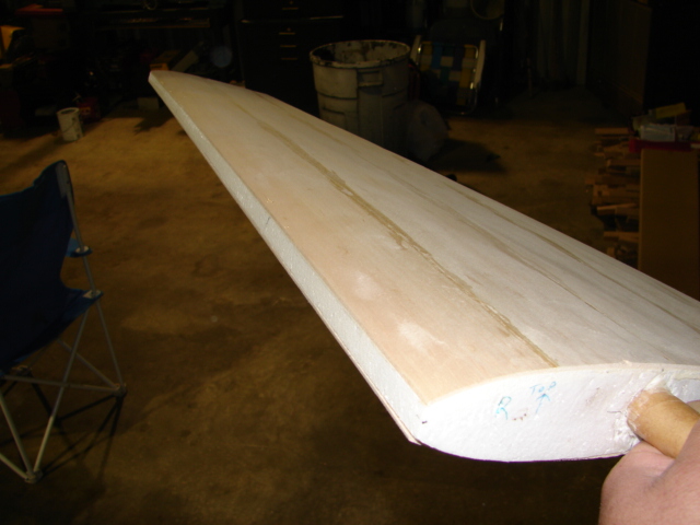

Pic 1 shows the wing laying on the balsa sheetingI am getting ready to cut the sheeting to size and I am allowing 1/4 inch overhang on all sides.
Pic 2 shows the cut sheeting and notice how I labeled everything? These wings look the same top and bottom but there is a true top and bottom. I thing its a good idea to lay some cling wrap down to protect the shucks and to keep the wing from sticking to them.
Pic 3 & 4 shows the sheetingand some more labeling

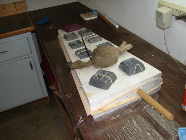

Pic 5 shows the wing fully guled and sheeted on both sides and placed in the shucks with 30 lbs of weight to sandwitch everything in place. Now lets talk about how I got to this step.
After I cut the sheeting to the size of the wing with a little overhang >NOTE< ( On the first wing I allowed 1/4 inch overhang all around I found this to be the minimum overhang.On the next wing I allowed 1/2 inch. This is better) I used Gorilla glue and with a plastic card I spread it real thin all over the sheeting. Then rubbed a wet towel over the wing itself. placed the bottom sheeting in the shucks then placed the wing on top. I spread glue on the orher wing sheeting and dampened the top part of the wing. Place the sheeting on the wing and make sure you have the correct amount of overhang. Place the top shuck down over the wing and add the weight to hold everything in place.
When you fool with Gorilla glue the stuff expands a bunch so you need to allow for this.I had 30lbs of weight to hold a 34 inch wing down and this stuff was powerful enough to move the wing off the sheeting. You have to keep an eye on it and reposition the sheeting on the wing. This glue does not take long to set up to where it will stop expanding. 30-45 min depending on weather. Here in Tennessee its real humid so this glue expands alot. Keep an eye on it!!!!!

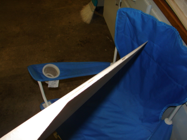

Pic 6 shows the glue at work!!!
Pic 7 shows the fully sheeted wing.

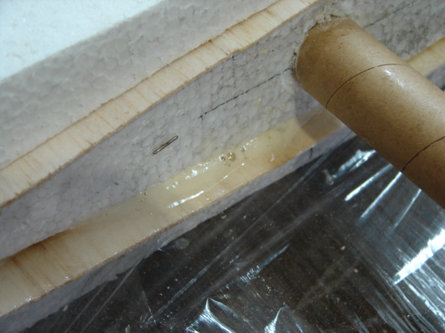

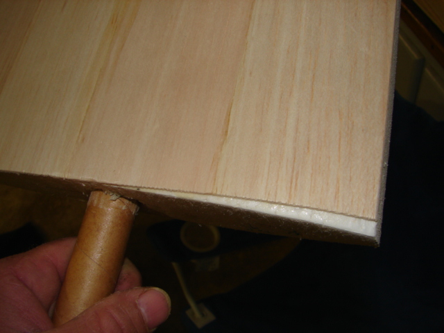

As you can see in the pics is the results of gorilla glue. I guess if I were to do it again I would use a lite coat of epoxy to sheet the wings . look in pic 3 and you will see what I mean keep and eagel eye on it until it sets up . the foaming action of gorilla glue will move the parts around as it foams. I had 30 lbs od lead weight and it still moved and I missed it. NowI have to scab a piece of balsa to cove this area. One thing though if you let the sheeting hang out 1/2 inch you can omit the 1/4 " trailing edge piece. As in pic 4 & 6.
Pic 5 showes the leading edge fully sanded and installed with titebond glue. I am having to think hard about how to drill stright holes in the fusealage to accept the aluminum spar and fit the wings to the fusealage.

Irglnman, IMHO, the sheeting that shifted was probably not the fault of the GG, chances are it moved when you put the weight on top. (Ask me how I know:-) If you are only using 30# of weight to put pressure on the skins to the core I feel that you would be very dissappointed in the result if you used epoxy. When I used weight to skin wings 100lbs+ is what I used. This sounds like alot but now I use vacuum and that is easier to control and is a more pressure that is evenly distrbuted over the surface of the wing. Once you try vacuum you won't want to go back to weights. (That is till you get a bag with a leak) That's why I still keep the weights around as a back-up.
Also I will use masking tape to hold the skins in place before I draw a vacuum or put the weights on.

If you are sheeting with weight you need to use minimum 300-400lbs to get a decent bond, especially with polyurethane glues. I know this sounds like a lot, but pulling even just 5" of vacuum (just under 2.5psi) will put well over 1000lbs of force on one wing panel of the size you are working with. Without crushing the foam or causing any other issues. The only issue with this much weight is that your table has to be strong enough to carry the weight without sagging. Better options than weight are vacuum (as mentioned) or using a press to apply even force.

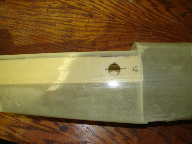

Well, I got around to building a bit more this evening. Lets see my progress.

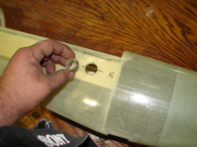

On this peticular kit the wing tub holes are made into the fusealage. all I needed to do was drill a pilot hole with my center hole locater . Then I cut a small piece of my wing tubing to use as a marker. I then drilled holes in both sides up to a 1/2" drill bit. Then I used the Drimmel tool and a sanding drum to finnish the holes. I ended up with a very snug and perfict fit. Also on the inside of fuse, where the tube slides in I doubled up with some hard ply to help hold the tube steady. In the last pic showes a nice fitting wing tube!!!
And to think this did not take long at all.

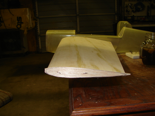

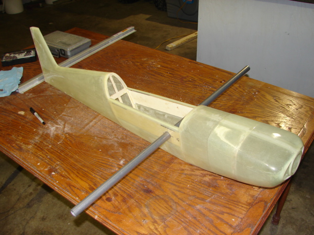

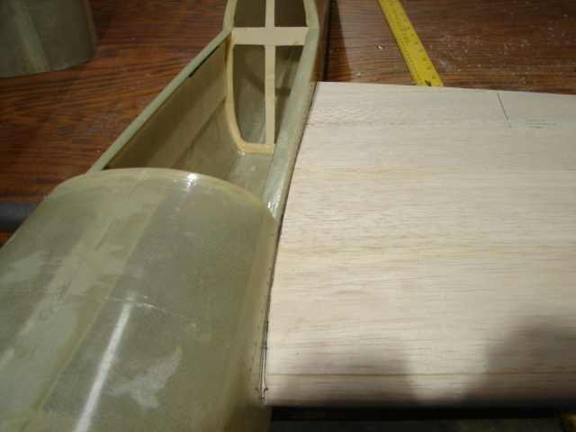

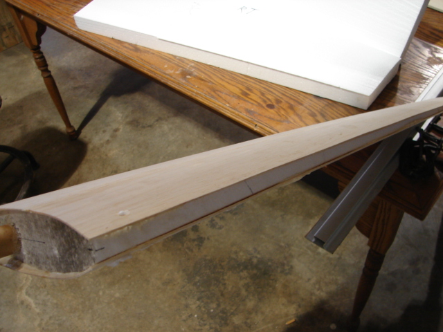

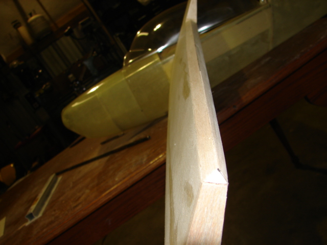

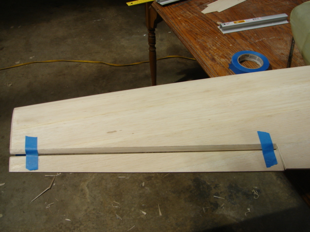

Pic 1 showes the wings installed, sanded to fit the fusealage and the wing tube cut to length.

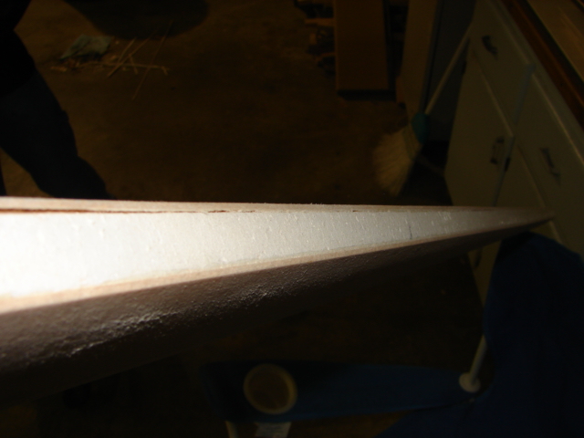

Pic 2 showes the aileron cut out and test fitted .
Pic3 showes another view of the wing cut with the aileron.

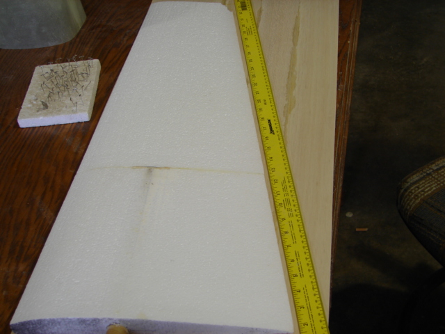

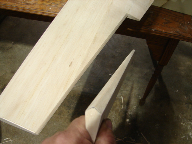

Pic 4 After the aileron is cut from the wing I glued a piece of balsa to the aileron and sanded it to a point the length of the aileron.

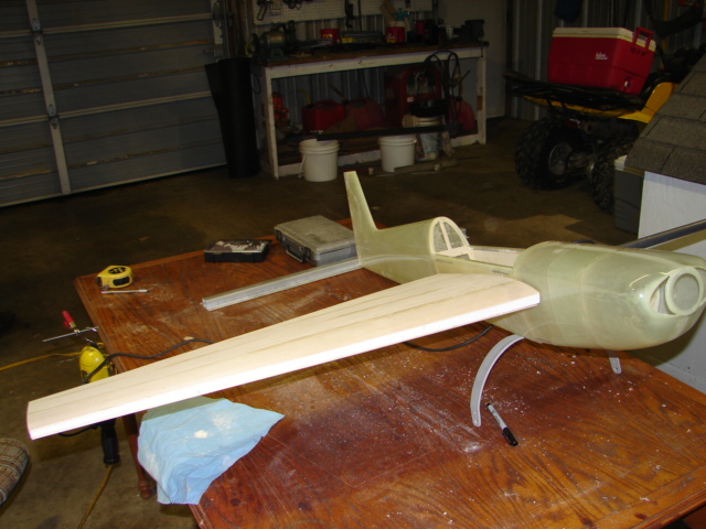

Pic 5 showes the wing with balsa glued and sanded to a point as well. this will give me increadiable throw on all serfaces. It will be there if I need it or not. The plans did not call for this but I thought it would be a good idea.
About all I like on this wing is the root cap and hard points on the aileron and cutting out the servo pocket and hole for the servo wire. which I wiil do in the next few nites.
