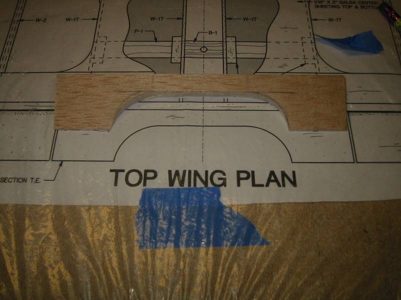

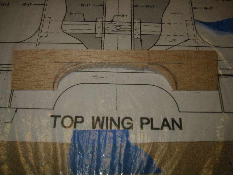

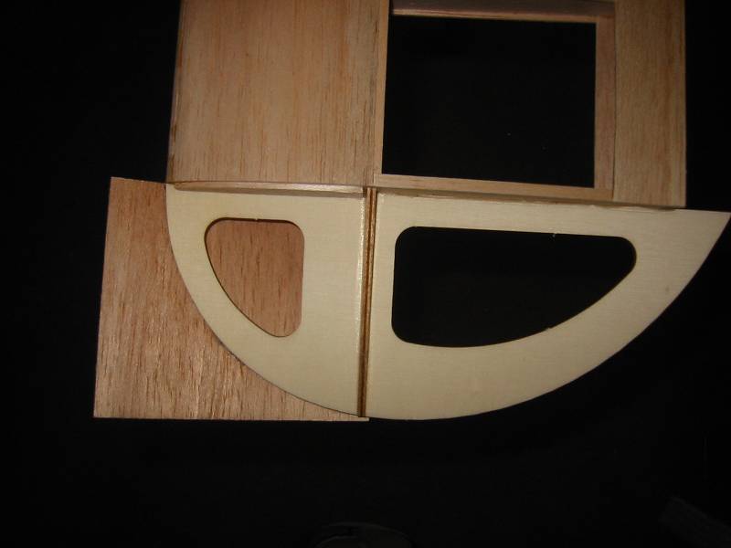

Well I'm back! Got to be honest, not much progress over the shortened weekend. I had a ton of "to-do's" pile up while I was away - what's new, right . When I last left this thread, I had just finished the center sheeting on the top and bottom wings. One thing to note (its not that clear in the instructions) - do not sheet the entire bottom wing center like you do the top. Picture1 shows what I mean. I looked at the plans and actually had to scan ahead in the instruction manual to make sure. I guess its somewhat common sense - BUT ...
From there, I attached the rear balsa stick trailing edge. Nothing too difficult - a bit of painters tape and wood glue and time.
After the glue cured, I used a razor plane to carve down the trailing edge to match the slope of the ribs. This tool is awesome. I hadn't been a believer - now I am. I had always heard people say how great these are and never gave it much thought. I picked up one of these over the holidays and boy am I glad. If you've never tried one, you're in for a treat.
BTW, are the blades "special ordered" or can I get them in a hardware store? It looks to take blades larger than a regular razor blade...
So the razor plane made quick work out of the trailing edge. I then removed the excess wood on either side of the wing and then sanded the whole wing down. Not a finish sand, mind you, but an initial sand to get things evened out.
Next up - attaching the wing tips.
Picture1 - Sheeting underside of the top wing
Picture2 - Trailing edge glued on and curing
Picture3 - Wing just prior to sanding and removal of "overhang" on the ends...

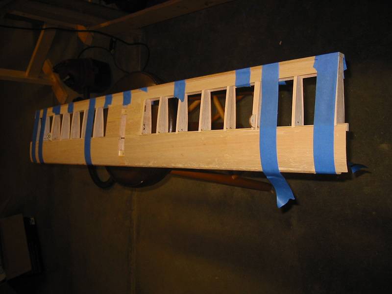

The next step of attaching the wing tips has a mild "pain in the backside" factor. Its really not that hard, its just a small area that has to be sheeted that happens to also have a bit of a curve to it. I started by cutting a piece of the sheeting roughly to size and then wetted it - I had a bottle of windex handy and I sprayed the sheeting with that. I worked it into the wood and coaxed it into the proper shape. Once satisfied with the fit, I CA'd it down onto the wingtip. This is one of those areas that I think CA really has an advantage over wood glues. This is a tough area to clamp, so the instant bonding qualities of the CA makes this much easier. As you can see from Picture1 and Picture2, the sheeting has been applied and is waiting to dry (remember its wet from the windex).
Once the sheeting dried, I took out my handy dandy Dremel. This is a great tool, by the way. I slapped on a cutting disk (remember to wear proper eye protection ) and made quick work of the "overhang" (picture4). I then replaced the cutoff wheel with a sanding drum and sanded the sheeting flush with the wingtip. 5 minutes of work tops ... Of course, I still have the final sanding to do, but it's much easier this way.
While the sheeting was drying, I attached the rear Wingtip Blocks (WTB) and clamped them down.
I looked ahead in the manual to see what I could do while all these pieces cured/dried. The next step was to sand/radius the trailing edge stock in the center of the wing. I started by marking the piece based on the plans (Picture5). Next I turned to my scroll saw to rough cut the piece (picture6). Once the piece was rough cut, I turned to my Dremel again and using the sanding drum I finished the shape (picture7). Again, using these tools greatly reduced my frustration levels - had I needed to do this by hand, it would have taken much much longer - and likely would have been to a lesser quality standard.
The top wing is now almost done. All that's left is to attach the trailing edge, shape the ailerons, and shape the wingtips...
Picture1&2 - Sheeting applied and air drying.
Picture3 - Dremel tool
Picture4 - Wingtip after rough cutting with cutoff wheel
Picture5 - Trailing edge stock - rough marked
Picture6 - Trailing edge stock - rough cut
Picture7 - Trailing edge stock - sanded to shape

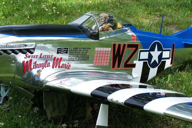

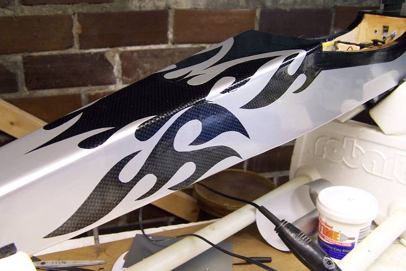

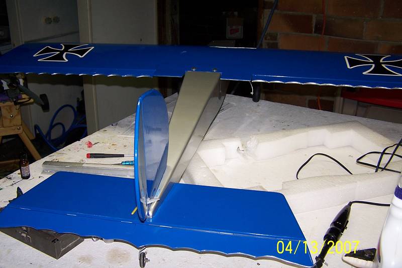

I just love this plane I have built two of these Sig kits (red & white) , (blue & yellow) but wanted a bigger one for gas operation and low cost flying. So with my computer and cad software we came up with plans for one 16% larger than the original Sig kit. The Plans are for the most part just an enlargement of this popular Sig kit just bigger with a high lift performance Compufoil airfoil. They flew so well with the Ryobi 25cc with smoke I built three of them and enjoy them all very much.

I'm 42 years old and been building and covering planes since I was 14 years old. In short the same method used to achieve a stellar performance at Carnegie Hall works here too. Practice, practice, practice! Been thinking of doing a detailed thread on complex multi color overlays and graphical covering designs, much like you see above. Is there any interest in such a tutorial?

If you like covering jobs have a gander at my Mustang this one is all Ultracote Crome with blue, black and white. I just love covering its the best part of the build to me it's what makes the plane. I thought my scratch built Ugly stick needed some tribal work on the fuse it looked a bit plain how does it look now?

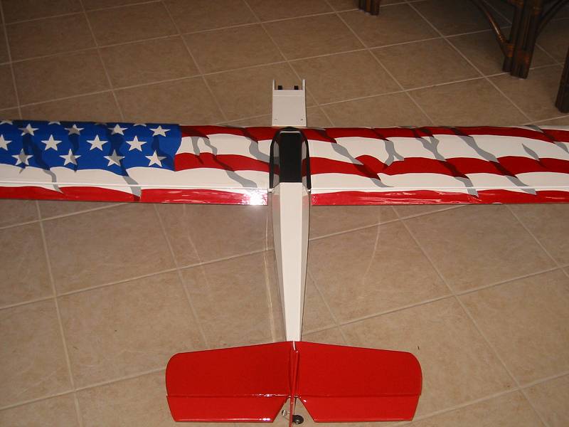

Please do Stickbuilder!! I covered my Mid-Star in an American Flag pattern over the summer - I'd love to see your techniques.
