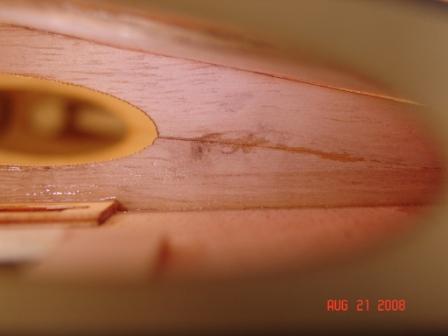

Well to begin with I ordered this plane through Quest Hobbies in NJ. I would caution you against buying from them. They gladly took my money from paypal (imagine that), recieved an email with contact info. Well about 4 days went by and still didn't hear weather the plane was shipped or not. After numerous calls and emails with no response I finally decided to leave a message telling them If I did not hear from them by the end of the day I was going to file a dispute with paypal.[>:] Wouldn't you know it. I received an email a few hours later stating that they weren't sure why I was so mad. They had been trying to contact me and didn't know why I never recieved any email from them. Keep in mind they responded to my very first email I sent. What a load of crap. Anyways they also said the plane was shipped. Keep in mind this was August 14th when all this happened. Well 4 more buisness days passed and the plane showed up. Post marked August 14. Not very professional.
Now comes the crappy part. I have now started the assembly of the plane. Fuselage is pretty much finish with tail pieces in. Then I started working on the main wings. Holly crap. What a pile. I looked inside the wings, and on both wings I have numerous ribs that are broke and have been glued where the cracks are. Also have a few ribs that are missing pieces. Then I noticed pieces of balsa glued on the inside of the balsa sheeting. This is really a crappy ARF. If I did not need this plane for a team fun fly I would be shipping it back. But I will fly it for now and fix later. TMPro you guys really have built a crappy ARF. I would not recomend anyone buy this plane at all. I will post some pics later as I for got to bring them with me today.

well this last week I had to rip off the covering just to repair the ribs. Not sure what they use for wood or where they get it from. Definately some crappy balsa wood. Every single rib need to be patched and or strengthened. Also had to add carbon fiber for the wing anti rotation pins. Did not find any type of wood dowel or and other material like the manual said was included. Had to shave off about .175 off the end of the wing tube to allow the wings to be tight against the fuse. The screw they include to join the wings together is a joke. Well the big test will be tonight. After some much need improving and upgrading of the air frame I will finally fly it tonight.
