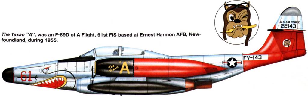

Alright, enough of the talking. Let’s see some pics. I am going to decide between one of those 3 color schemes below.

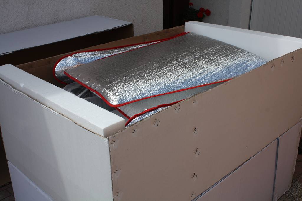

The model is delivered in a sturdy box with the dimensions of 65"x40"x24,5". All parts are well packed and covered. To my surprise the wings, tiptanks and elevators come with high-quality wingbags.You would really not believe that a model of that size fits in such a "tiny"box.

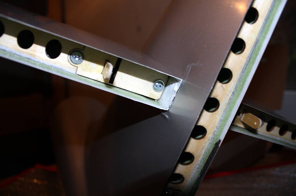

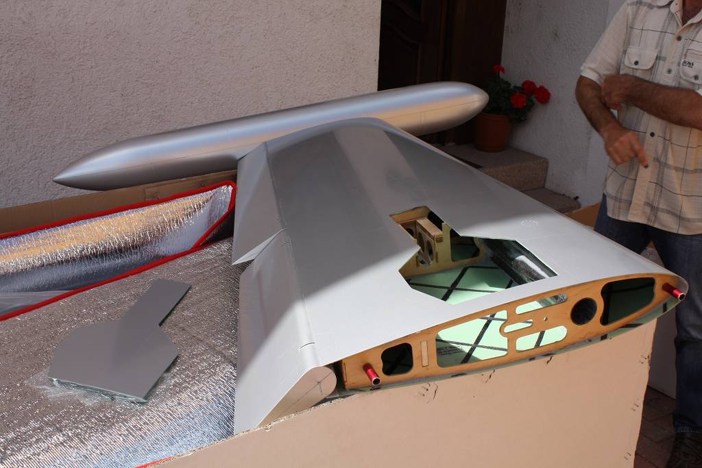

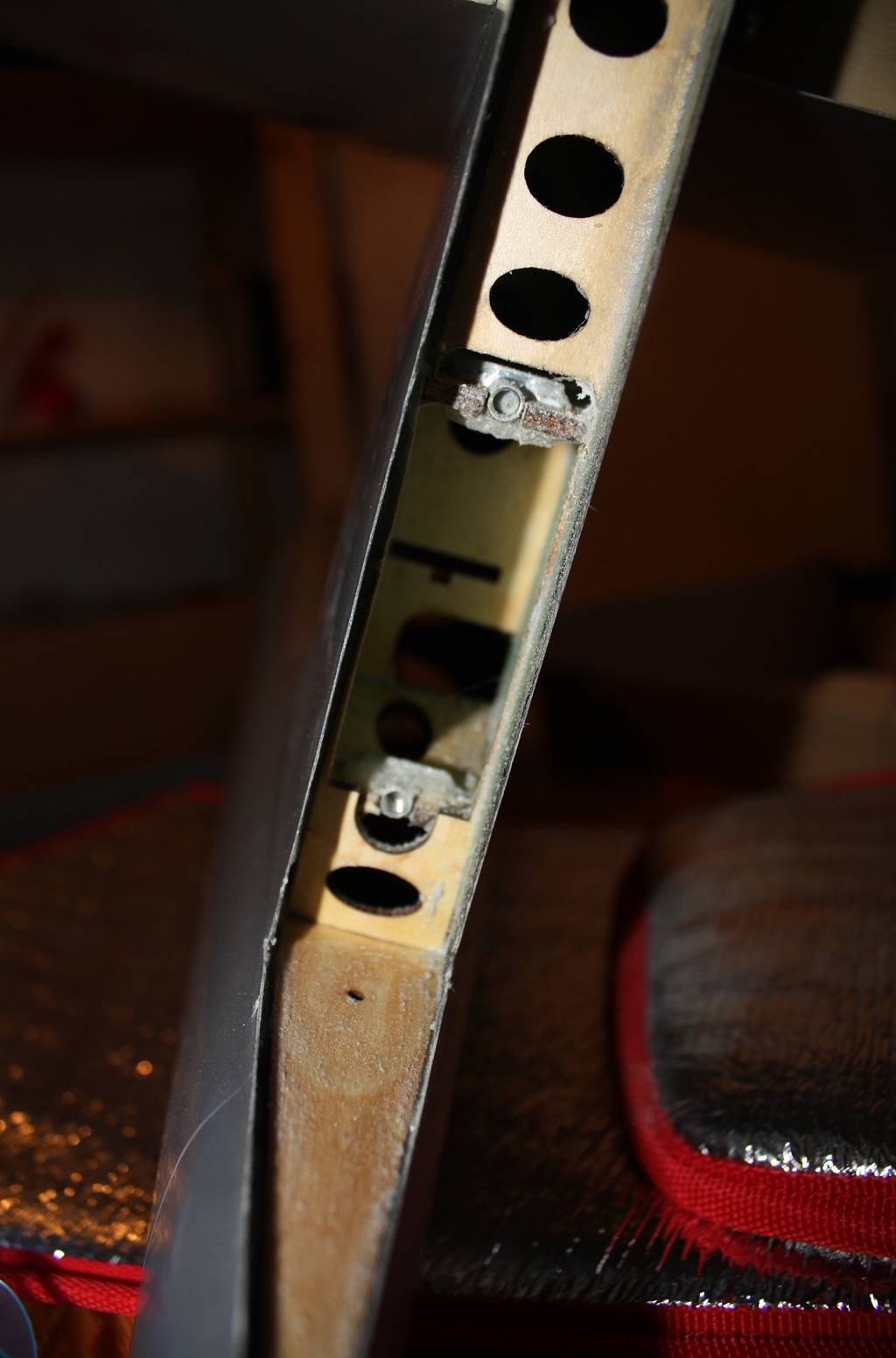

All flying surfaces are pre hinged via steel pins at the factory. The servo mounts for the flaps are already in place located inside the gear well for easy access and maintenance. Aileron Servo is mounted through the wing-tip. All you need is a long screwdriver and patience to measure correctly (or a good eye). The tip-tank mount fits perfectly. A little loctite on the screws, some alignment and you're all set.
The gear mount in the wing itself is solid. I don't like the job of hinging the gear doors, so I'll possibly start with that to have it off the list. I'll post details about the retract units later tonight.

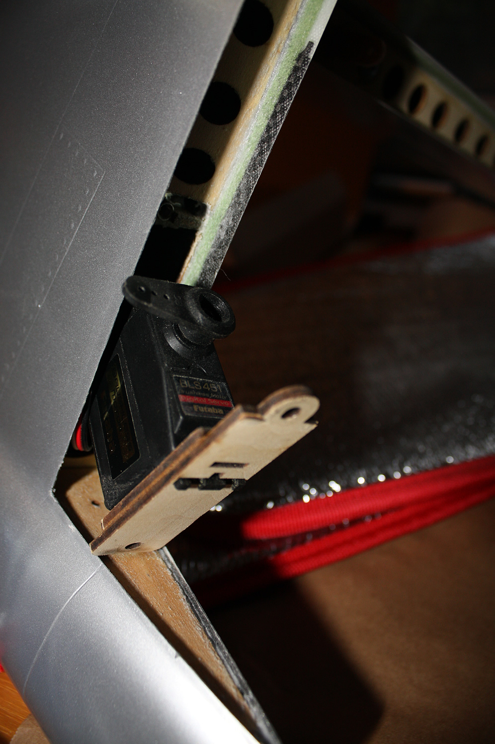

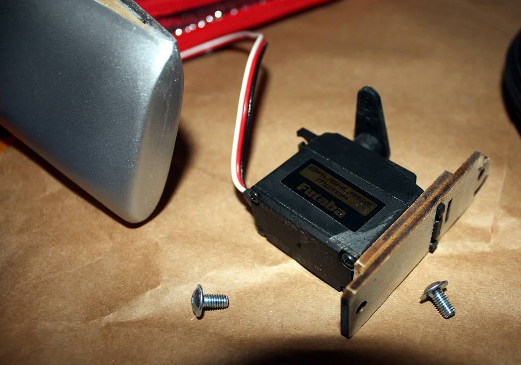

Alright. A few words on the servo mounts in the tail section. The whole servo installation will only take a couple of minutes I think. The servo slides into the laser cut plywood support plate and is then inserted into the rudder /elevators. I will use Futaba standard sized servos and there is absolutely no trimming necessary. The servo has a very tight, slop-free fit and the only work left to do is to cut out the slot for the servo arm. Pretty mean design, I think.

Here is another picture of the servo insterted into the mounting tray. What i really like is the tight fit because I initially had concerns that the servo would generate slop. Since the plate is pressing the servo tightly in place, this is unlikely to happen.

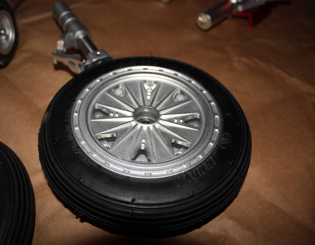

By the way, some close ups of the alloy wheels ...I think they match up with the full scale nicely. I hope I can start with the first build pics tomorrow or on Friday at the latest. Got to clean up my workshop and get some bits and pieces first. Wheels are 7 1/4 "diameter.
