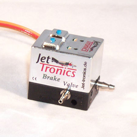

I'm having a blonde moment. I have 3 jettronic valves in my Scorpion. Singles on the brakes and gear, double on the air brake. None of them will work. I have tried resetting and I have tried setting the end points using the buttons on the device. I have reversed the channel in the radio, I have tried praying but nothing works. What the heck am I doing wrong? JR 12X by the way. All other servos working just fine.

What appears to be happaning is that the valve actuates and then leaks all the air out of the orifice at the bottom of the valve in between the two air lines (the blue ones). Even when there is pressure it will not cycle the gear, they do not move. I'm not sure what is causing this. Is it something basic or is the valve not functional?

What are you driving with this valve? it looks very much like a Zero loss brake valve. The JD (two way valve has four air connections and the M valve for Spring Air retracts or brakes is a half valve!

Just looked at your pic, Dave is correct, there should be 4 nipples on a dual action valve. 1x air supply, 2x cylinder connections and 1 vent. It appears the pic is of the low loss brake valve? What are you driving with it? If it's on your airbrakes or gear, it's a problem.(unless your gear is "spring down") It's only good for the wheel brakes. Mike

Indeed, you have a single action LOW LOSS brake valve shown, not a DUAL ACTION. Is this the unit tied to your air brake?
Dual action should look like this(total 4 nipples):

No no no no. You have a Zero loss brake valve. This is NOT the same as an M Valve which you can use as a brake valve or a SA retract valve. The M Valve is half the size.
Almost certainly nothing wrong with the retracts, SA system retracts have always been less hassle than two way air up down systems where there cannot be a leak. This is not a leaking problem, its a wrong valve problem.
What sort of valve do you have on the brakes? Same type or the single smaller, M Valve? If the same type you need a new valve. If you happen to have a single on brakes (not one that says Brake valve on the side like this one) you can swap.
The internals of the zero loss brake valve are completely different.

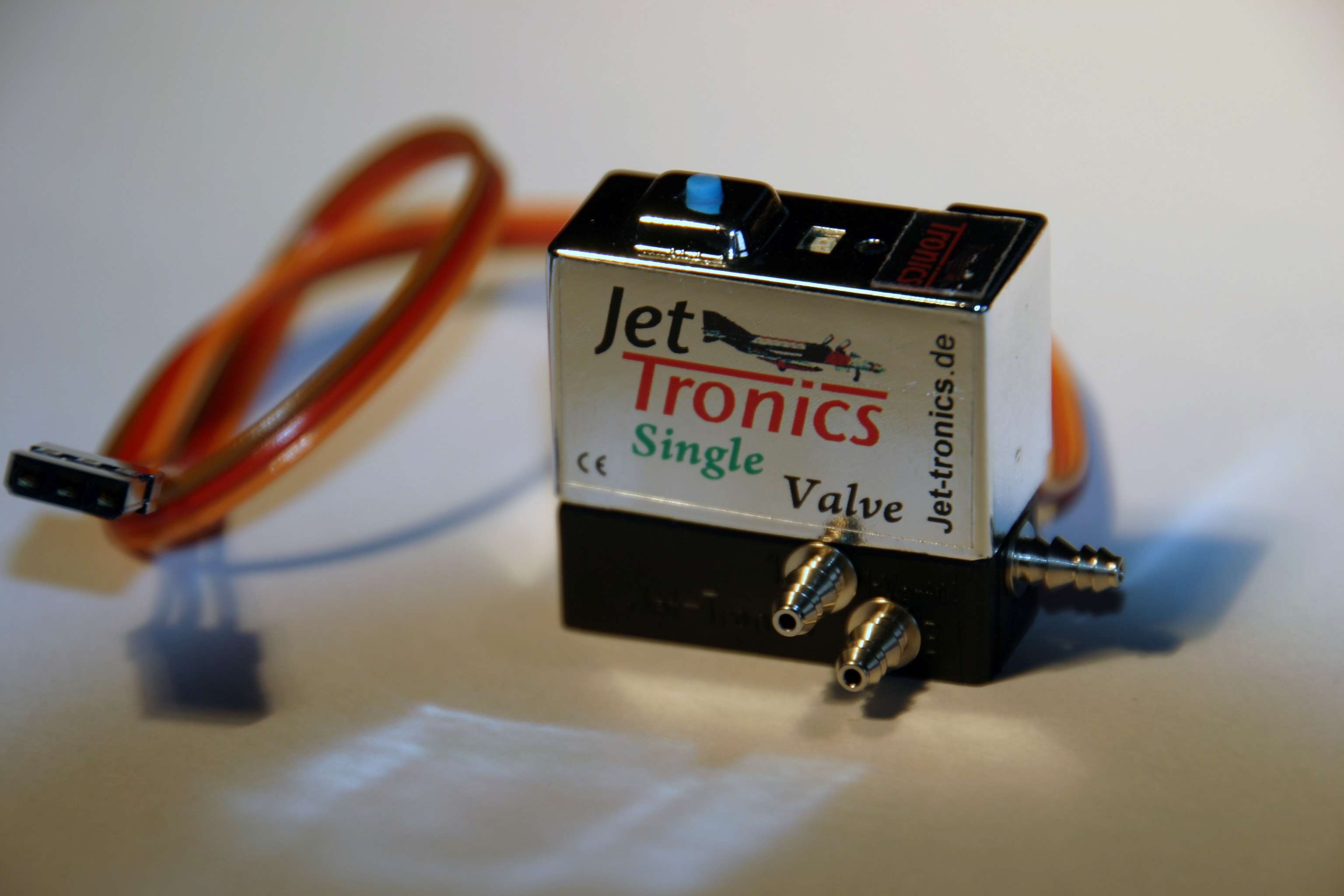

That being the case, the Jet-tronics single action valve that you need for your retracts should look like this…

Ok, that should solve the problem them. Wrong valve. I do have the same valve for a brake valve. I'll talk to the store that sold it to me and see if they will swap for the one I need. I'm still going to take a few things out and check but I'm sure thats the issue.

Turns out I had a kink in my line. I'm finding festo tubing is not as forgiving as the robart air line I'm used to.
The single "brake" valve if you will works very well for the application given the retracts are air up/spring down.
