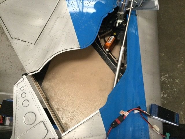

Servo arm position for the main gear doors needs to be like this, all the load is when the doors are closed, so the pushrod needs to pass over the servo arm screw. When the door is open in the airflow ( door sits almost vertical) there is almost no G or airflow load.
This is just a geometry check, I’m going to use metal arms.
Closed
Open

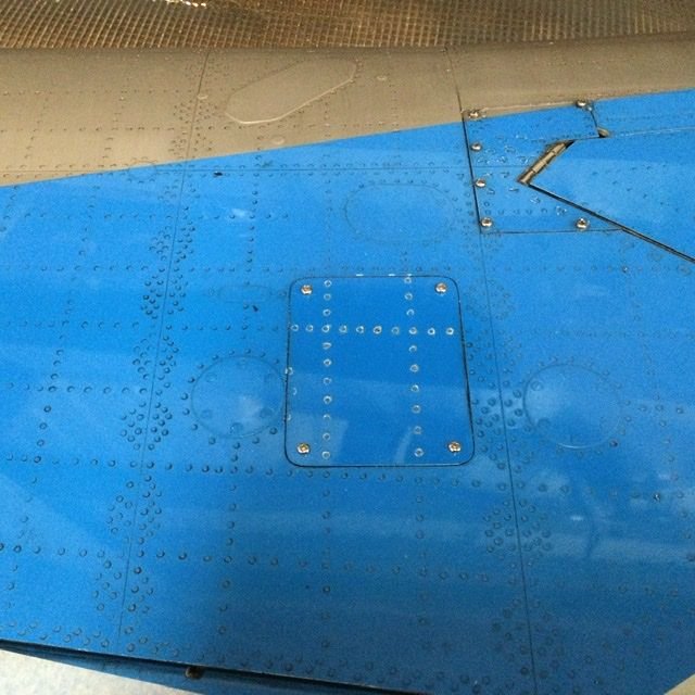

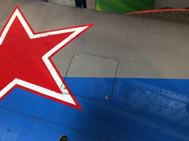

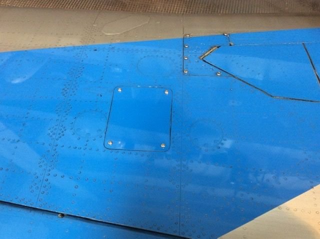

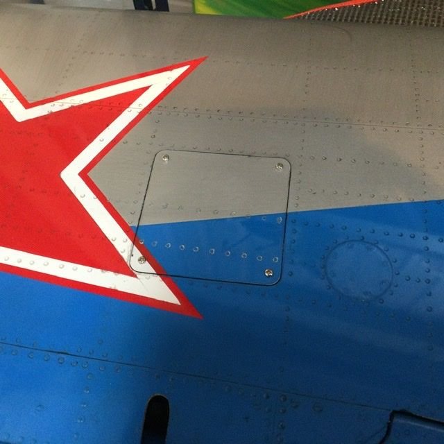

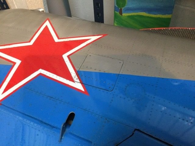

My early kit had carbon fibre hatches on the wings, so was missing detail. I’ve burnt in rivets and then oil painted.

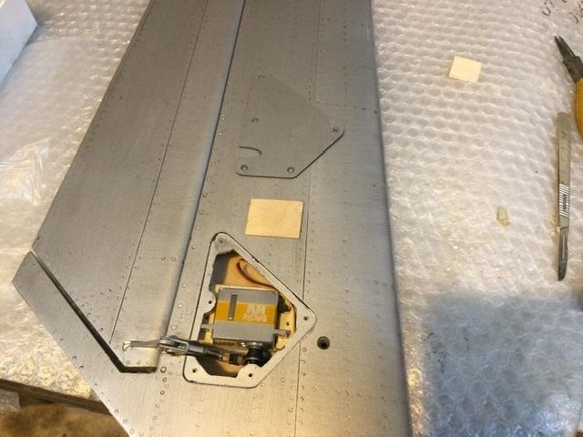

Flaps matched. Wings joined with spars, first wing completed with my desired flap angles. Second wing matched to first. I don’t measure deflection preferring to eye standing on the centre line.
Full flap has pushrods inline with servo horn at full flap to reduce load.
As always with my builds the PB, Rx’s, batteries, switch etc are all for the model-so by the time of the first flight there will be 50+ cycles through the system

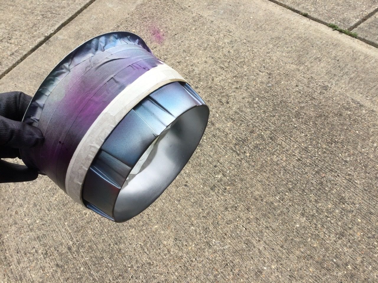

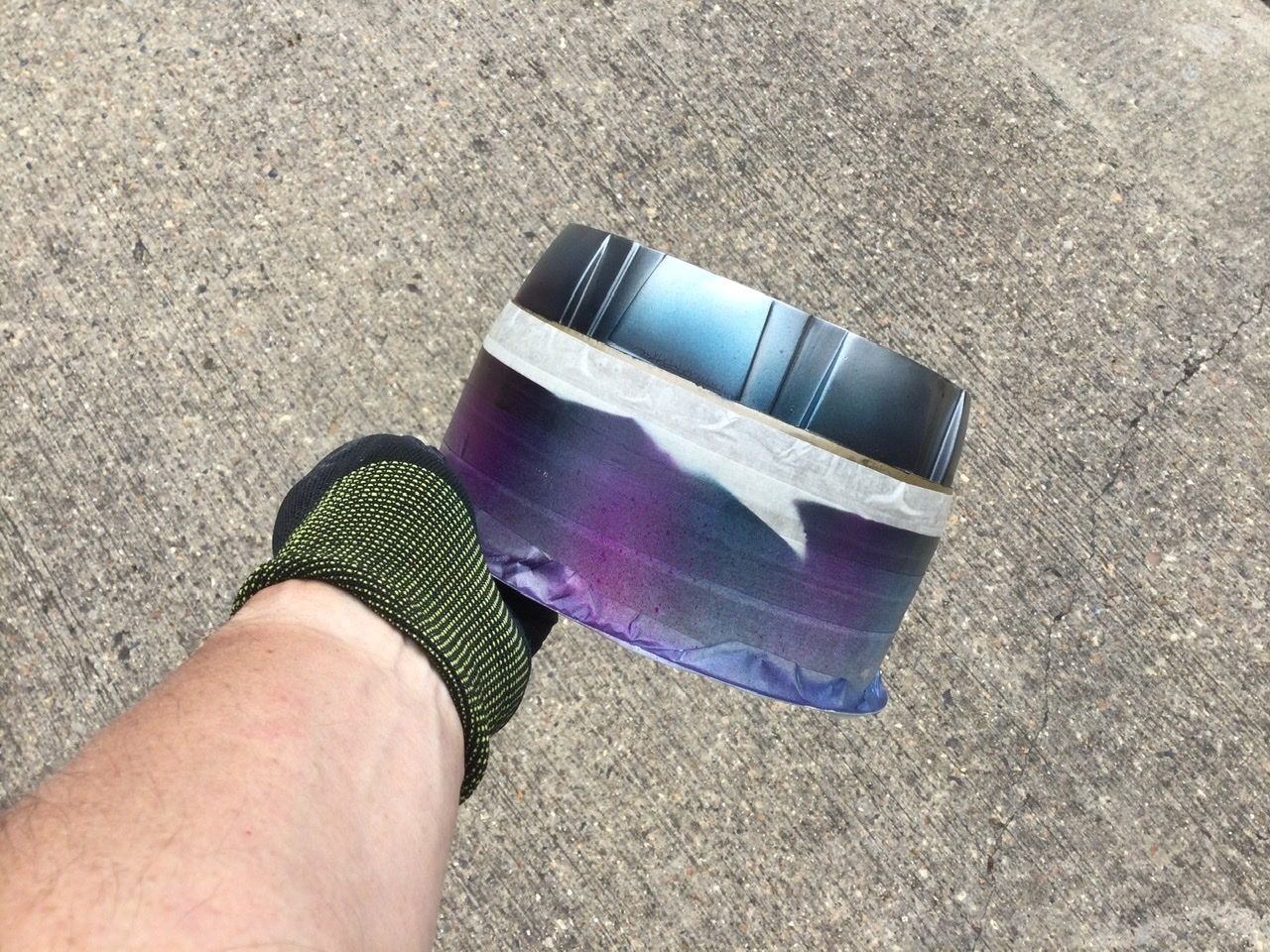

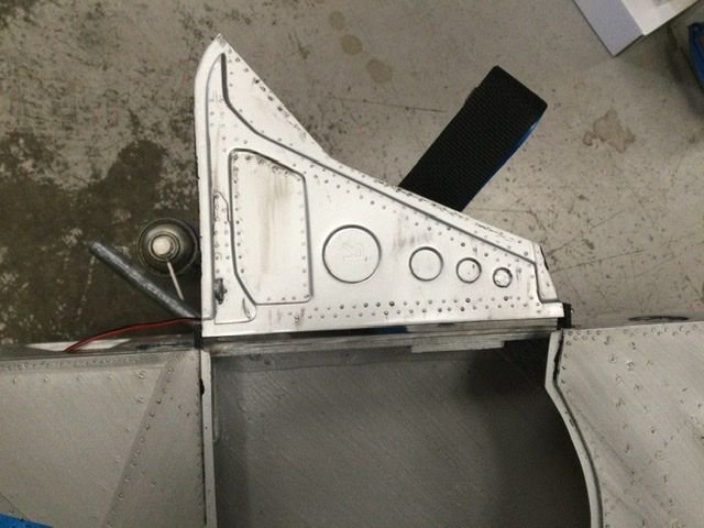

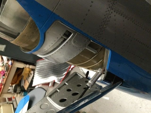

Decided to add heat effect look.

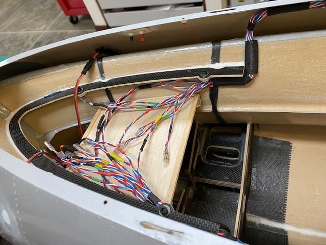

Made this tray to separate the cables from the nose gear.
Height and location are critical because of nose gear strut and servo.
Jack

How much stuff are you putting on the front tray? It quickly comes out nose heavy.
