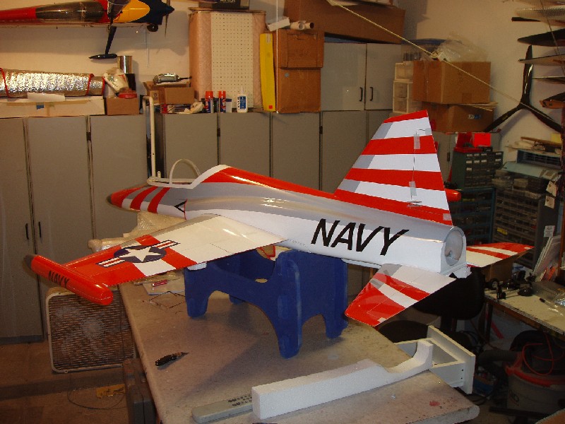

My Flash arrived today. I can't wait to get started on it. I have a P-120SE coming for it.
ID:	656288   Click image for larger version

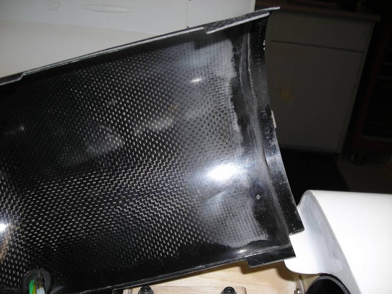

Hi again, Here is the pic of the bypass on my Flash as I posted a few days ago, I have an Artes Falcon in it and have never had any wet or hot starts. I have only 8 flights on it now, and this occured during the last flying session ( 5 flights) . I have a call into Eric at Jet Central about this, at this point I am grounded until I get the heat problem solved. I am going to try and start it with the bypass cover and wing off and watch to see if there is flaming at any point. If anyone has a brand new Bypass they want to sell let me know. Hopefuly the pipe is OK , it is not distorted, but it is very slightly light blue at the turbine end. Thanks for the help, Jack.

Jack,
I would definately start the engine several times and make sure its not "flaming" during startup. The fact that it does, if it does, is not an indication that it is bad, it may simply be that an ECU parameter or two is off.
I'm not sure that a new bypass is really necessary, but I would post a picture or two of the pipe and let those here that have had a pipe collapse give their opinion on whether or not its OK. The fact that it does have support at the front end, where its blue, may mean that's its OK, but I'm not an expert in that area.
Bob

My Feedback: (19)
Posts: 345
From: Levittown, PA
Default RE: Comp ARF Flash update
ORIGINAL: rhklenke
Jack,
Bob
Thanks, Bob for your help, I will run it without the wing and bypass cover to see what is going on ,Thanks Again , Jack.
