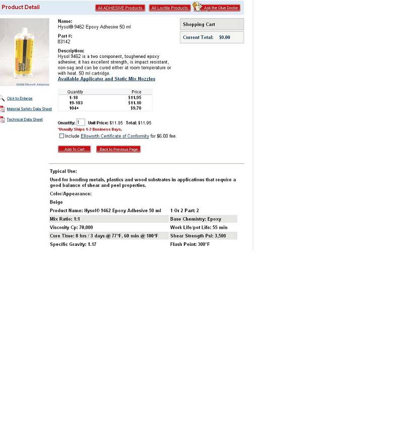

What part # are you using at Fastenal ?? They don`t match the Hysol numbers on my tubes.
V..

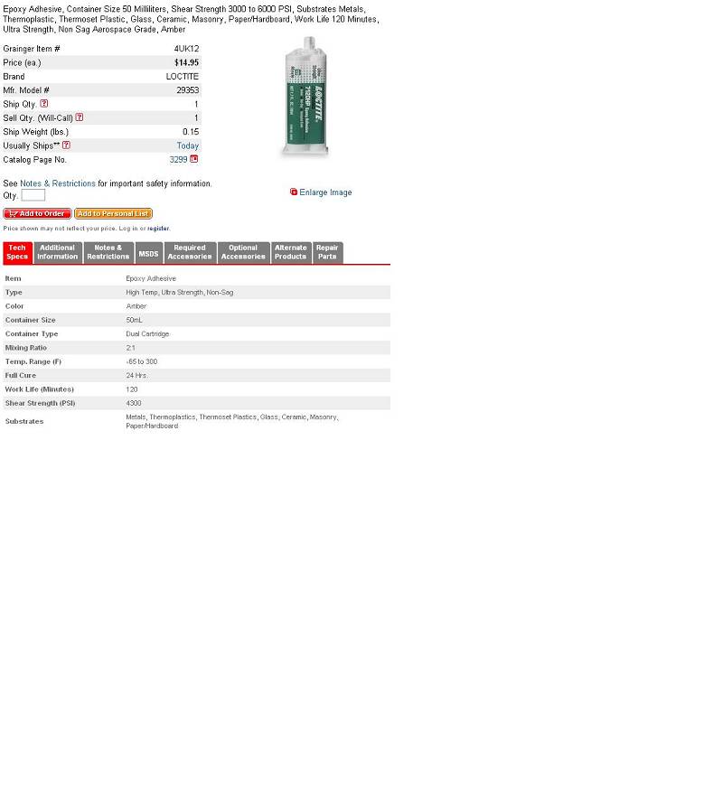

Can also try GRAINGER. I have bought single cartridges from them. While looking around I also notice an "AEROSPACE GRADE, NON SAG" epoxy with a considerable higher shear strength. Hysol 9462 and 9460 have a shear strength of 3500 while the 7120HP is 4300. By all means am I glue doctor or anthing just noticed it while surfing grainger..
ID:	1074938   Click image for larger version

ORIGINAL: Vincent
V..
Try 83142 which is the loctite product number for 9462
