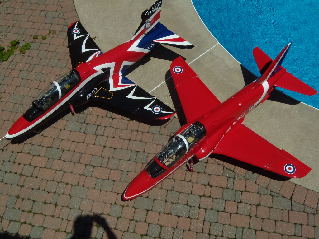

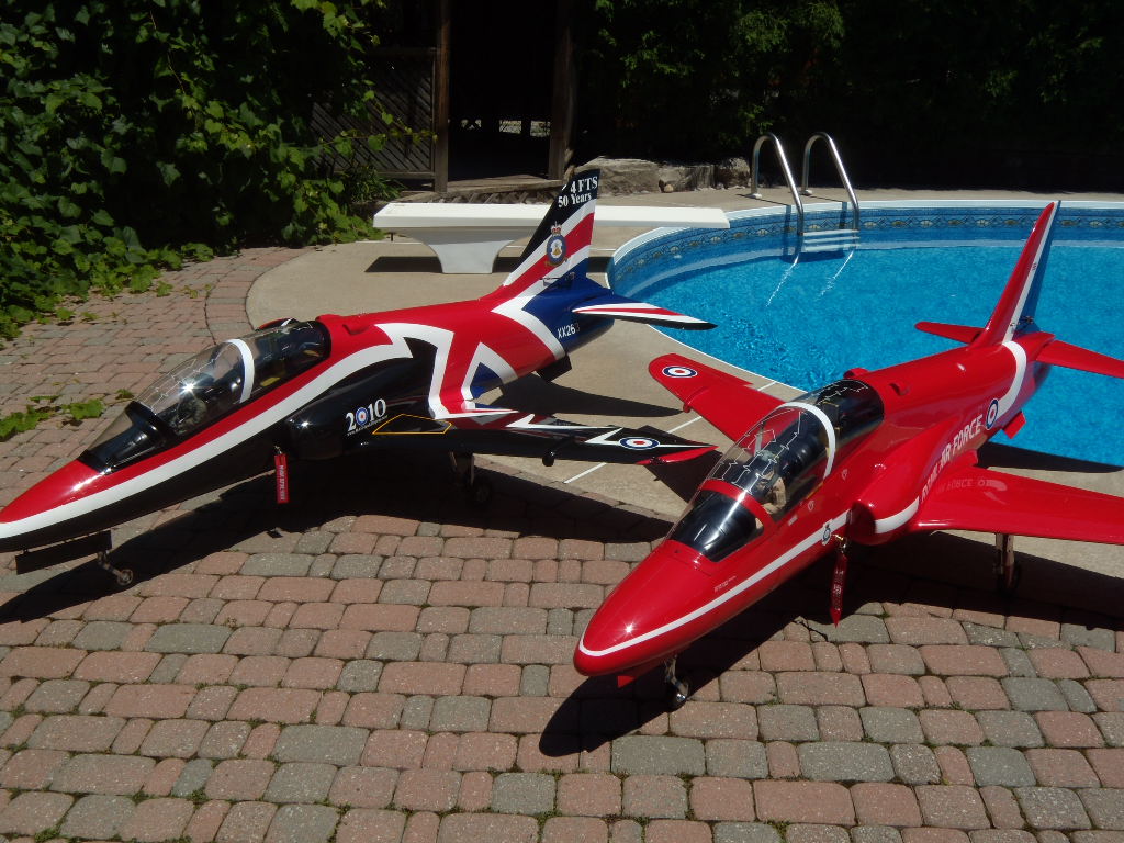

I have two of them. They are set up pretty much identical with full cockpits, 1pilot and large Weatronic (powerbox type)receivers. The Display team Hawk has a P-120sx, lights and a nose pitot and a Tam's pipe vs a JC Cheetah, no lights, no pitot and stock pipe on the Red Arrows. No smoke on either.
Display weighs 29lbs 6oz, Red arrows weights 27lbs 12oz dry with UAT full. I just added an additional 3.5 oz's to the back end of both of them that is not included in those weights. Wanted to move the cg back to 200-205mm as some on here have done to improve flying. Haven't had a chance to try the new CG yet though.
Mike

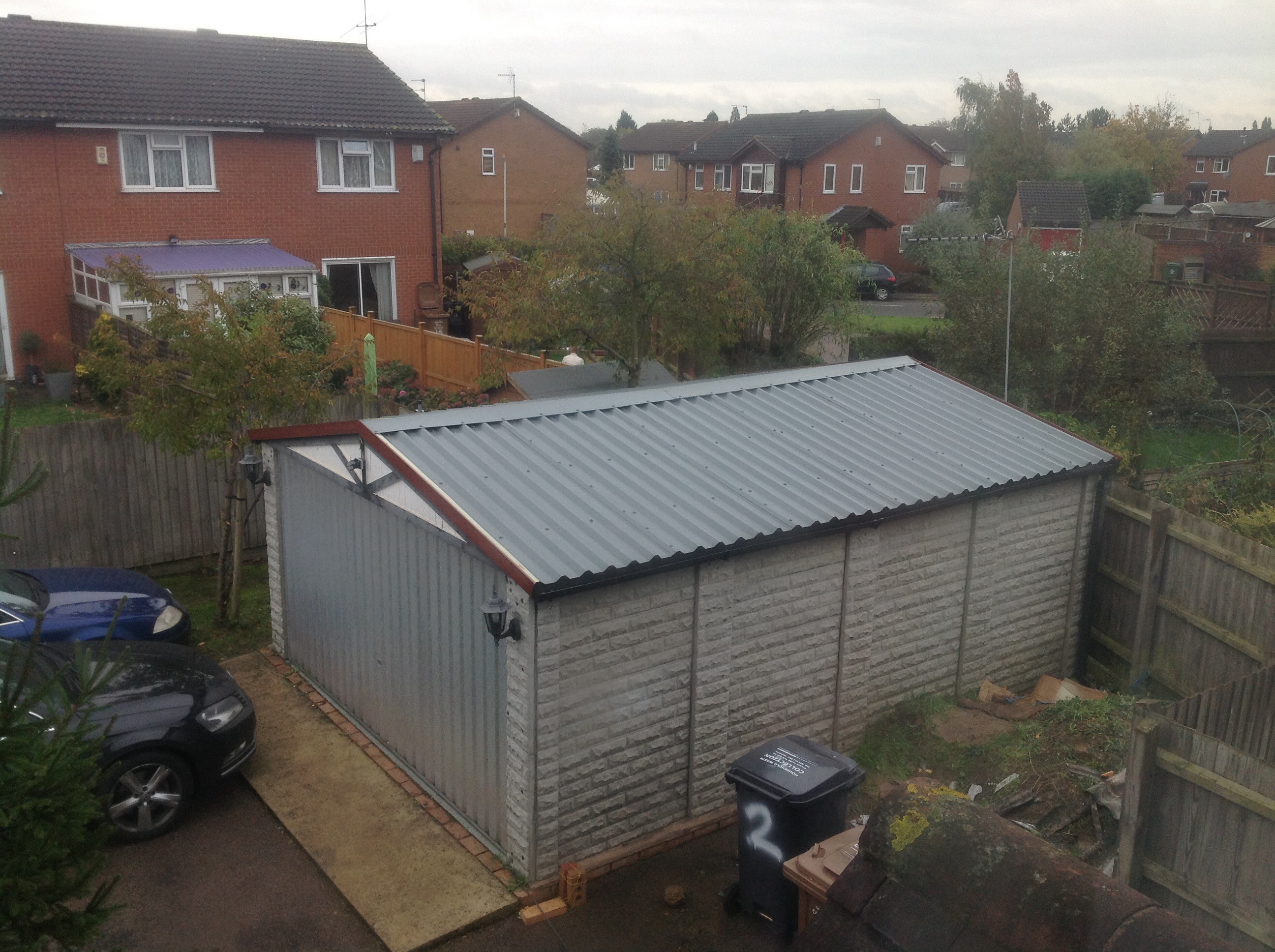

Thanks, I only just thought about it the other day and suddenly realised I did not want 2k paint bending over the hinge!
Just got a small job to complete before I carry on with the wing...
Replacing the roof on my workshop! This PVC coat galvanised steel is really good stuff to work with and is quoted to last 40yrs plus so I will not be doing it again!
Alan
Now finished!

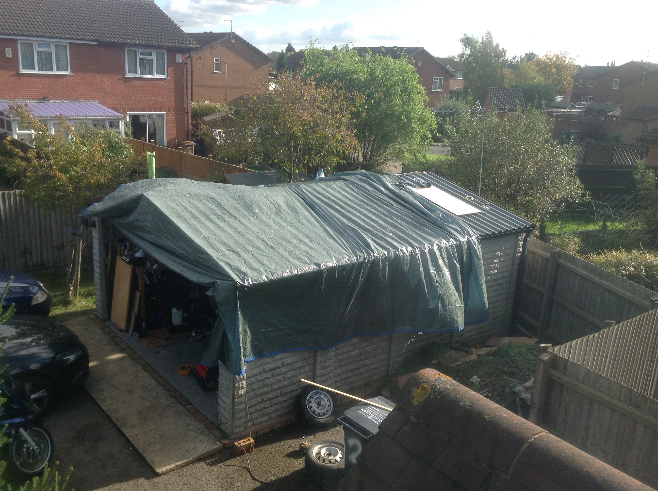

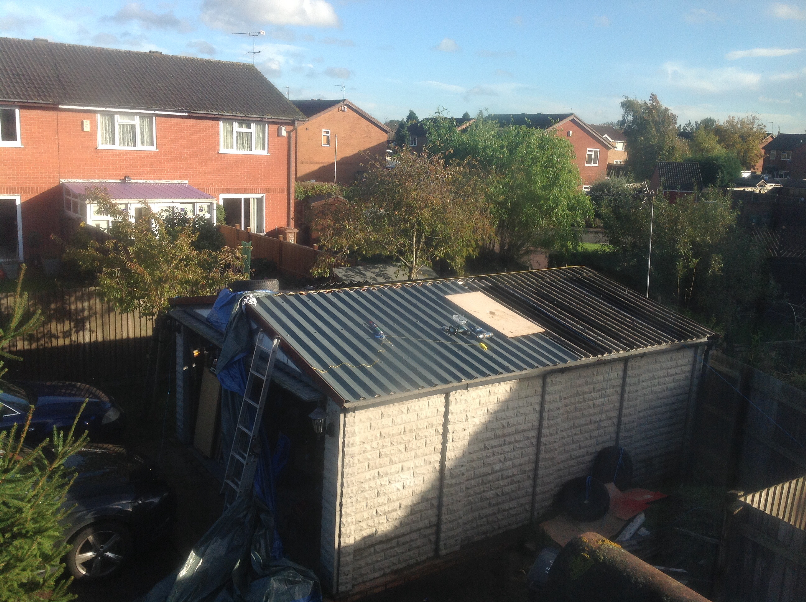

Just got the roof finished and heavens opened right on que, someone must have ordered the rain to test for leaks!
Started this job last Saturday and spent Sat and Sun drilling around 100 holes to fix wooden purlins to the angle iron framework then Mon to Wed to fit panels and tomorrow will be sealing day and clear up day back to work on Fri for a rest!
Looking forward to get back to the models!
Alan
