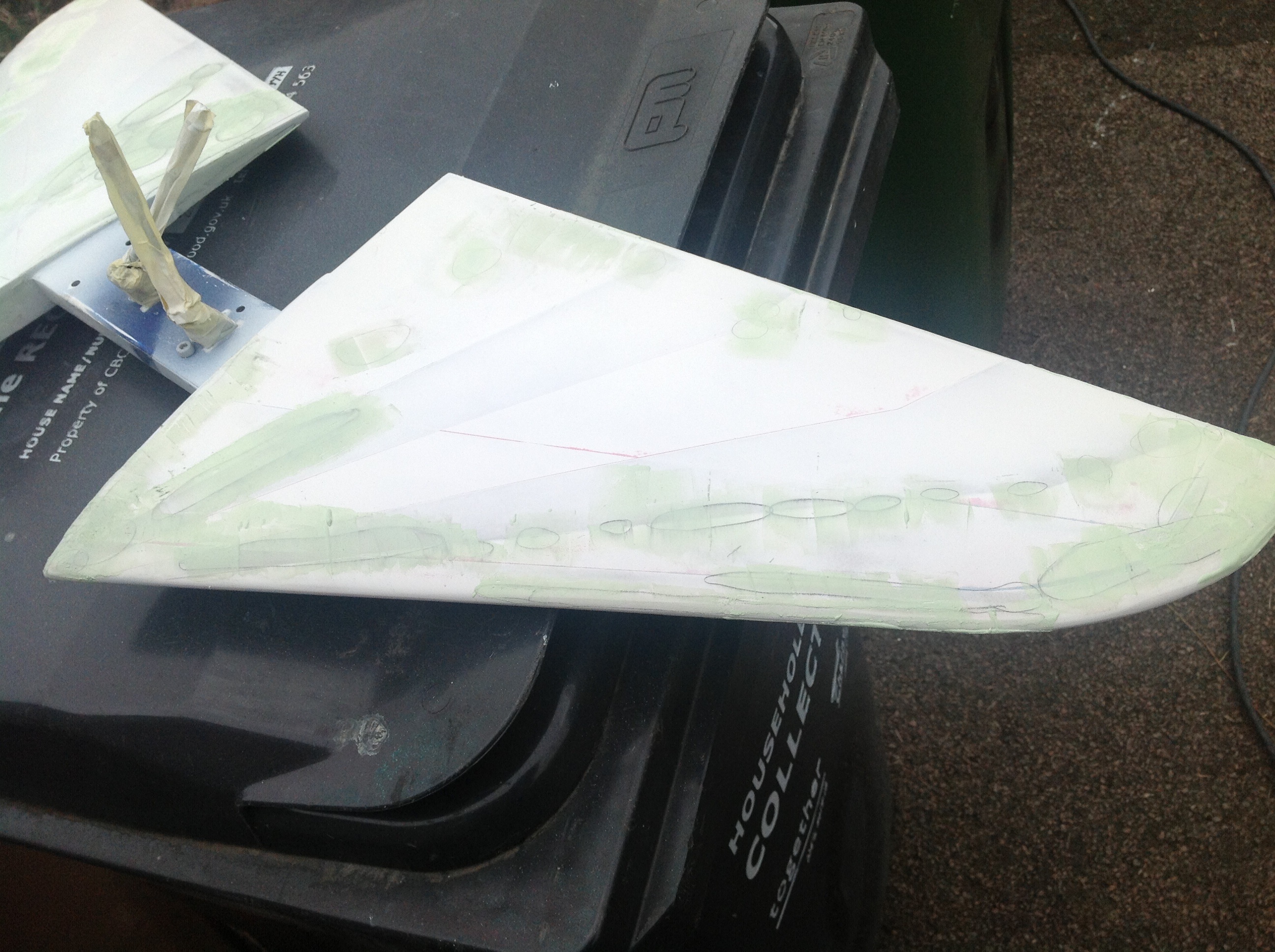

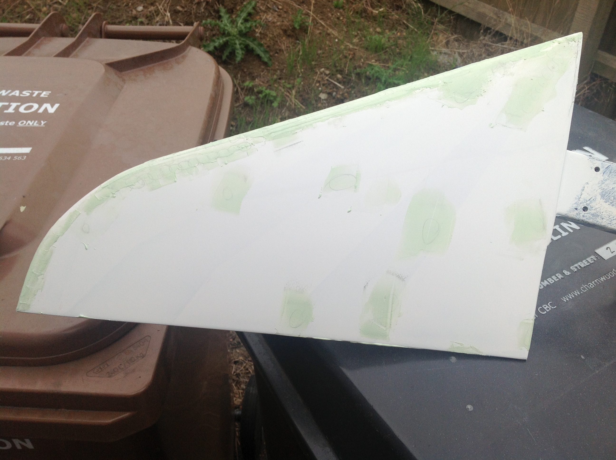

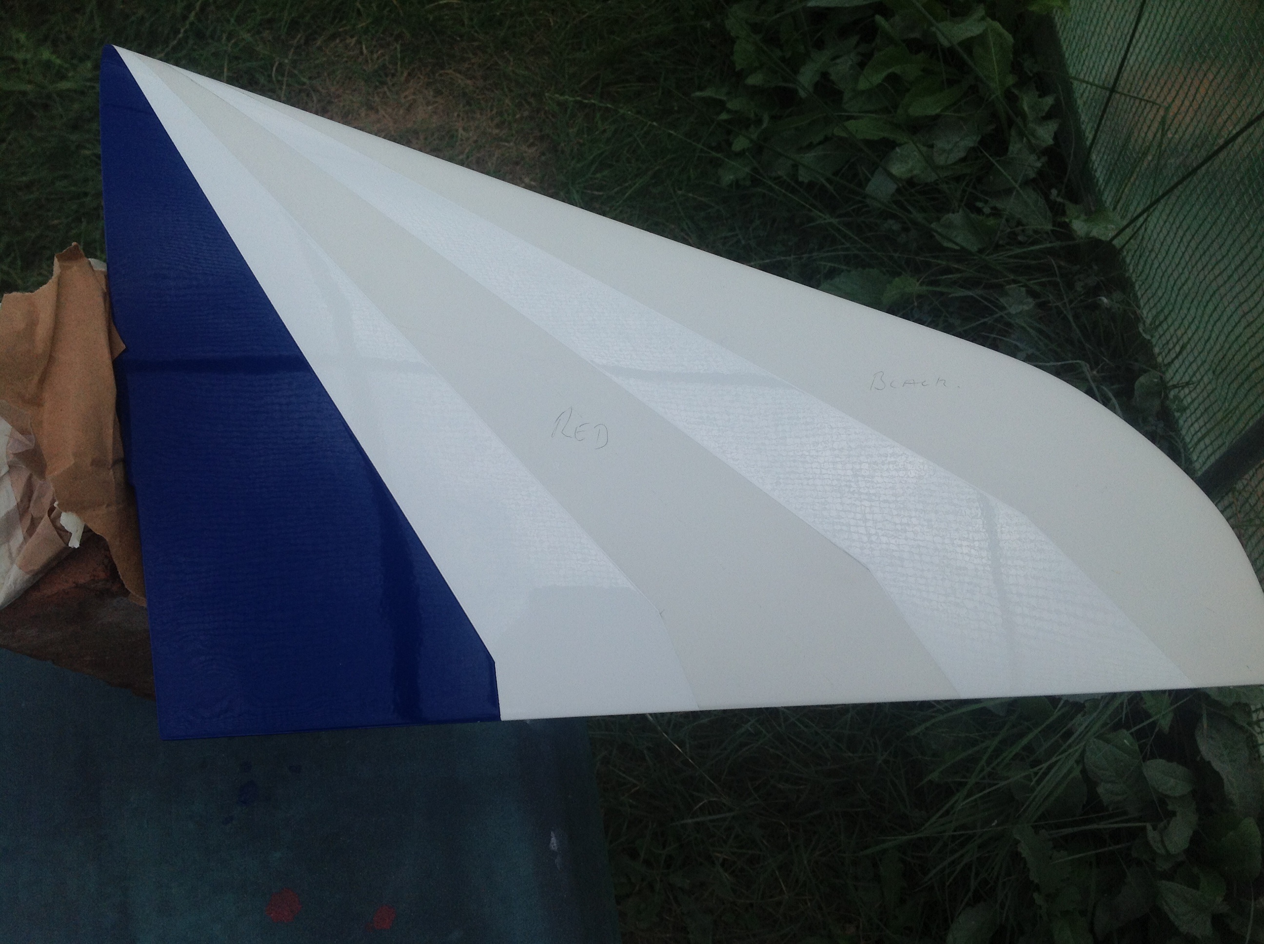

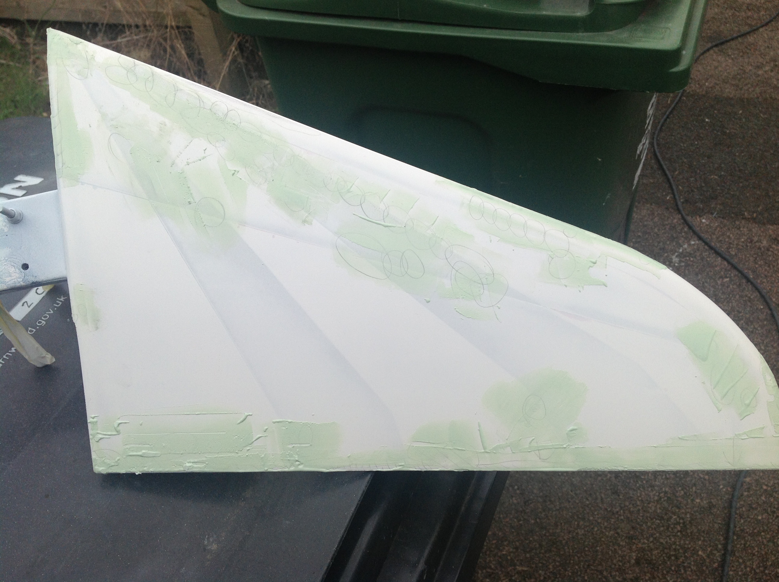

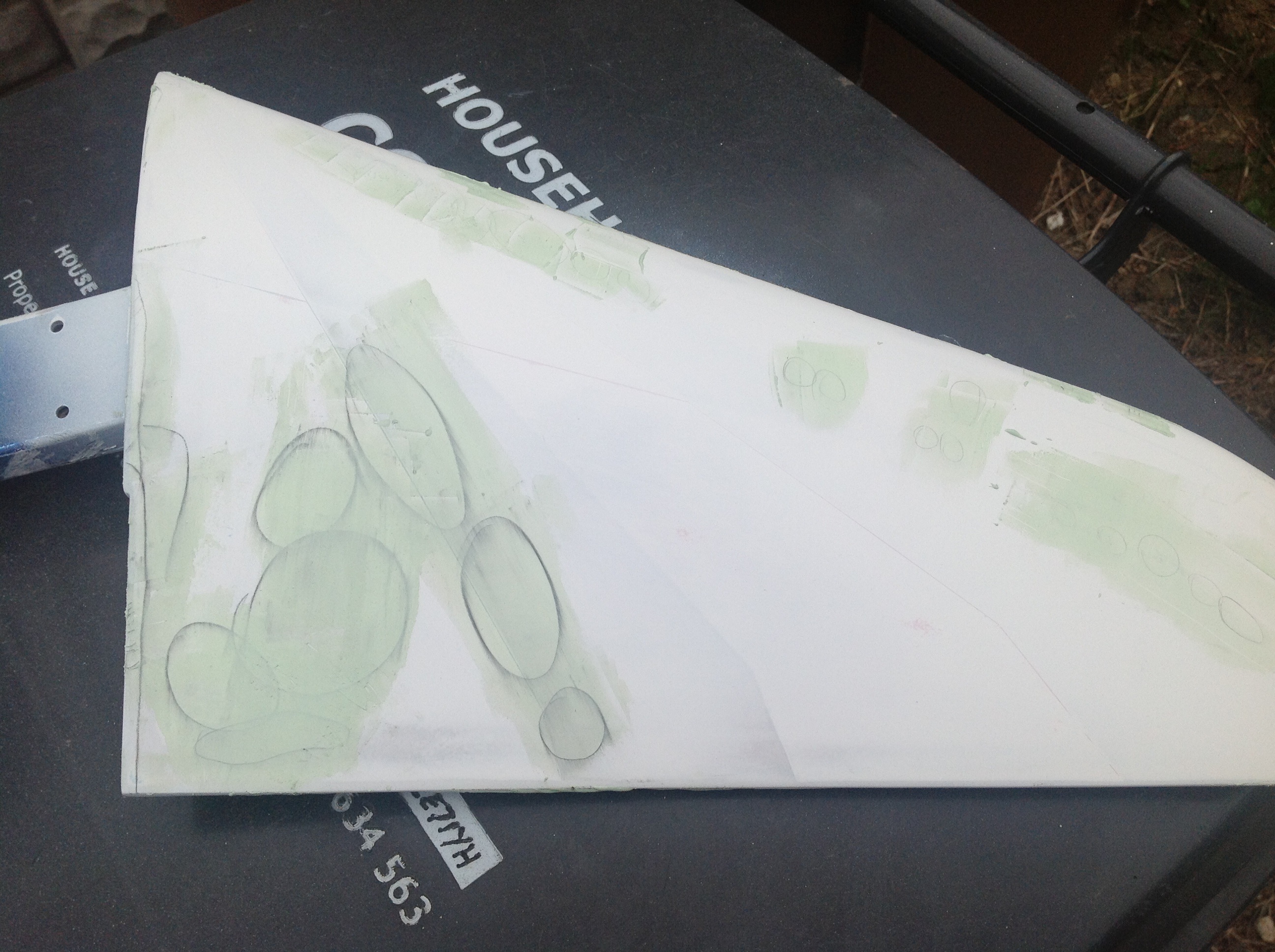

Tail plane was no better than rudder when it came to pin holes, so out came the Upol Dolphin Glaze again...
taking off all the colour and going down to white/fibreglass took off 41g so well worth taking the colour off.
On another note I had to have my car bonnet/hood re sprayed (insurance job or I would have sprayed it!) and the guy came to my house complete with spray booth. Cut a long story short but he gave me a sanding tool that takes extraction and some sanding papers, well this turned out to be very good and well recommended, they use a Velcro hook system to fit on but the sanding stick on is made from a resin base material but it rips through filler very easily and when you rip off the sanding disc the debris just falls off! These are used in auto re finishing trade but I am sold on them all P grit sizes up to 800 available
Alan

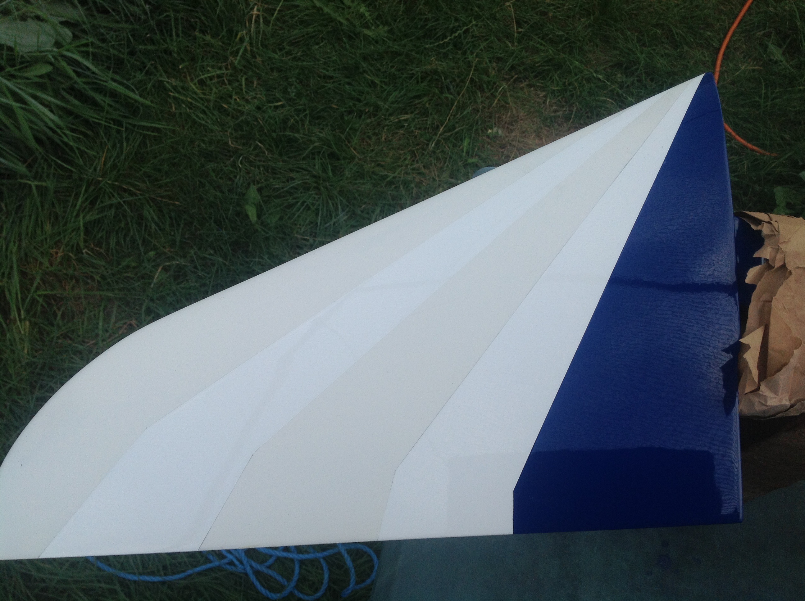

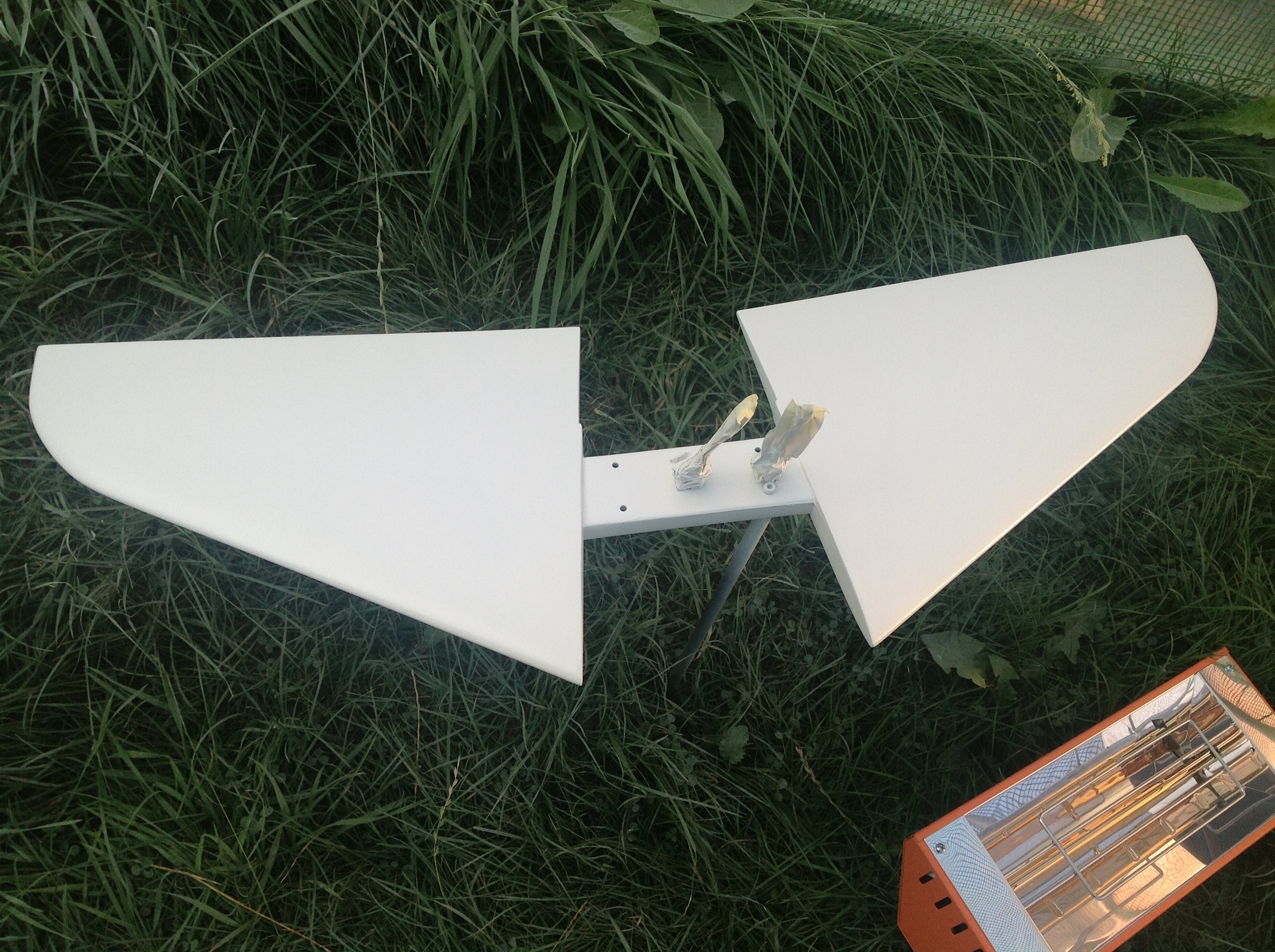

On with painting the tail plane today as I got a feeling our summer is about to end!
Alan
managed to get the white done today with just red and black left

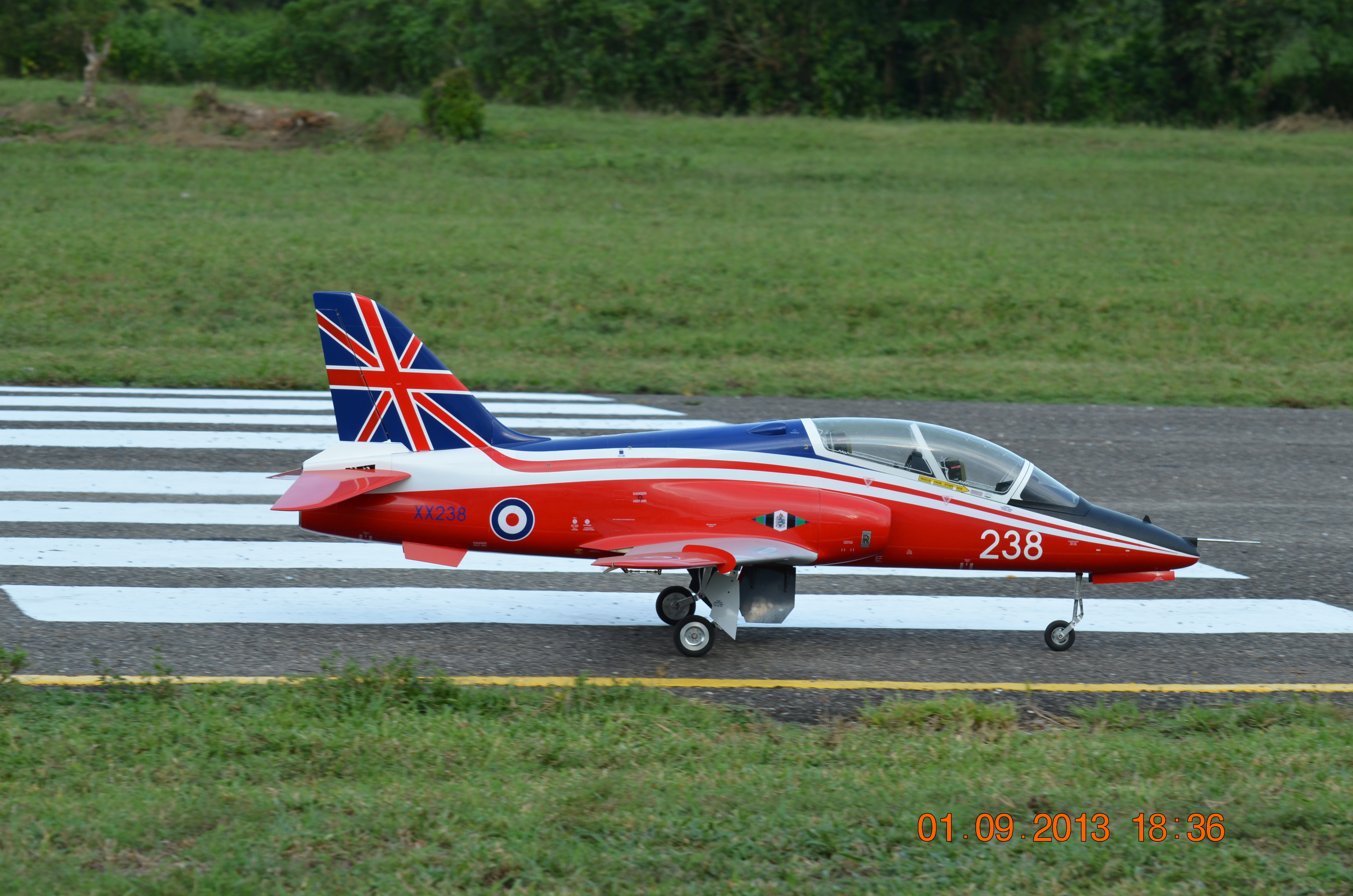

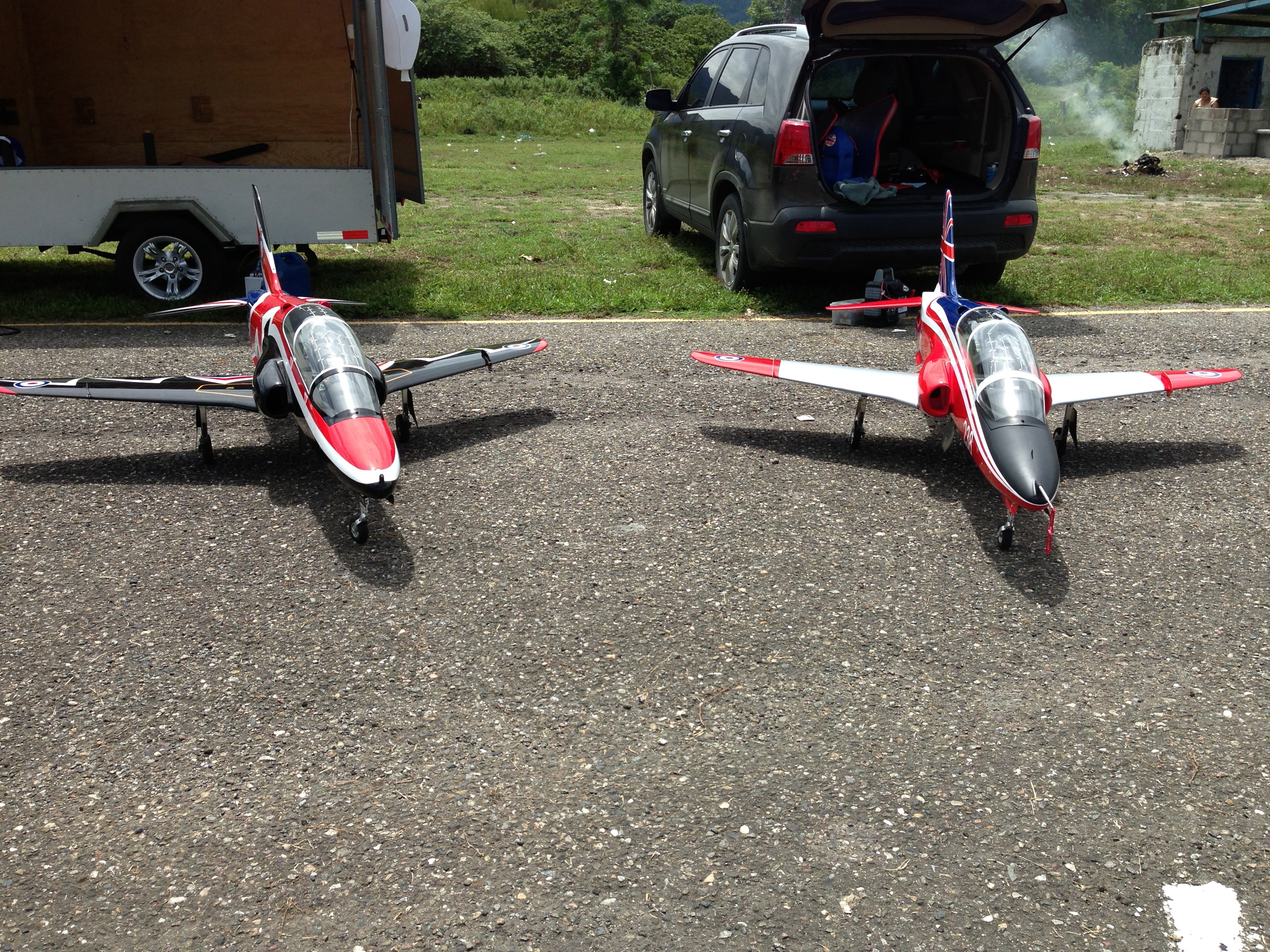

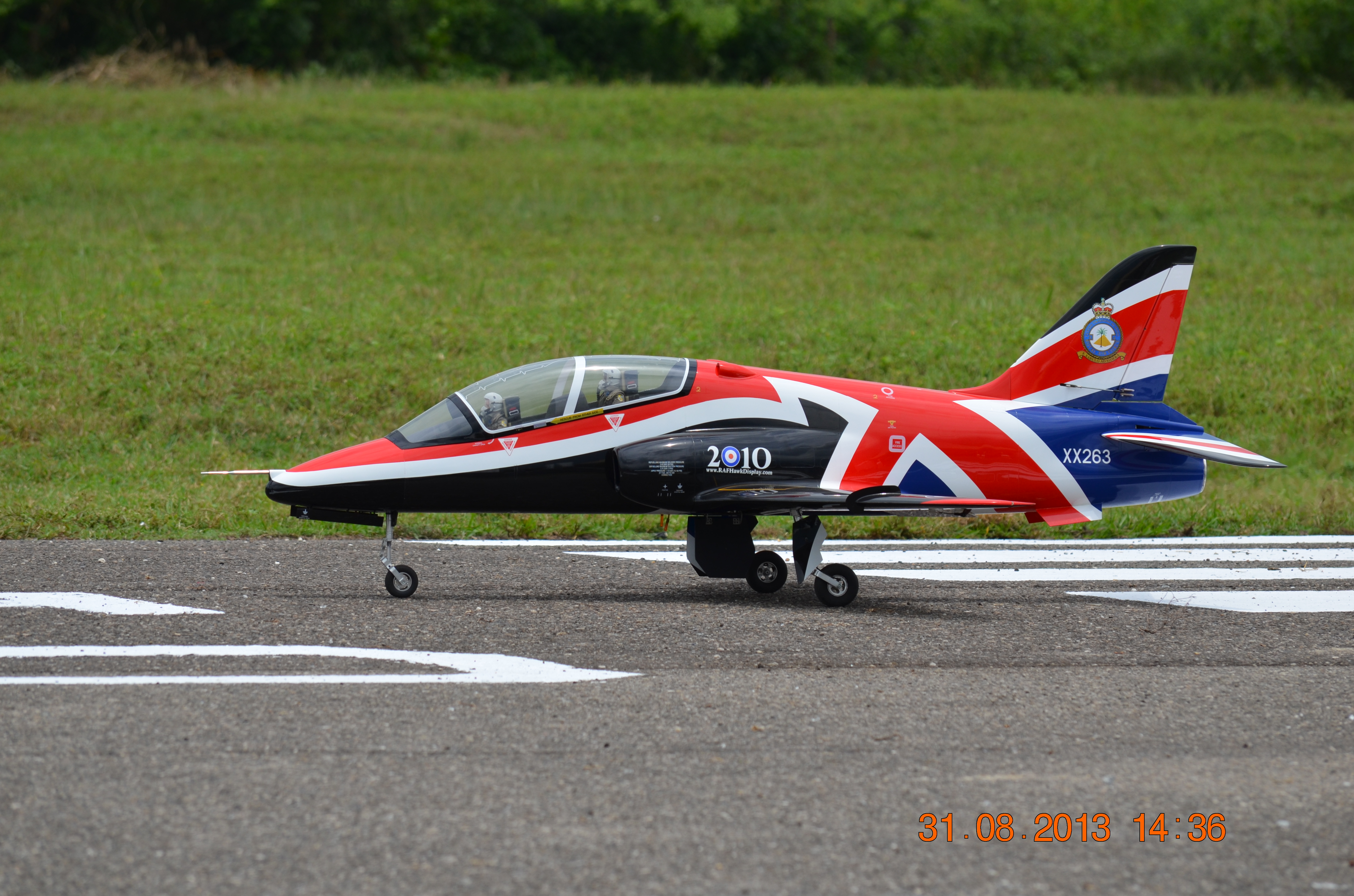

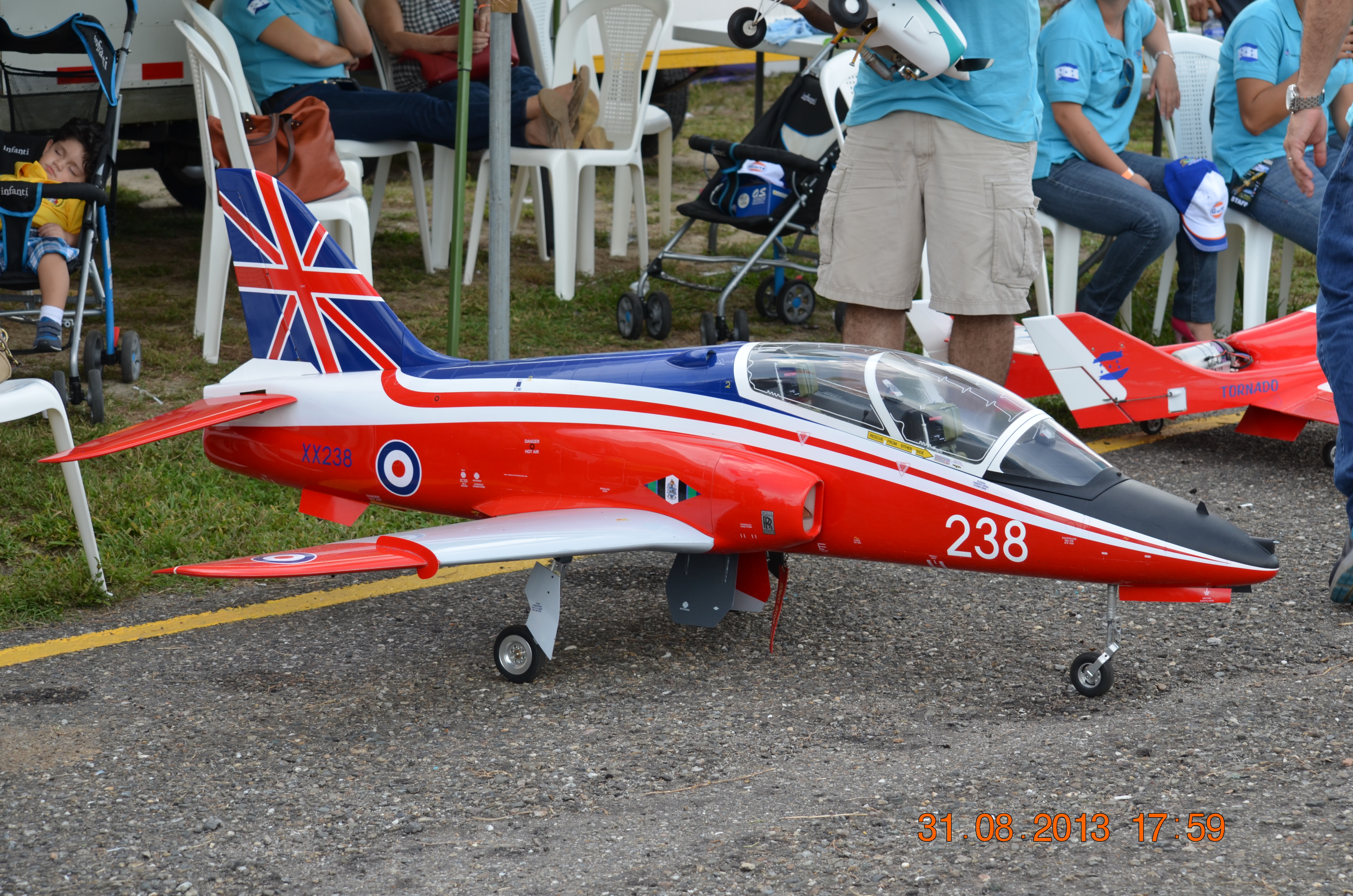

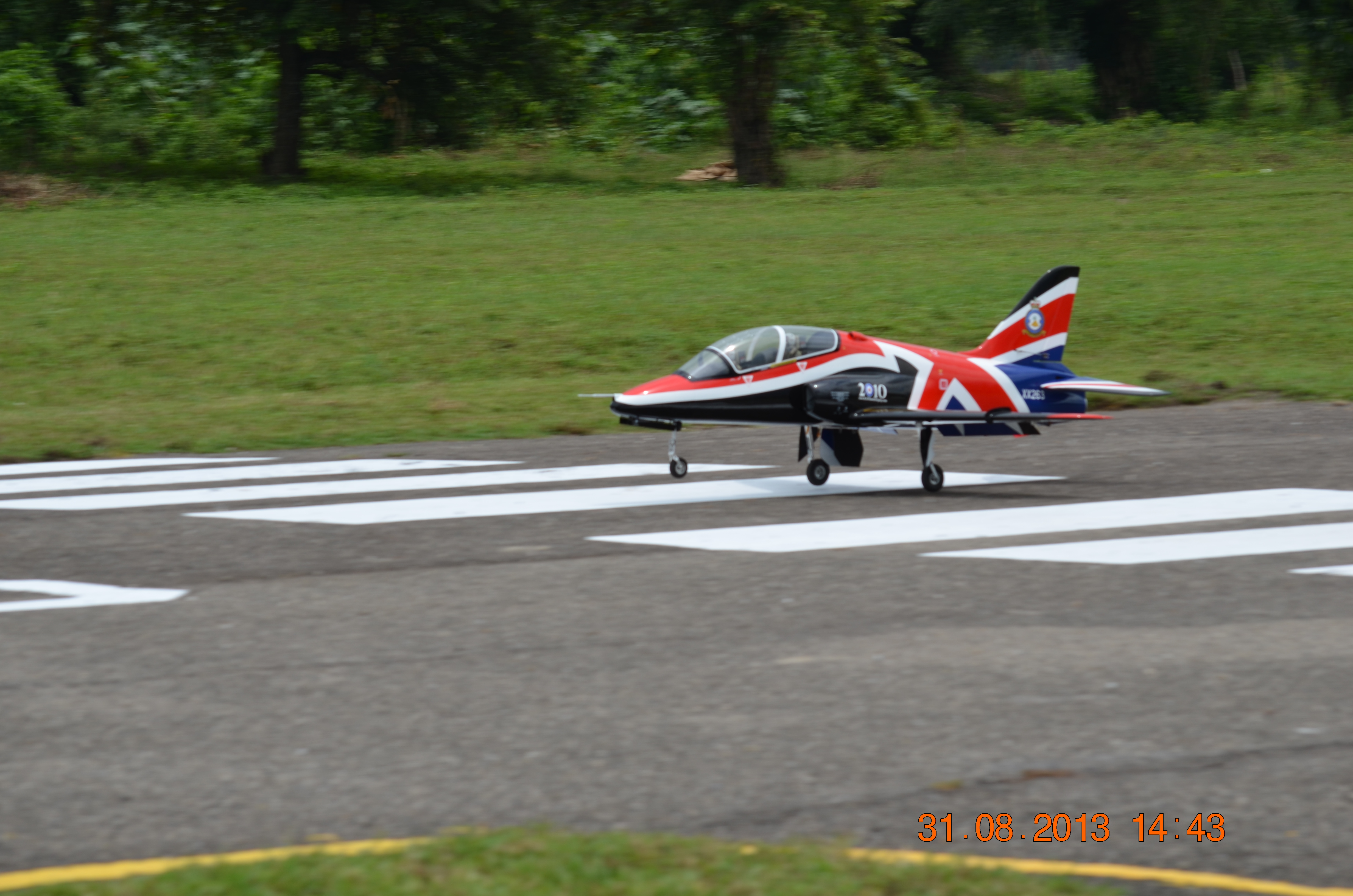

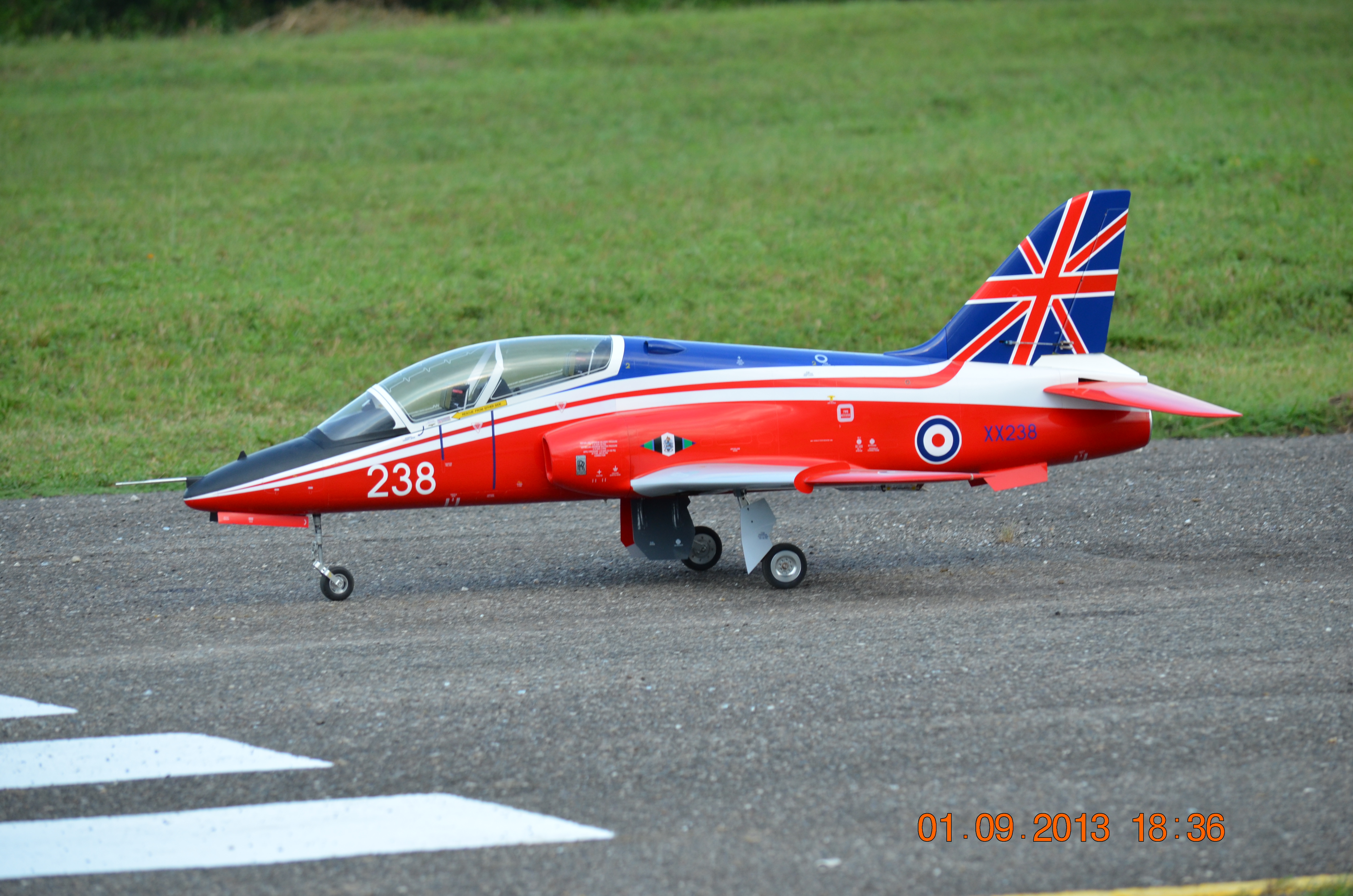

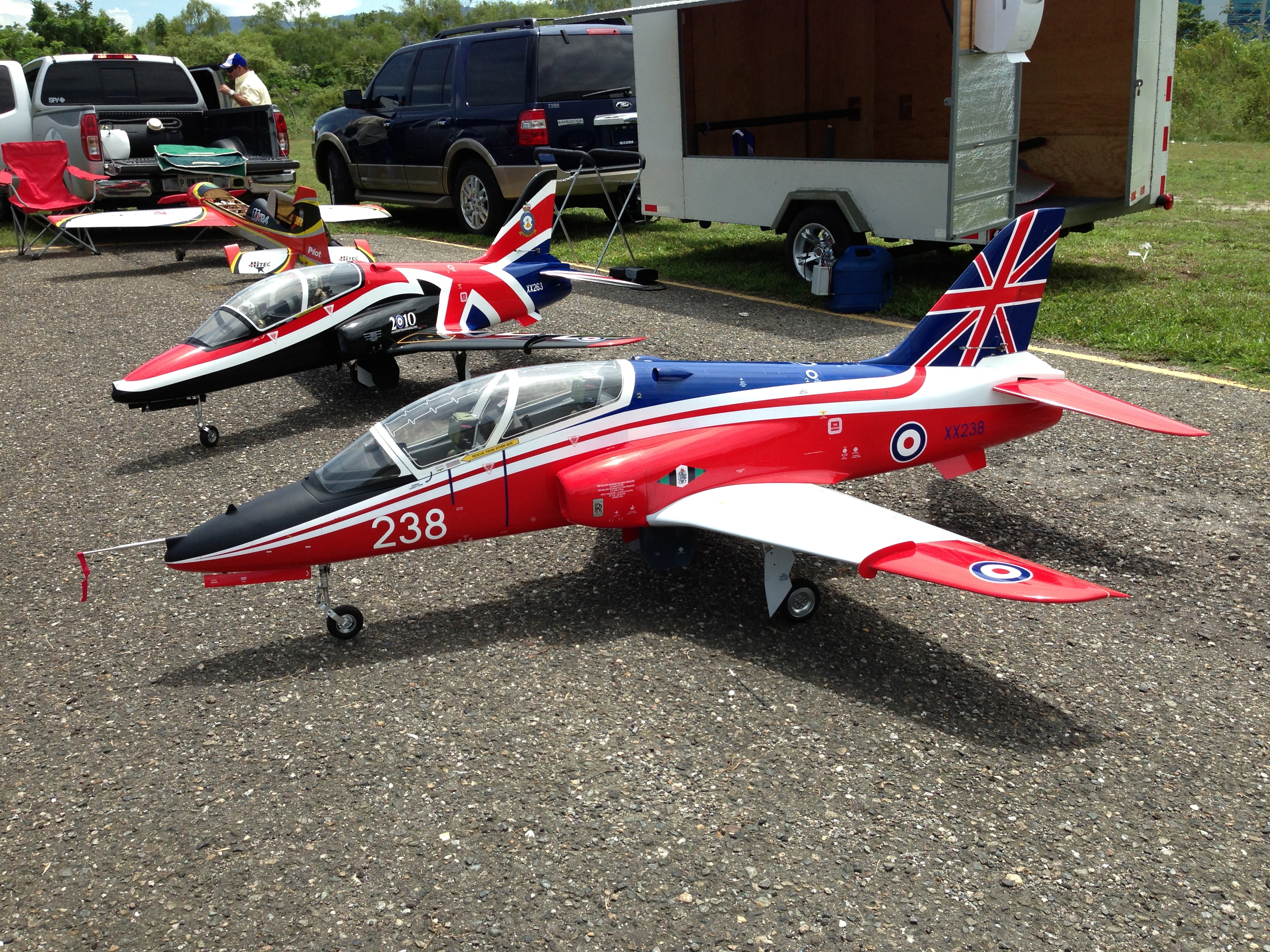

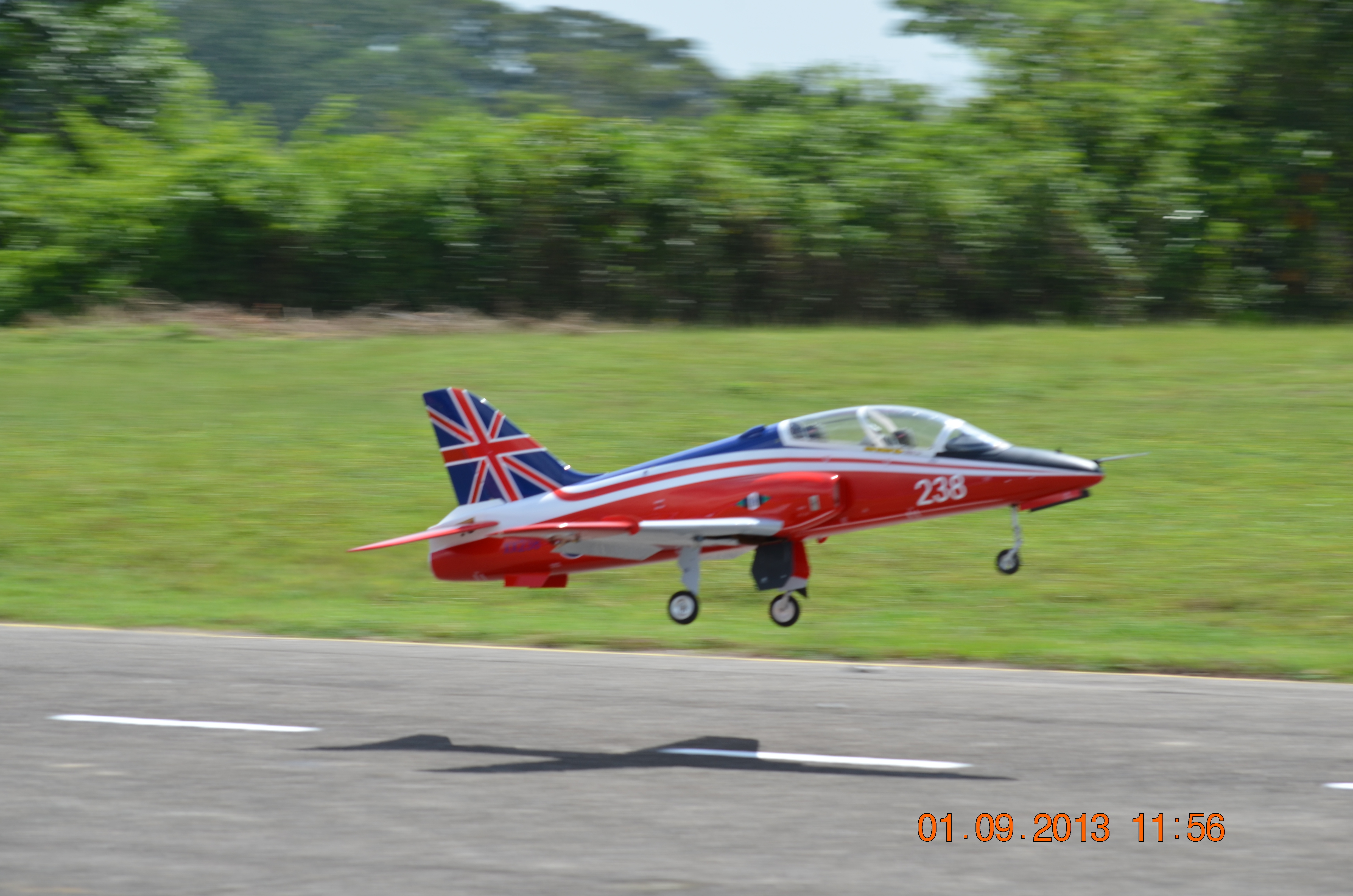

Hey Guys, just sharing some pics of our Hawks here in Honduras, at the yearly event held in San Pedro Sula. ( Alas del Merendon 2013 )

Nice venue! Looks like your event had good local support as well
Still think the Hawk is a good looking aircraft not just because I have two, but that's why I brought them!

Thanks for posting those pics. I was really happy to see what your friend did with the CARF 2010 Display Scheme. I like that he painted the fuselage strakes to match and just applied the Tailormade decals to the factory color scheme as it looks really good even though not exactly to scale..

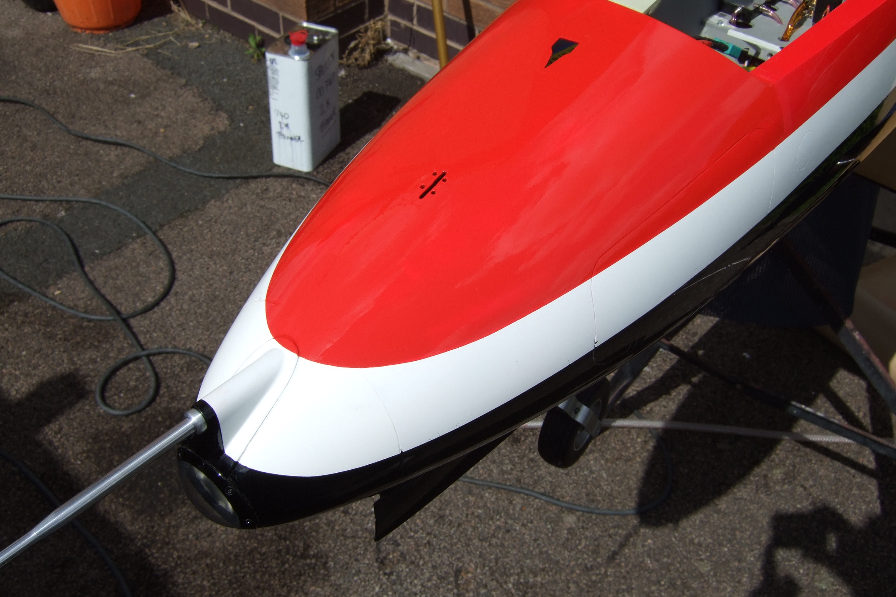

My Hawk came with a "false nose section" with the molding for the pitot tube. Kenrico, did you guys use that? Or just glue on the pitot tube bump only? I am not trying to make my Hawk look exact scale, but a few things, like those pitot tubes, really seem to make the Hawk look cool.

I took the edge of the pitot molding down to around 4mm and sanded paint off fuselage and fixed on with Hysol, as I make the pitot probes I also make a 4mm insert that you Hysol into the molding that way you can unscrew the probe. Just in process of making another probe that will be on its way over the pond when finished...
Alan
