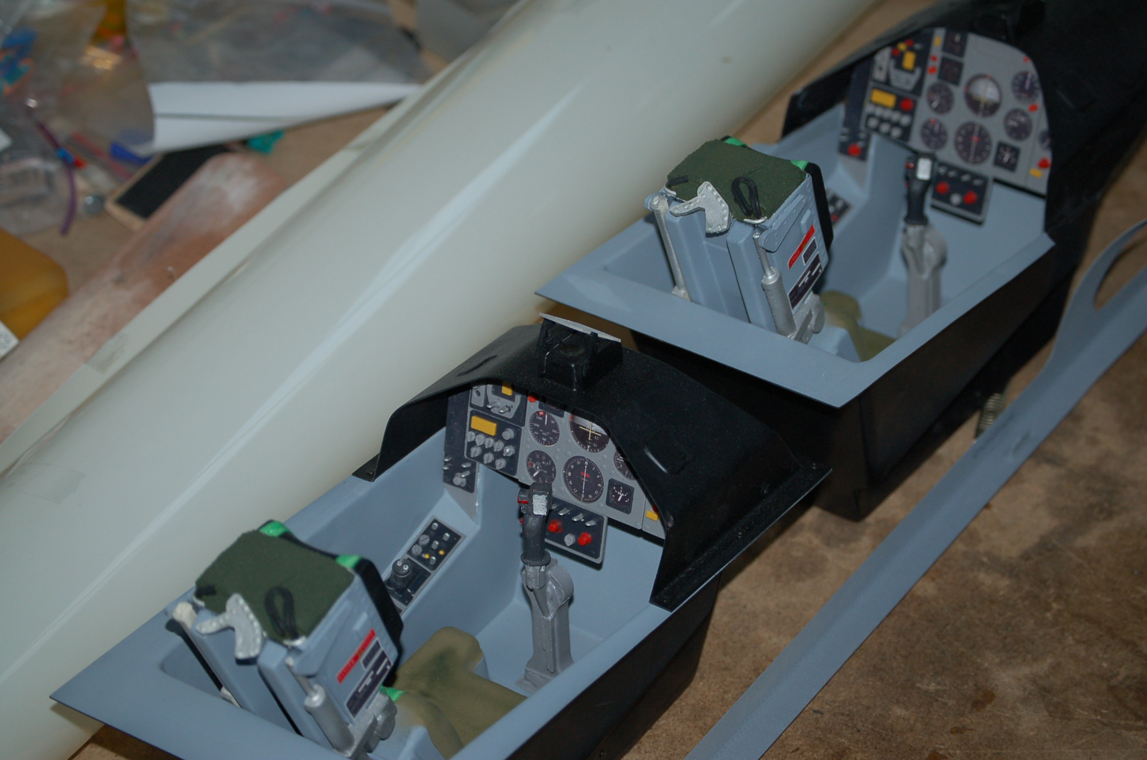

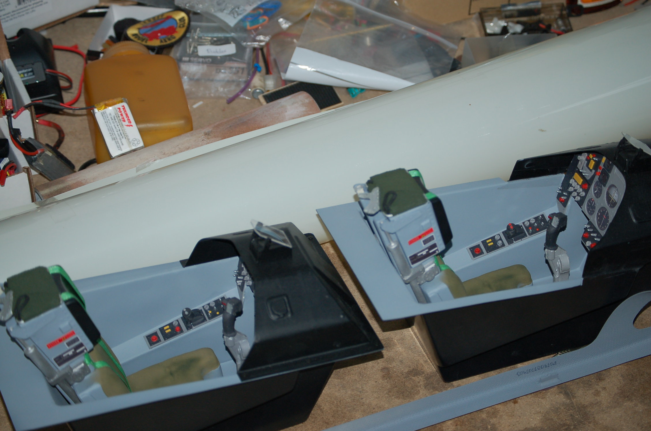

You don't need Aluminium arms! Its just dead weight. With JR servos the Super Servo arm set is all that is required.
The GJC Cockpit will only allow a bust to or top part of pilot to be fiited, the seats are not wide enough for a 1/5th scale pilot.
Although the DerJet one is more, its way more scale.
Dw

DerJet cockpit.

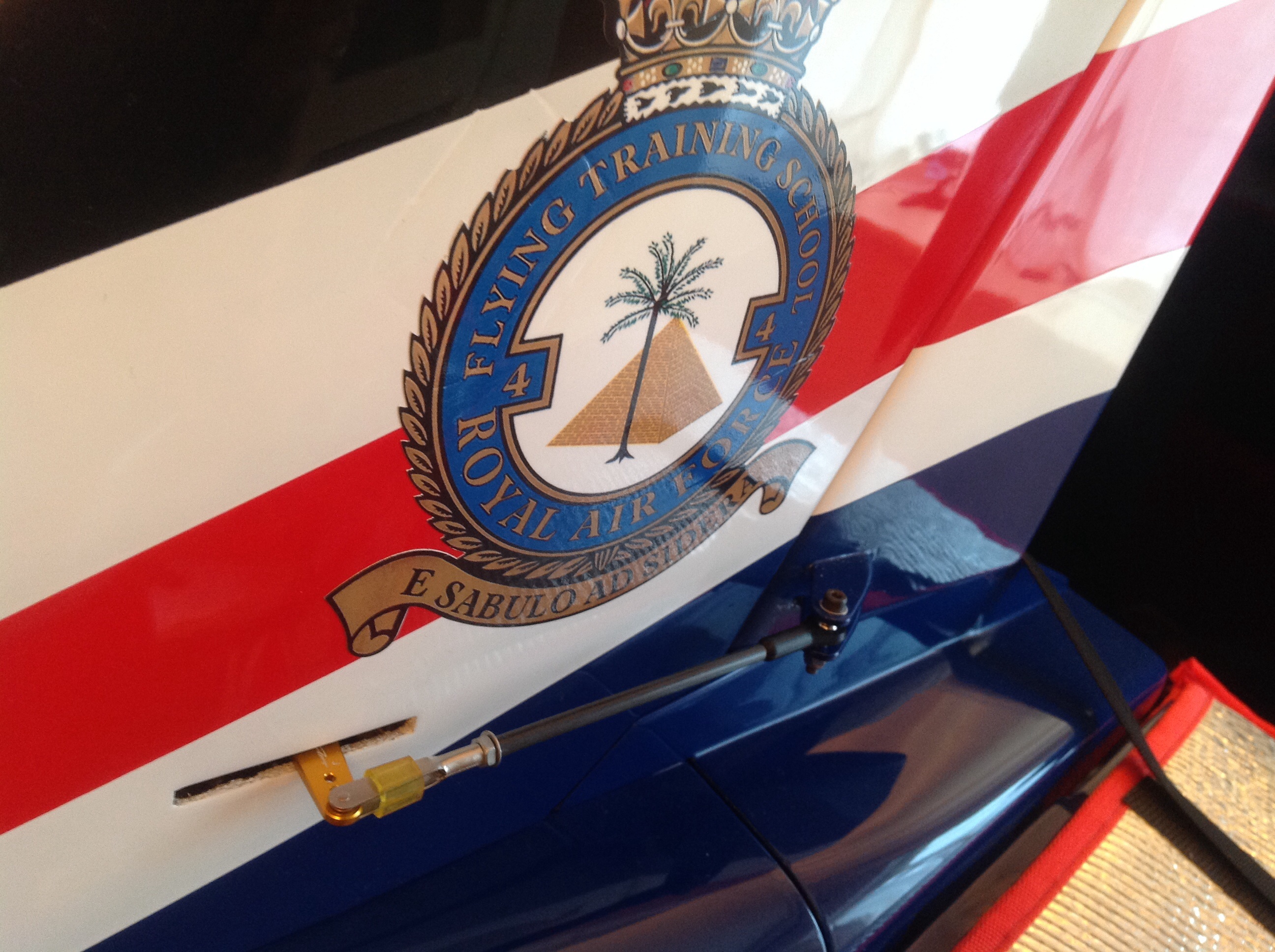

So we've been looking at the flap horns on our Hawk, and sure enough, they don't line up with the flap servo. I thought that CARF had fixed this? Ours is a custom scheme, so we know its not an old one that has been in stock somewhere...
They do include some extra horns, so I guess we'll just install some new ones that are in line with the servo.

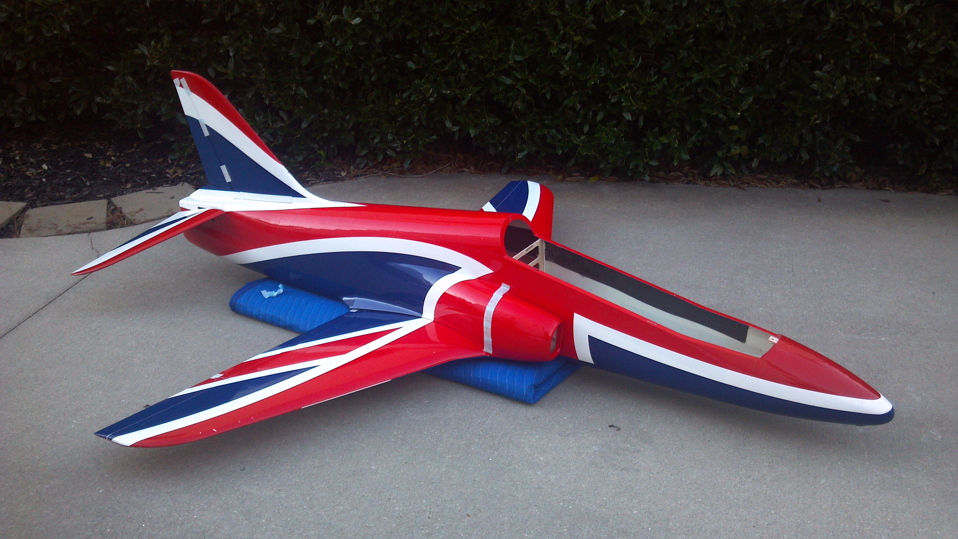

Yep, here's a peak...
BTW, technically its Louie's, but maybe he'll let me fly it once in a blue moon...
Bob

Very nice. Louie will have a good one!
