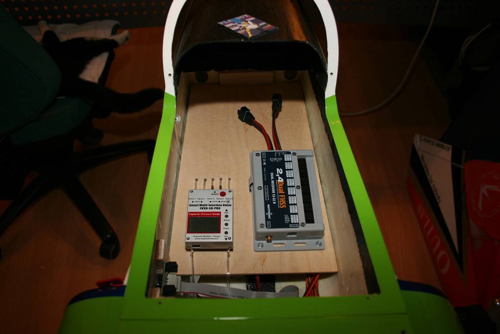

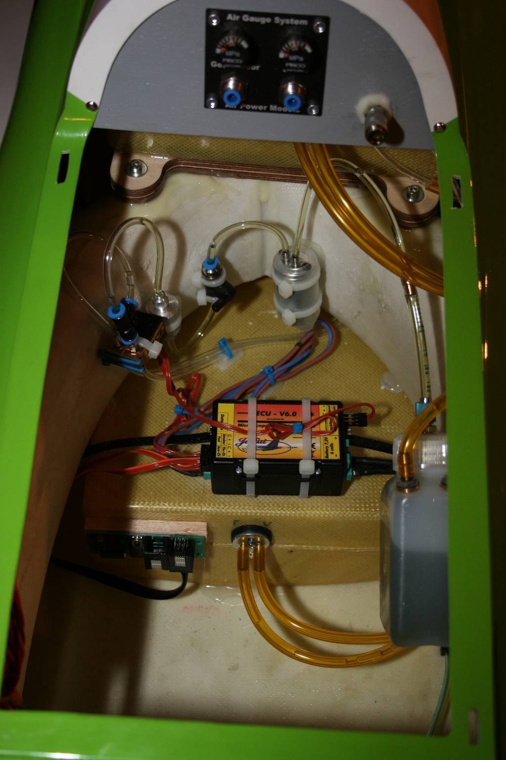

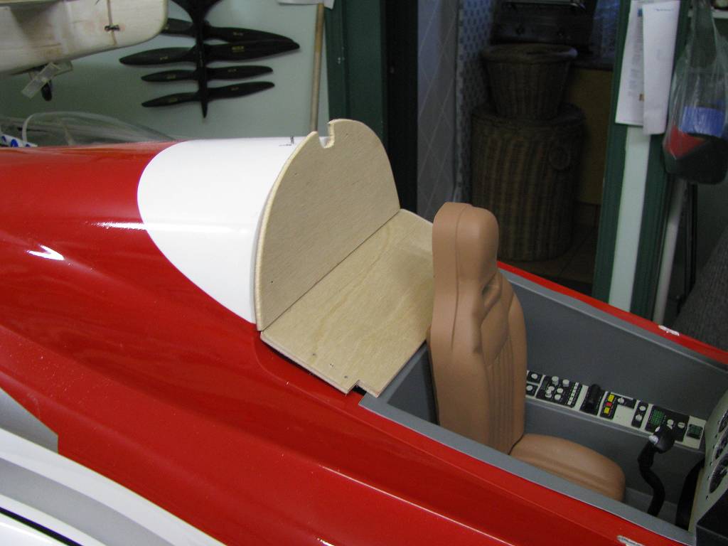

Default RE: Another Skymaster Viper
John,
a few picturres from my P200SX install, lots of room!

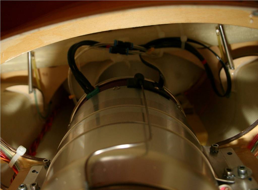

ORIGINAL: DENTO
G-DAY EVERYONE Just a reminder guys how about some shots of your turbine install.
REGARDS
JOHN
I'm waiting for an engine mount for the P160 unfortunatley it was missing and I only realised at the weekend, but its been dispatched. so I am hopefully going to attack that soon. Just finished installing and pressure checking the fuel tanks. I have always done this , the only time I didnt, was on my Ultra Bandit, and the centre tank had a leak under pressure (when being filled) and it was a complete N*ts ache to find. I also noticed on mine that the lower tank seam was fowling the fuel pipe hardware. I removed some of the seam and cynoed it to seal it.

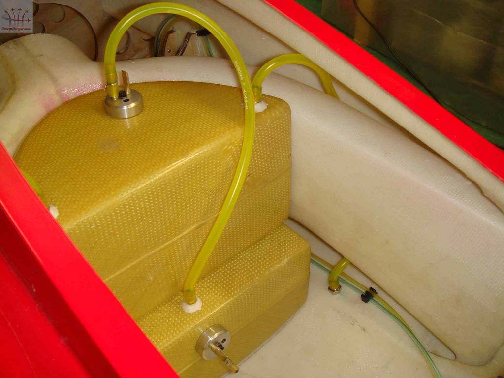

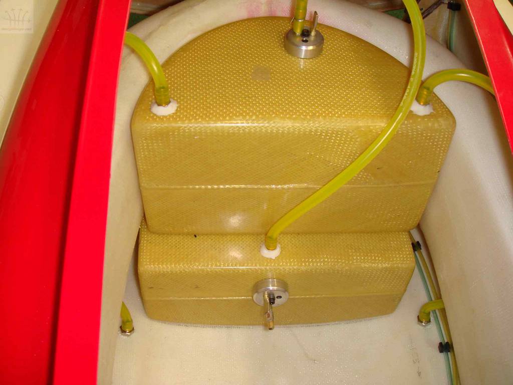

Does everyone have their tanks in these positions?? Is this a change to newer kits?
Mine was an early kit and my 'second' tank (the curved one) sits on top of the inlet ducts.
Old 11-10-2009, 07:58 AM
  #383
Carsten Groen
Carsten Groen's Avatar
Join Date: Nov 2004
Location: Denmark
Posts: 1,803
Received 12 Likes on 9 Posts
Same here Mark,
I took mine with me home from JP (so must be "relative new"), tank also sits on the inlet ducts..
