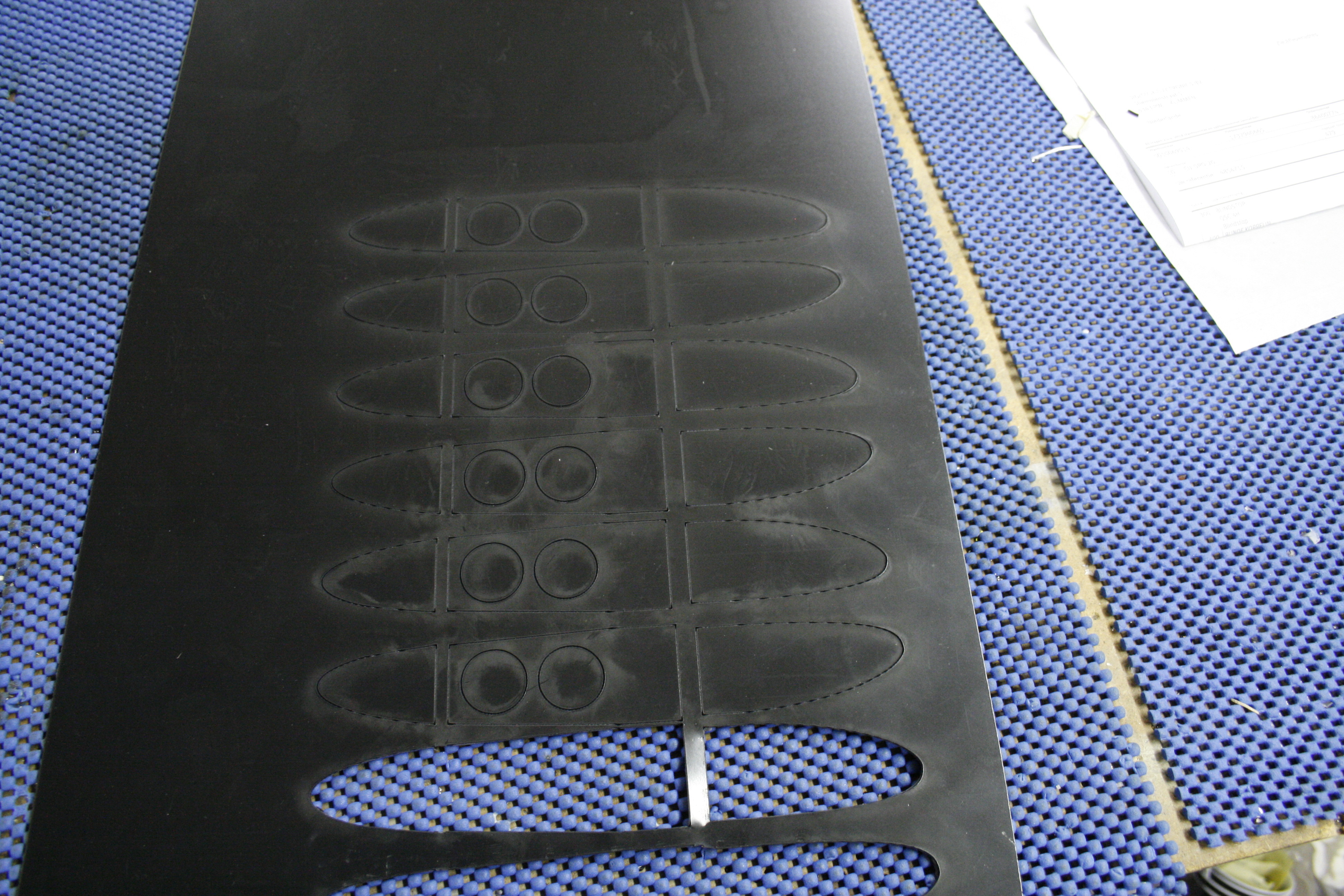

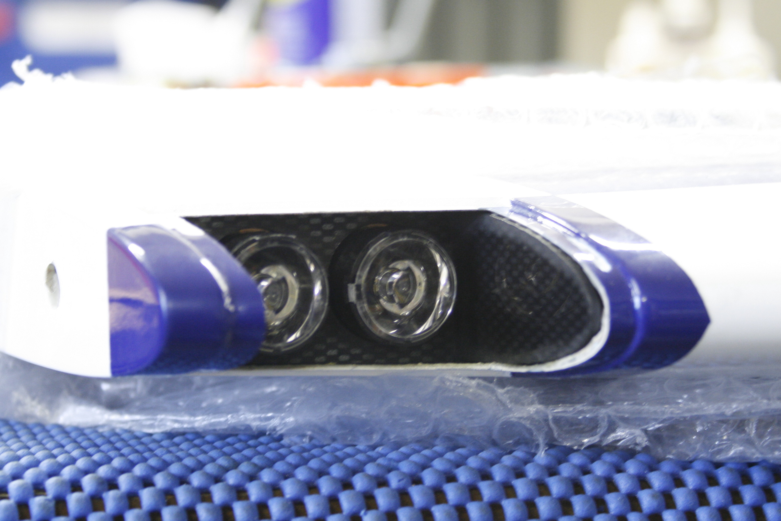

Hi Guys
finished today our super lumina set :-)
with over 90LM per side this MUST be the strongest lightset you can get...
lumen per watt lm/W ratio of luminous flux to radiant flux
so you give or take about 90 watts of power in one wing!!
power consumption : 350mAh per led give or take a 1500 mAh should provide a hour of light
Voltage needed 3,9 volts
the set i made contains 4 leds 6 lasercutted fake carbon plates.
as you can see on the pics it does look nice and clean
there will be a 3 wire servo cable attached with positve in the middle and the 2 leds fed by 2 x negative , so you can use 2 lights or 4 at a time.
example :
normal flight 2 leds , left and right
landing : all 4 leds
we are also working on a Front oleo landing light cut from 28ST alluminium , but this will be done right after we finisch the oleo,s...
so even if you are a scottsman you can afford this light set..
it is NOT possible to show you a decent picture when the lights are on , my camera goes bazurk and doubles the image.
and that is even when NOT pointing strait into the beam!

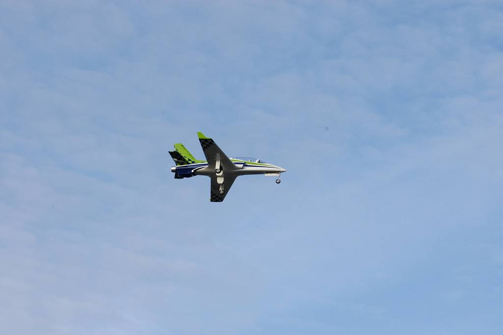

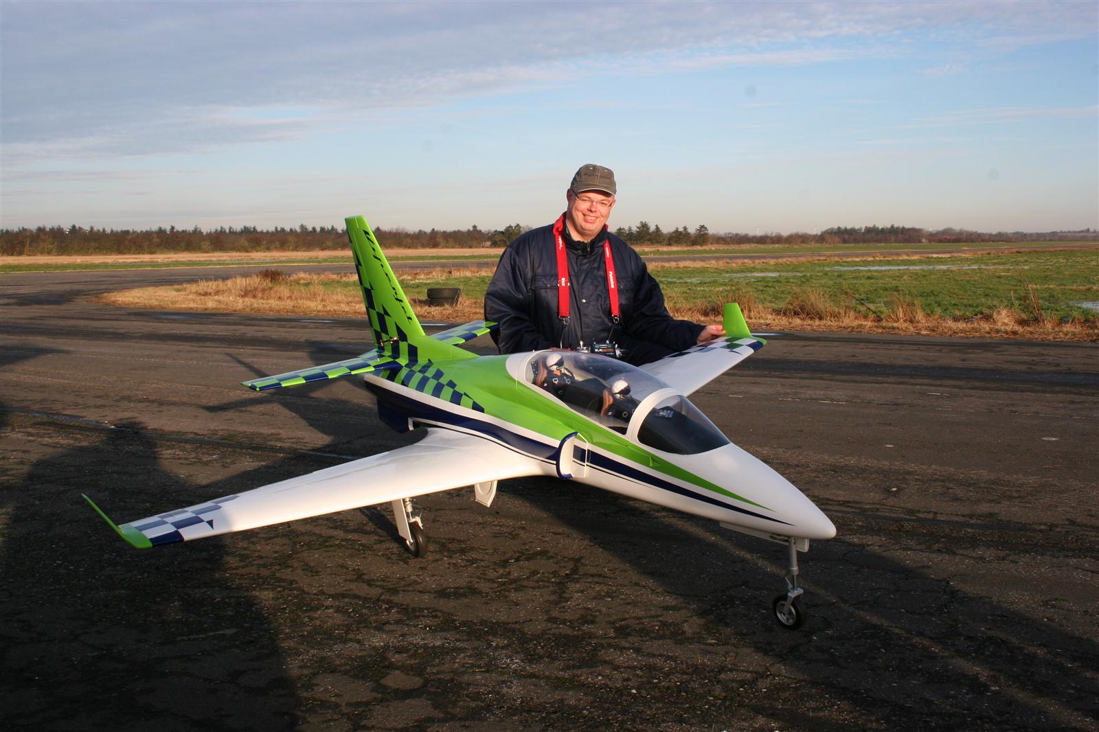

I was out today doing the maiden of my Viperjet!
Yihaa, that is one nice plane, it flies so nice and true, a real blast !
The P200SX is sick power, it gives the plane great authority, you never have the feeling that you need more power, you have all you could ever want!
Verticals, well, they are vertical (Hill climbing to some [8D])
Both landings were perfect, got it down real slow, and had a very limited roolup before full stop, lands just as easy as my Elan does (and looks a lot better )

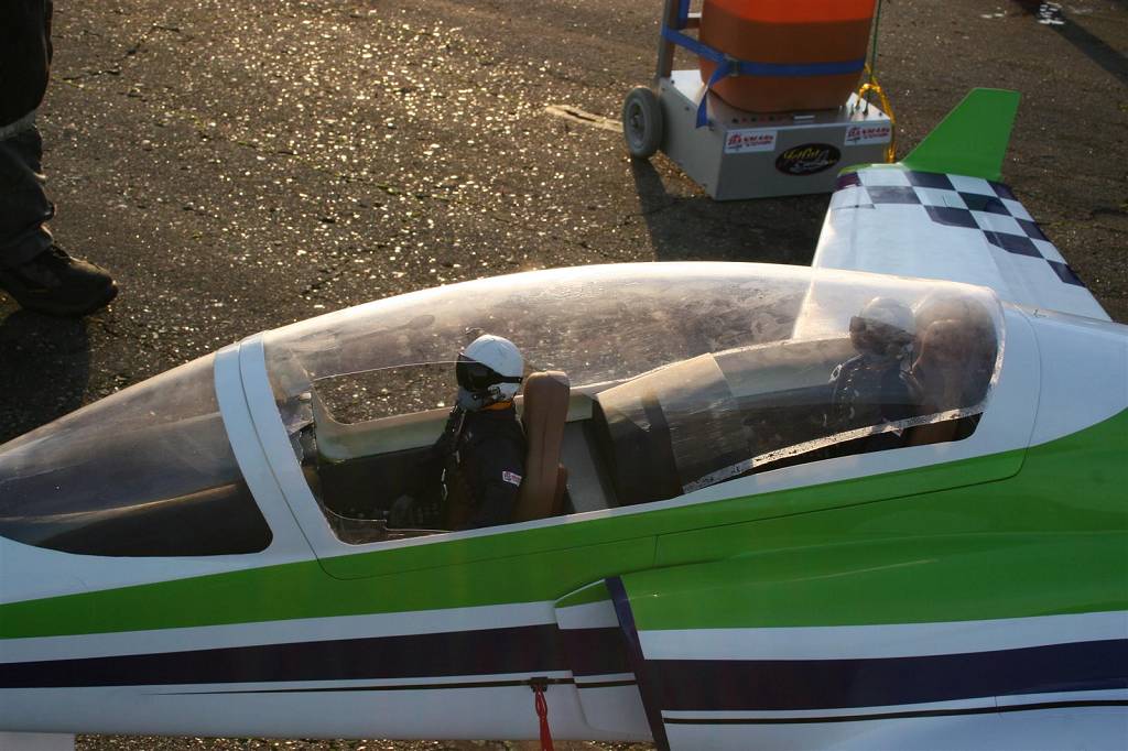

I got two flights on it, sometime during the second flight, half of the canopy blew off!
I might have been the bad glue, I don't know, but please make sure to add extra on yours !
I didn't even notice it in flight that it was missing, it was first after landing I noticed it.
Guidance is with a Futaba 14MZ and Weatronic 12-22 receiver
I used the settings from the manual, only difference was I went with +/- 20 mm on the ailerons (30% exponential on all surfaces), flaps was 15 and 45 degrees, with 3% downtrim at 15deg flap, and 6% downtrim on 45 deg flaps (as previously noted).
CG was set at 240 mm.
I'm a VERY happy camper, that now NEEDS A NEW CANOPY GLASS, SANDOR ARE YOU LISTENING
You look a happy Chappy! Congrats on a successful day. You sure you didnt have a bird strike!! Bloody hell that looks like a Albatross went through that!! Well at least its only a canopy to sort out.
Sandor the lights and install look good.

Thanks H,
birdstrike, hmmm, I don't think so, I didn't see any birds, and there were no "remains" on the plane
