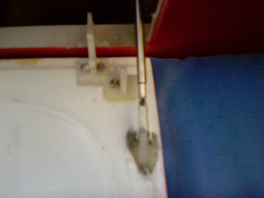

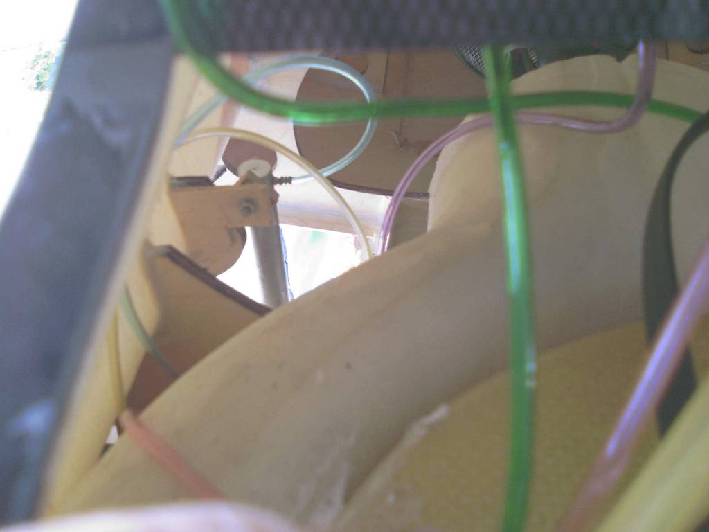

Here is the mod I have done to stop the gear doors opening. I used a Robart 165L cylinder, 3/8ths diameter by 2.5 inch stroke. I used a cut down plastic aileron horn which has three mounting holes as the fixture to the door. It is bolted on & also epoxied. The cylinder has a clevis attached. The distance from the clevis pin to the inner edge of the door is one & seven eigths of an inch. The top of the cylinder is mounted on a short extension level with the top edge of the existing cylinder mount. The cylinder is almost vertical to the door when closed.
In a test at 80psi the door on the unmodified side opened with just a touch of a finger. On the modified side, I would have broken the door if I had pushed any harder. This setup gives great mechanical advantage. The operation of the retract sequence is smooth & the cylinder does not interfere with the wheel going up & down.
Sorry about the quality of the photos. I used my phone camera.

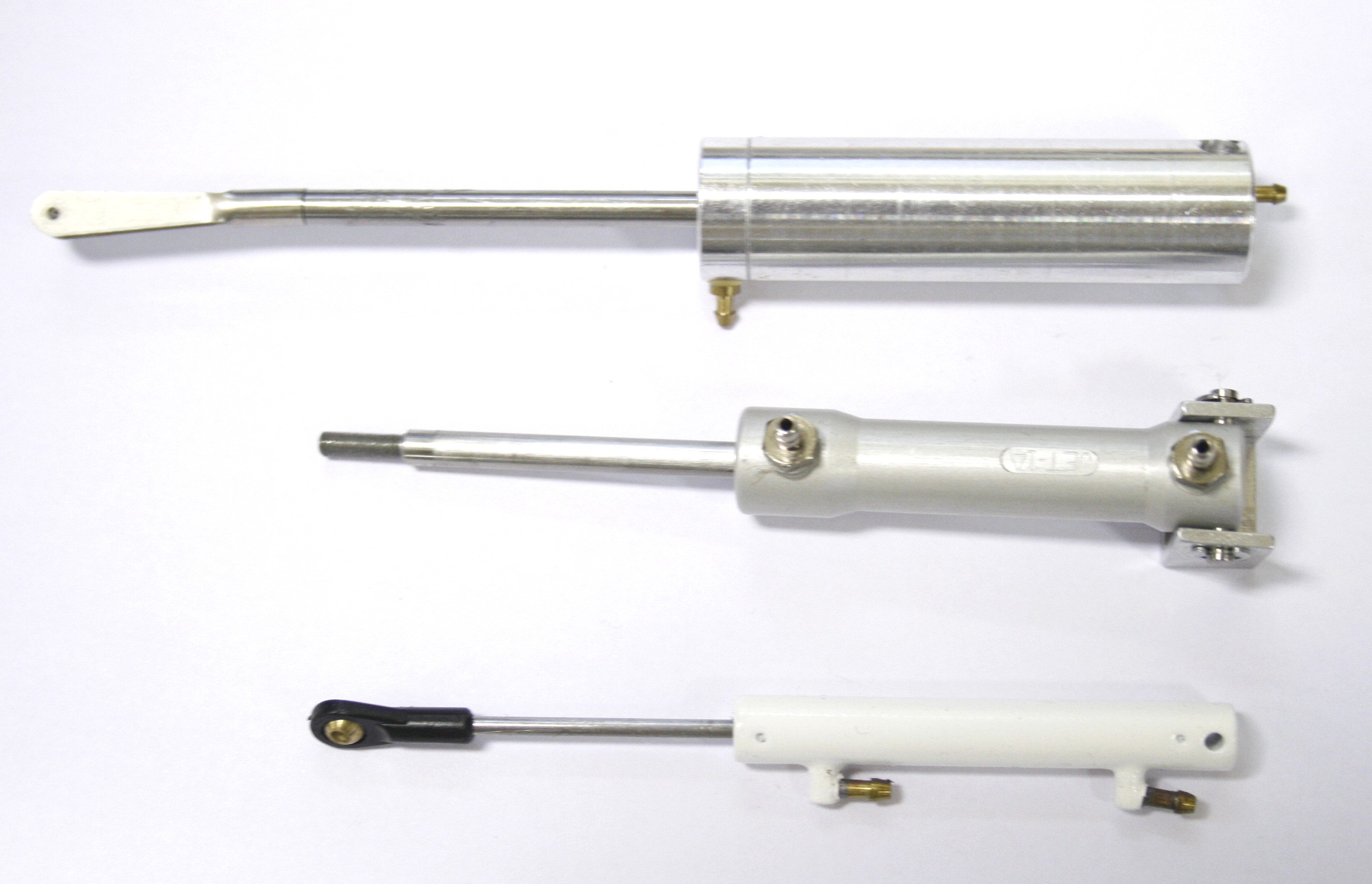

ok boss , found them ...
as you can see : original , jet-1a (they dont make them anymore) , "Big joe"
i tried the jet-1a also on my nice flying hawk , but the doors also always opened.
now "Big joe" should work..

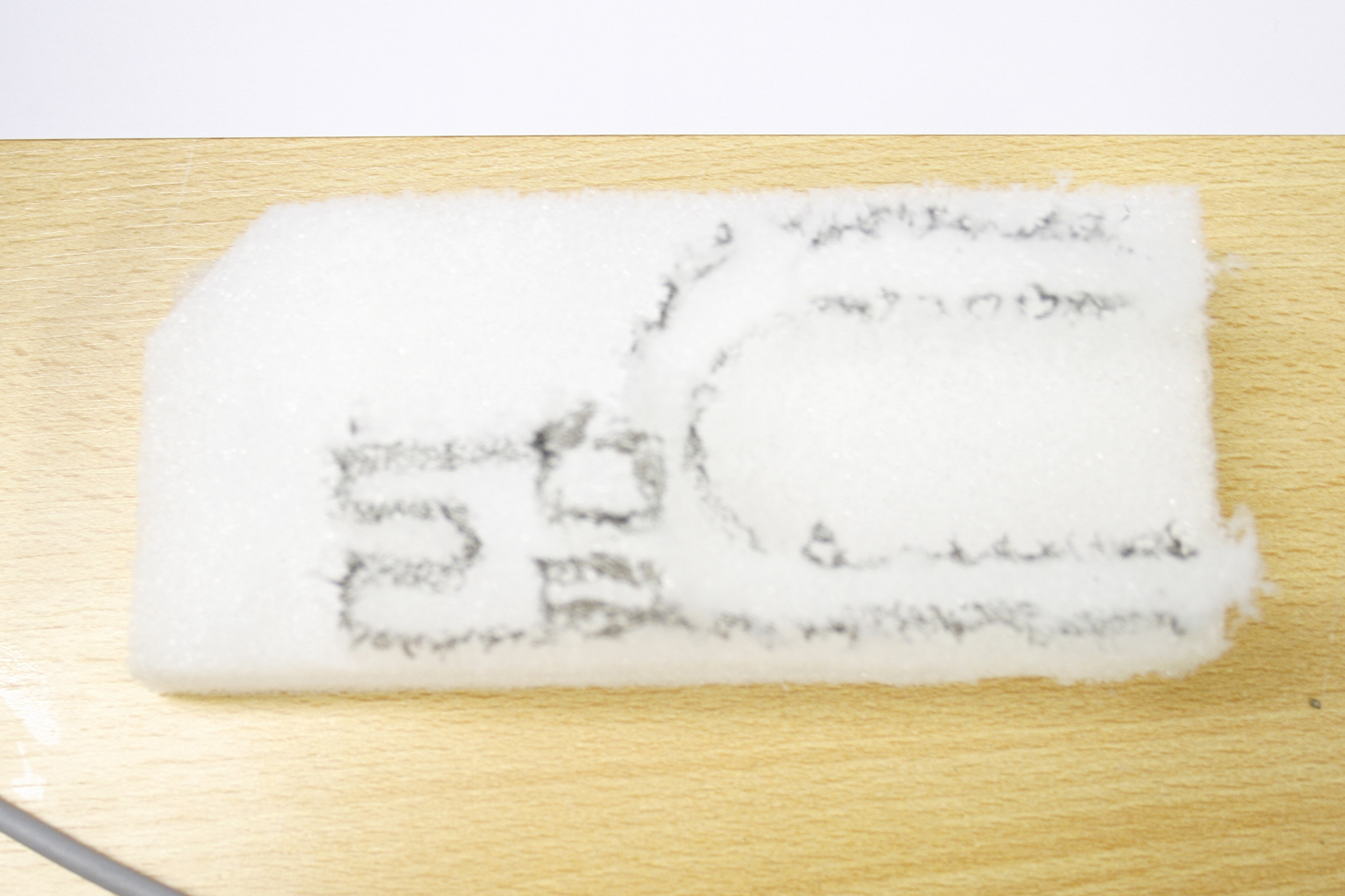

more news from the landing gear:
we are working now for a few weeks on the new oleo,s for the Viper
we finnaly agreed here what they are and how they should work..
here is a first "prototype"of foam (we dont want to waste a nice block of 7075 do we)
we expect to have some ready in late december.
the problem was the lenght and still keep our unique design intact , i think we got it..
