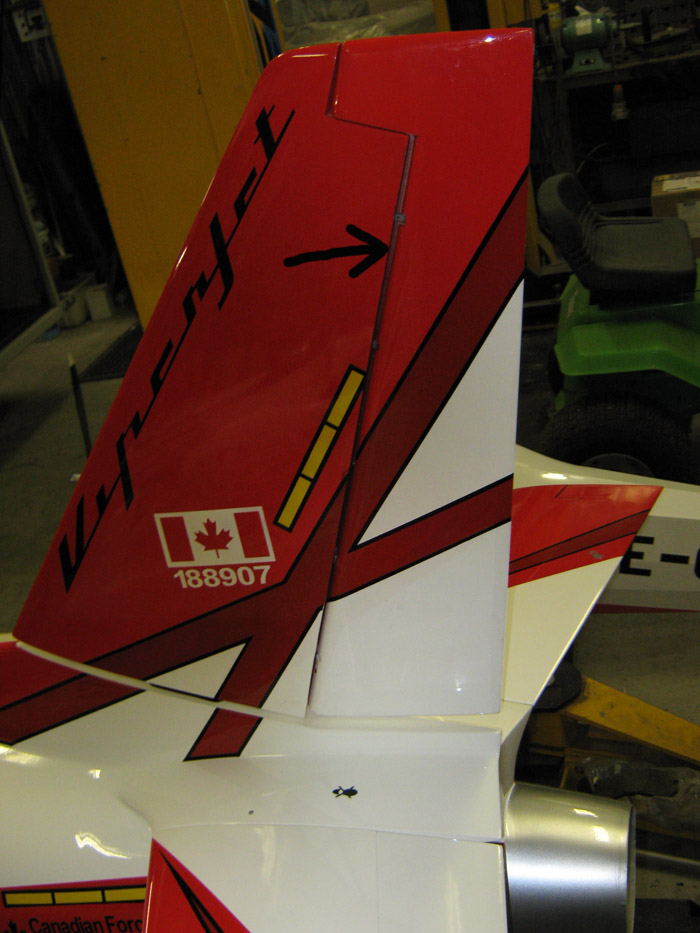

I recieved my Viper approx 6 weeks ago and have not seen this posted before there is a blind nut in the fin approx 25mm from the front carbon post and also a corasponding hole in the fuse the photo and the arrows should be self explanitory this provides 2 hold down points and makes the rudder very solid it is not mentioned in any instructions ( this may be a new mod)
Also if you trim approx 2 mm off the trailing edge of the fin as per arrow at the hinge line you do not need to use mounting blocks for the hinges as the hinge centre point is corect and all the paint lines line up. hope for those that are interested the photos are self exsplanitory.
Cheers Bronte

Hi Bronte. This is a new mod. Skymaster will be constantly improving the Viper based on the experiences of us who fly them. I am sure the gear doors will also soon have modified cylinders. Enjoy your Viper,It is a winner.
Regards
Jim

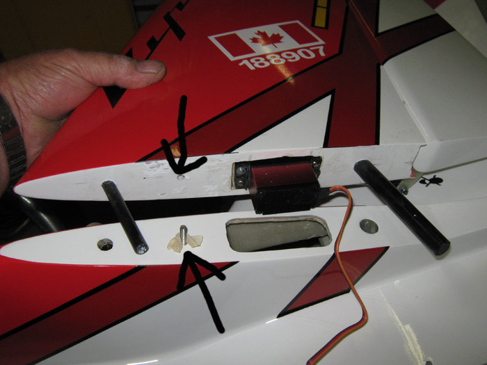

Bronte, I received my Viperjet at the JepPower fair in september. The T nut was also on mine, makes the vertical sit very secure!
However, the trick with removing 2mm on the lip at the rudder, would not help me, I had to mount blocks of varying thickness to align the rudder correctly to the fin, otherwise the top "horizontal part" of the rudder would not "lay flat" on top of the vertial stabilizer.
But, whatever you do, make sure there is wood inside the surfaces for the horns! The last 3 we have here in Denmark had none (or only some), and glue that canopy glass securely, and don't trust the chinese glue used

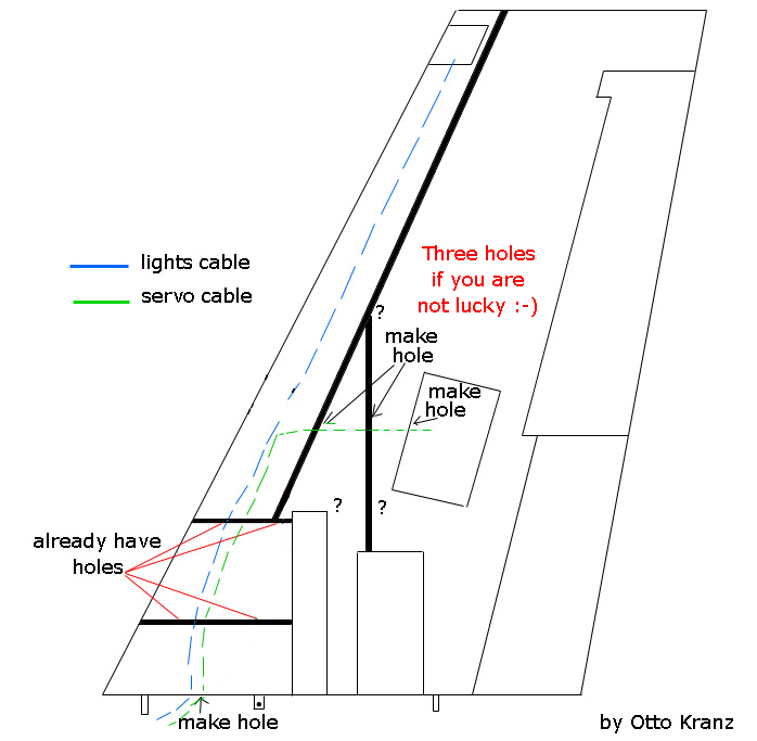

finally I found a way through the wing for the lights and servo cable. As I thought the passage for the lights was simple but for the servo wires I had to use a little chain (no way in other ways) because in my Viper (we all know they are not all equal) there is a very tiny passage on the middle of the wing.
I have done a scheme hoping it will help[sm=thumbs_up.gif]
The question marks are "obscure lands"
Ciao

I didn't have that hole, I made a small hole right after the wing-tube to reach the leading-edge area.
Who know what my second wing will bring

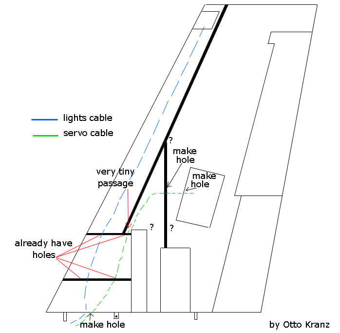

Perhaps you will be lucky on the other wing.
Obviously I spoke too soon
. I didn't found [sm=what_smile.gif] the "tiny passage" in the second wing and I had to do a third hole. So here it is the "unlucky scheme"
Ciao

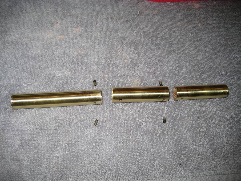

Guys,
I built the following tool to make the holes.... it work so so nice almost like cutting a cake! I call it the retractable cutting tool. I made it of brass tube and shape the cutter with my dremel. My good friend John Dento gave me some insight of how to do it!!! Thank you John!!!
First you use the first part with the cutter and cut the wall of the servo box. You attached the second tube extension via the 3mm screws and cut the next former. Now you attached the 3rd extension and cut the last former. Then you use the fishing method and you are ready to pass the servo wires as well as retract tubes and break line! super nice!!! The first former is the one that it takes some time.... the last former is very thin.... piece of cake. Nothing to worry structually as the former are quite big for the size of the holes. I would love for SM to put the holes as I did. I didn't like the idea of the retract lines, break line and servo wires to go so close to the retracts.... now, I am happy!... second wing coming up.
Enjoy the pictures,
Gonzalo

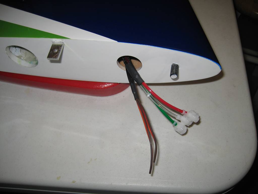

I didn't like the idea of the retract lines, break and servo wires to go so close to the retracts.... now I am happy!
