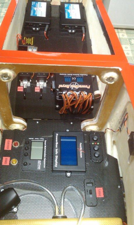

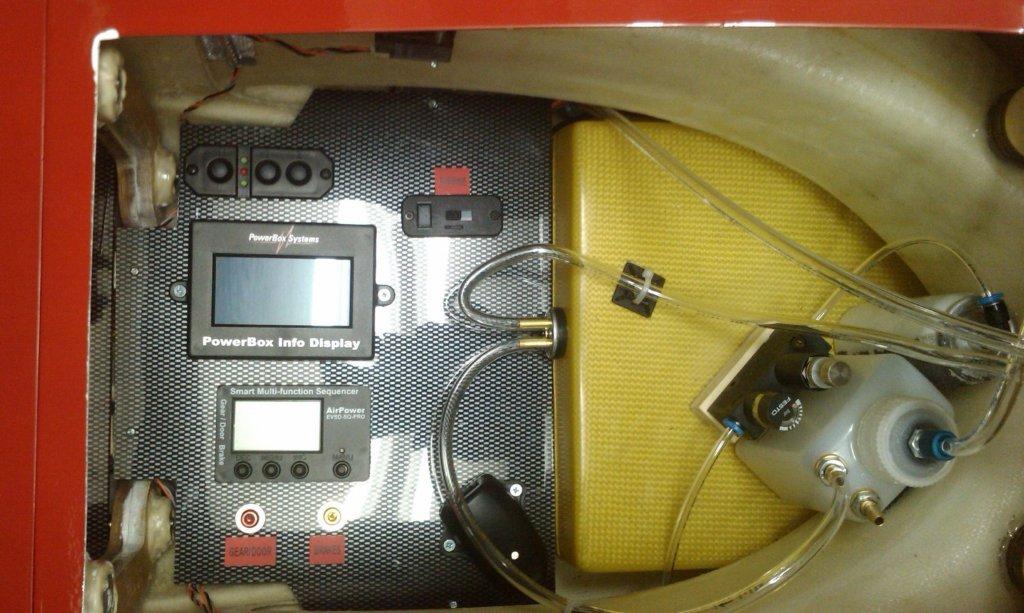

The same way like i already showed on page 31.
When i take away the rear cockpit i can see everything.
Regards Ron

how is everyone securing their lipos in the nose?? i can see Ron has them on the front radio tray, but mine are going right up front

Dunc, just some tie-wraps to the wooden frame (and some foam in between)
Works for me.

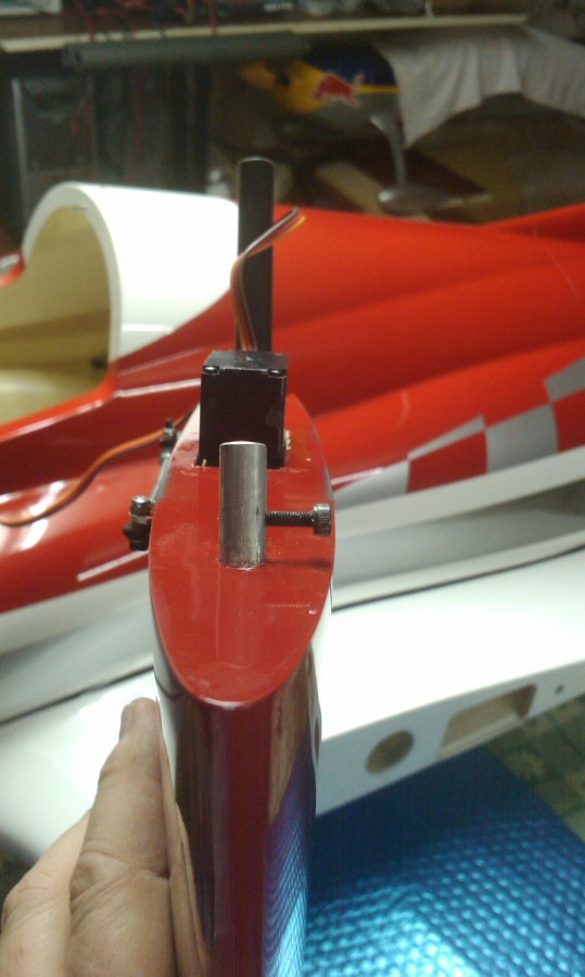

There is the normal carbon tube on the rear of the fin and i had a aluminium tube in the front.
Then i pushed the fin on its place, drilled a hole in the fuselage into the alu tube for the extra bolt.
For the rear carbon tube i also drilled a hole in the fuselage.
Now i can easely screw/unscrew the two bolts when fin is on its place.
Regards Ron

Thanks Ron,
I have a carbon rod in the front (IIRC), but maybe the same idea can be used for me also.
I also drilled a hole just below the horz. stabilizer for the clamp-screw, that one is easy enough to get to, but I'm more worried of the front screw if that will be ok to screw that one into the carbon rod in mine ?
(Are there any "meat" around the front rod so the screw has something around it ?)

what you can do is drill a hole into the carbon rod.
then use the purple zap , it will be "sucked"into the carbon cloth inside.
then use a Thread tap to make thread and it should hold for a very long time.

what Sandor told is the same way i would do it.[sm=thumbs_up.gif]
we have done this many times.
Ron.

what i forgot to tell you, yes on my viper was enough meat around the front rod (epxoy and wood)
