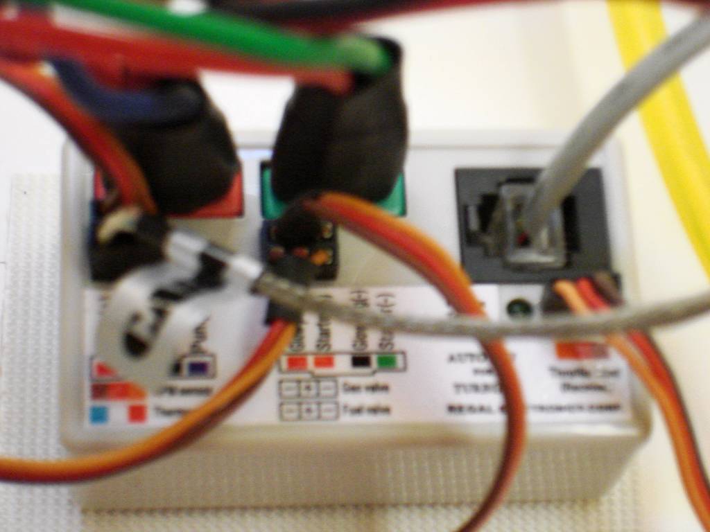

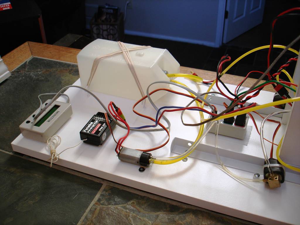

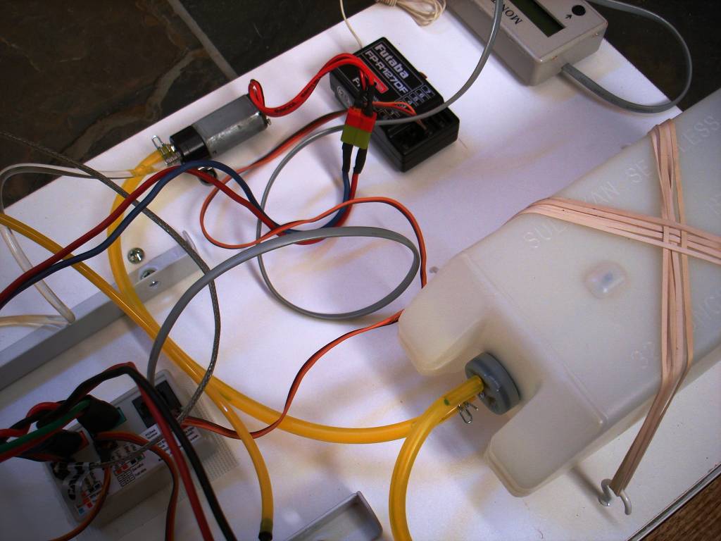

Help! I bought a JJ-1400 as a side project. I have it setup on a test bench and receive an error when performing the following steps:
1. Fill Tank with Kerosene & 5% Aeroshell 500 Turbine Oil.
2. Fill Starter Gas tank with Powermax.
3. Turn on Transmitter.
4. Turn on Receiver & ECU.
5. Advance Throttle Trim to Full UP.
6. Green light is displayed on ECU.
7. Advance Throttle Stick to Full UP and then Full DOWN to begin start sequence.
8. The fuel pump starts for about seconds. (Fuel line is filled with fuel)
9. GSU handheld shows glow plug test. (Passed)
10. GSU displays the error (BadStart).
Nothing else happens. No action from the starter motor, fuel or gas solenoids.
Any ideas?
FYI - This is the JJ-1400 full auto start with flightworks fuel pump.

Post a pic of your wiring that shows the connections to the ECU as well as the pump and starter, you sequence of events does not sound right, also when you state that you are filling the fuel tank with kerosene an then 5% oil, I assume your oil and fuel where previously mixed in the correct ratio, right?

I uploaded photos to the original post. I triple checked that I have the following connections correct on the Regal ECU:
Fuel Solenoid > Fuel Port on ECU (Per instructions, plug orientation does not matter)
Gas Solenoid > Gas Port on ECU (Per instructions, plug orientation does not matter)
Thermocouple > Thermocouple Port on ECU (Red to Red, Blue to Blue)
Fuel Pump > Fuel Pump wires on ECU
Starter > Starter wires on ECU
Glow Plug > Glow Plug wires on ECU
Battery > Battery wires on ECU
Throttle > Channel 3 (Reversed) on Futaba Receiver
Receiver Battery > Battery Port on Futaba Receiver
I purchase this from another user on Ebay and have had troubles getting started. Two weeks ago, I had everything setup and the ECU fried. Turned out I had the JR type throttle lead plugged into the futaba receiver with the wrong orientation (polarity reversed). I ordered a new ECU. This new ECU has allowed me to align the transmitter and partially begin the start sequence. I can only:
Test the Glow Plug
Prime the Engine
Hope this helps!

Just to double check to see if the ecu markings are infact correct. I would try swapping the glow and starter wires to see if that fixes the issue.

I checked the ECU connections and they are good. When I manually spin the turbine, RPMs register on the handheld unit. When I apply hot air to the end of the thermocoupler, the increase in degrees is also registered on the handheld unit. The turbine spins freely with no significant issues. I removed the starter motor and attached a battery source and the motor ran at a high speed. I re-assembled the starter and tried another start. The fuel pump comes on for a few seconds and then the starter motor begins to spin very slowly and appears to strain the electic motor. At this point, it stops and the display either says "BadStart" or "Low Batt". The battery is a new LIPO, fully charged. Note - I did not have the propane tank full of powermax when I tried this!
Chris

The ECU glowplug and starter wires are color coded and reverse plugged so that it is impossibe to switch them without cutting and re-soldering plugs. Since the "priming" process works and responds appropriately, I think it is something else.

Here is what happens:
1. I trigger the start sequence.
2. I hear a high pitch tone for 1-2 seconds.
3. The starter motor and the fuel pump simultaneously turn on for about 3-4 seconds. During this 3-4 seconds, the starter is turning the turbine wheel very slowly.
4. Everything stops and the handheld GSU displays "BadStart".
Hope this helps clarify things!

Open up the shrink tubing on the starter/pump connector that goes into the ECU, if possible post a pic of the connections after you remove the covering, the behavior you describe seems like a short circuit between the pump and the starter, do not try any more starts until you check the connections to be correct to your ECU connection labels, you could burn out the mosfets on the pump/starter speed controls

If you read this post before editing, disregard my comments, your connections are not the standard type, validate all your connections from the ECU are correct on both graupner (6 prong) plugs

OK, now stop for a minute to do some checking, first, is the ECU you bought exactly the same as the one that burned? I see that the ECU you have is not the same as the previous ver sion from JJ, also, thelebeling is different did you get a new wiring harness with this new ECU? if you did get a new harness, did you solder it yourself? was the turbine ever run with the old ECU?
