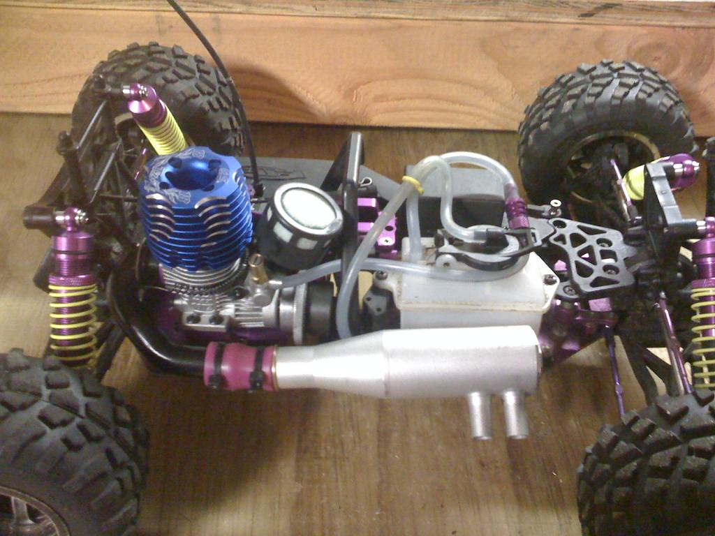

here are the pics. I must have mis-read something, I thought this was a direct bolt-in mod when using the specified mounts. the last pic shows how the mounts sit on the chassis when the mesh is in place.

I used the Redcat Racing alloy mounts on mine and it worked fine. I had to widen the holes left to right to get the gear mesh right but they line up the other way.

Actually do you have the spur gear installed in the right direction?

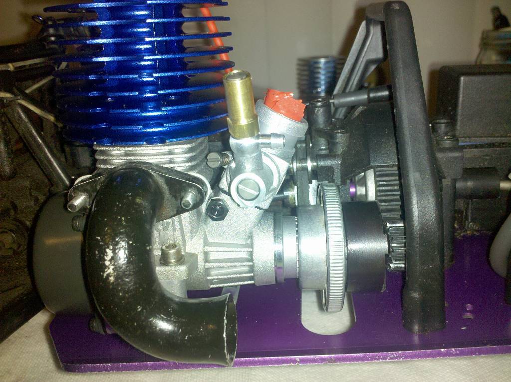

If you zoom in on this picture you should be able to see the engine mount

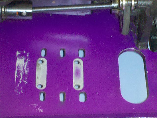

I wonder if i have an older chassis with different mounting holes. I got the truck used and it had the .15 engine. I believe the spur gear is correct because it meshed correctly when the .15 was in there.

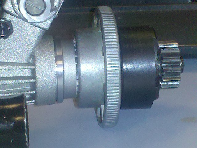

When i looked closely at your picture, i see that the flywheel is mounted closest to the crankcase front bearing....on my engine there is this spacer (as seen in picture) that separates the crankcase from the back of the flywheel. is this spacer necessary? having it on leaves very little space for the clutch pilotnut to grab the crankshaft. i am about to try to take it off and see if the holes line up correctly after that.

edit: it doesnt work without the spacer between the crankcase and the flywheel. If it is taken out, then the pilot nut cannot screw far enough down on the crankshaft to put the clutch shoes on properly.
How can i tell if the spur gear is possibly in the wrong position, my slipper pad is to the rear of the spur gear. is that the right side.

Glad the info was useful Savagebane.
That spacer you have between the flywheel and bearing isn't used, you have to take it out....it is the "Drive Hub" item number 10 in the engine parts book. (that is usually useless for cars because it is really a propeller hub) Did you put a collet on?
This is what you want on the engine shaft after it is all bare and you only have the crank showing: (no "drive hub" or anything):
Going out starting from the engine bearing:
HPI washer: Z699, collet 86022, flywheel 86021, pilot nut A805, then put on your springs/clutch shoes, then HPI washer Z694 (not Z699 make sure), clutch bell of your choice, then HPI spacer Z845 and then HPI screw Z541 with threadlock.
That was all taken from page 21 of my MT2 SS manual and it all should line up at least if your spur assembly is good and your chassis matches either the MT2 SS, MT2 SS+, or MT2 G3.0 RTR. I don't know what chassis you have but if it is the same that is the exact setup you want on the engine.
Also the engine mount is the the following, it looks the same as the one KeithjV posted:

The engine mount you have looks the same as my much older now kit MT Racer - but that engine mount you have may or may not match the one I linked.

savage shoestring is right, that spacer has to come out. That will let the engine mounts line up with the holes. What type of pilot nut are you using?
