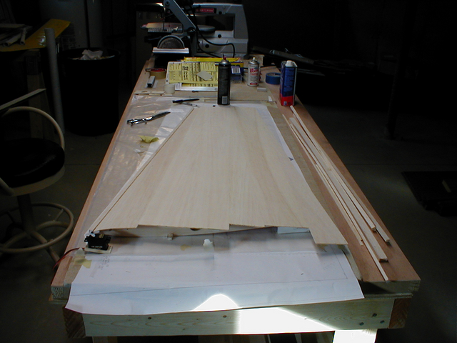

After trying the paper for sheeting the wings I don't think I will ever go back to using obechi veneer or balsa for my foam wings again. I like it that much. The paper for the wing weighted 68gr so even with the tube and sockets it is actually lighter than some of my .60 size wings.
I used 52gr of epoxy so I'm still using too much I think and need to find exactly the right amount to use so I can get it right every time.

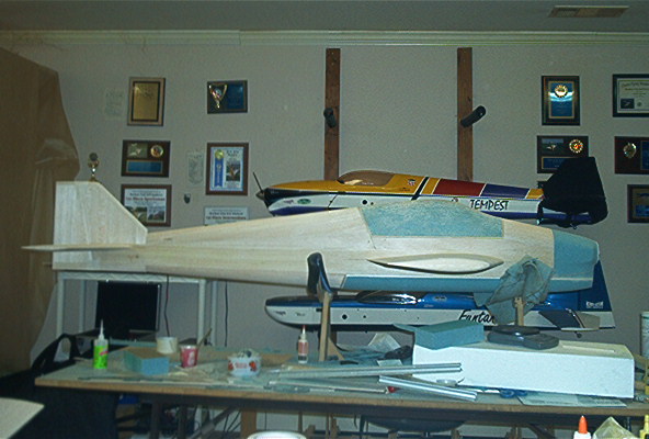

Well Mike, I got the rib installed right and have some photos to post...
I'm going to have a lot of sanding to do on that leading edge. I think next time I'll put the cap strip on, then sheet, sand and _THEN_ put on the leading edge and sand that. Its a great method, I just for some reason didn't do it and now I'm stuck with doing it on both wing halves.
Yup, my finger after joining the pieces for the sheeting...
So thats it for now, I'll see how it comes out tomorrow. Luckily I called Bokuda before doing the sheeting. I had, in hand, 30 minute epoxy while on the phone with him. He warned and suggested I get 2-3hr epoxy for the working time and thank god I did! It took far longer then I thought to get everything prepared for the sheeting, but with that 3hr epoxy I had plenty of time. I think its actually setting up now

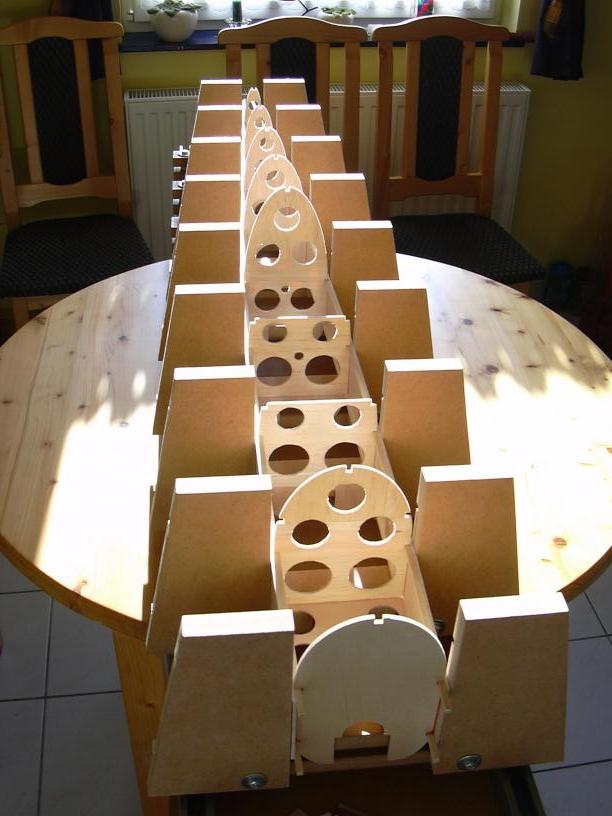

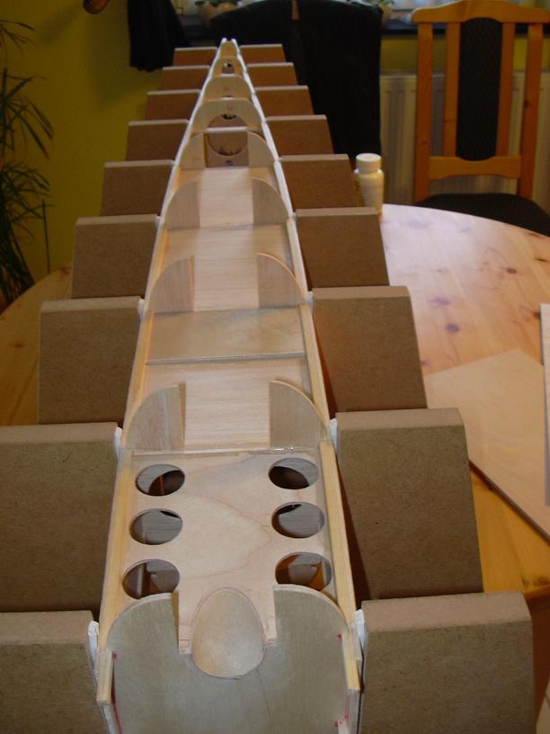

I've started to build the fuselage. I framed it up, glued the ribs and made the fuselage floor. Now I have a huge what's it to move around my house
, if we wish to eat -> to the bedroom, if I want to work on it -> to the hall. My next project will be a biger house or just a workshop (I don't have any [&o] ) I don't decided yet.

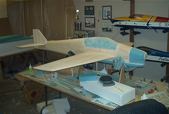

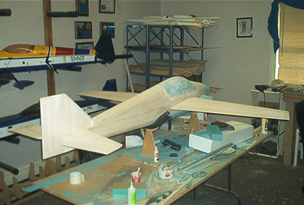

It worked out quite well, I'm happy with the results.
Theres a very small gap in the leading edge, I'm not too concerned about it since I thought it'd be worse. Other then that, all the ribs were glued very well to the sheeting without any gap. The magazines make a nice, even pressure on the wing and I didn't have it in me to put pins all over the thing. Next is the ailerons and servo box. I'm still a bit concerned about doing the ailerons as I don't think I have a whole concept of exactly how its done. I have marked the positions on each of the ribs, then I cut out that piece and glue in the trailing edge hinge block and the aileron hinge block? Then sand down the aileron leading edge at the planned angle...I hope thats right, cause thats how I think its supposed to work.
After this wing is done completely I'll do the other side, then back to the h.stab to finish that up as well.
I'll post the final result pics tomorrow.-Dave
