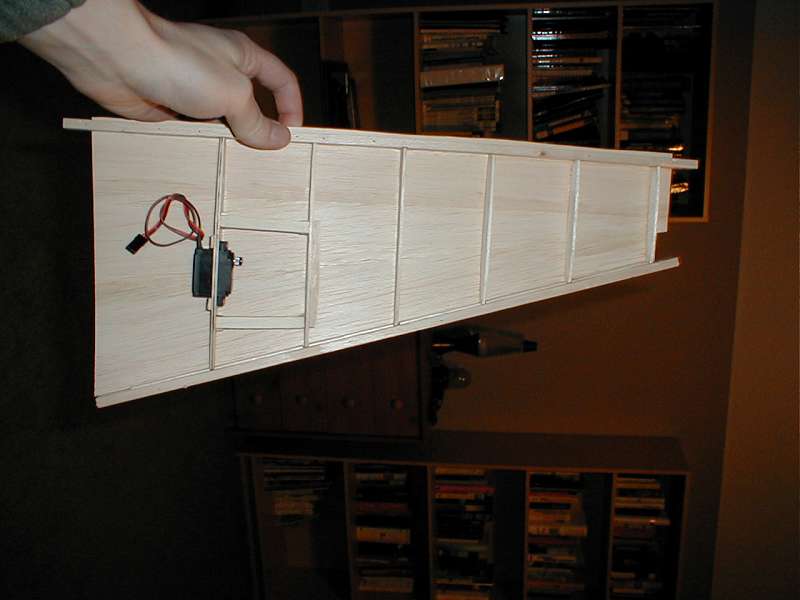

MTK, I've seen guys use tape, and its a good idea...but I don't care much at all about the glue on my finger. After doing a skin for a wing the glue has smoothed itself out and makes a nice spatula of sorts. Then after all that glue is built up it cracks (as shown) and peels right off. What doesnt is just sanded...yes sanded...off my finger. No pain at all, I swear.
-Dave
PS: Found out on of my stab halves was bent a bit so I tore it apart and redid, mostly thanks to a friend since I didn't want to build another one. The other half's leading edge broke while I was pulling pins. It was not a good day, to say the least, but I will have two halves done tonight and goddamnitalltohellandback they'll be straighter then an arrow, lemme tell you!
-Dave
