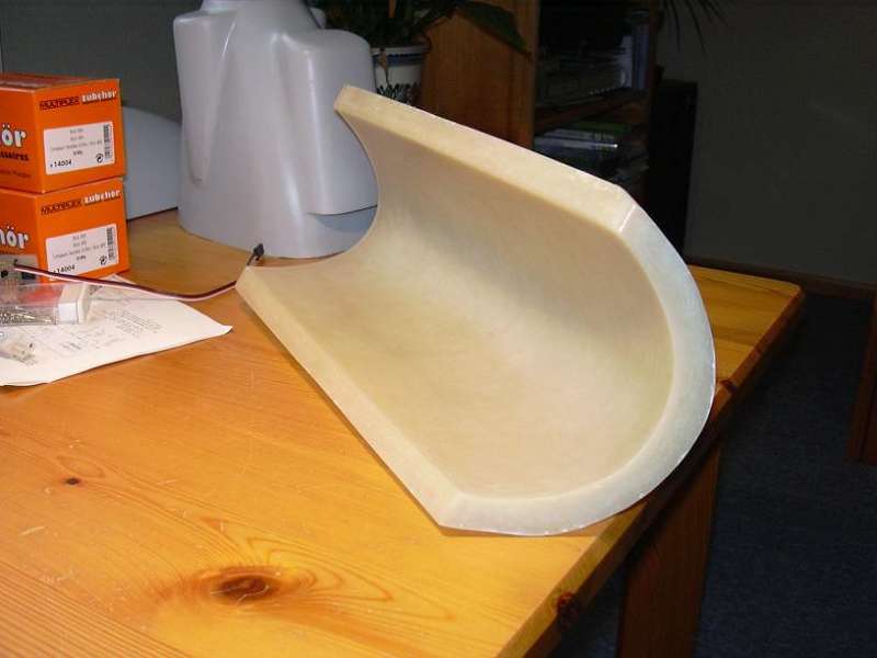

Here are some pics of the T2K "chin cowl". I will take some more detailed pics over the holidays. Hmm, we have to find a way to get some cheek molds, should´nt be a problem.

Here is the Mike´s Tempest, with the same chin cowl but finished fush. If you work your way back on this thread Mike posted some pics of the engine instalation, that will give you an idea. . .

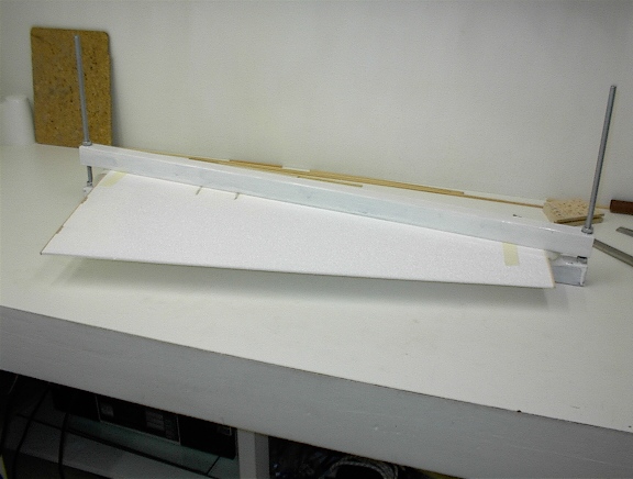

Cutting the Tempest wing turned out to be quite interesting because the big difference between the root and tip. Even when cutting at low temperature there is a danger of the wing tip melting a little, the wire is just mowing so slowly at the wing tip. To take care of that I made the tip template a little oversize. On this wing I will be using 85gr m2 paper for sheeting with 3x5mm hardwood spars.

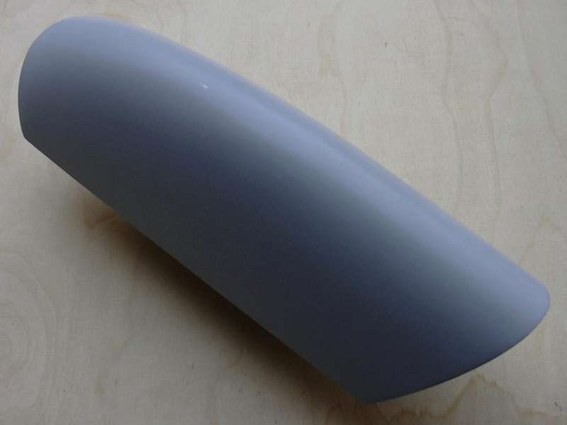

Yes, it works! So I made the moulds and all composite parts including landing gear, wing tube, tuned pipe because I can't see any chances to buy (I've read your experiencies with Gator, I've tried them without answer...) them and I like challanges
