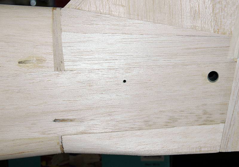

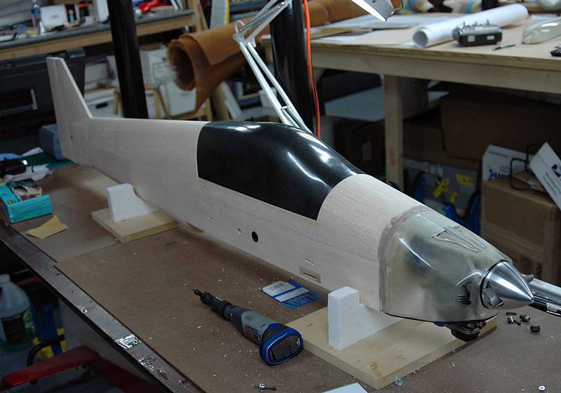

Hey All,
In an attempt to get this thread back on Black Magics (sorry Wendall)
Now that the season is over... and it was a great season of flying in D3, I think I did 8 or 9 comps this year. It was great to spend some time over the weekend working on my new plane. It's seems like its been months ?
I completed all the small things on my build and I am ready for filling and final sanding. Here are some detail pictures of my scoops, pushrod exits, fin fairing etc. I'll have the time in December to finish. I am leaning toward installing my new 160 DZ instead of a good 140L. After seeing this plane fly with the 18" props on the DZ, well it flies a lot like the electrics. Plus I would also have the 4-blade option.

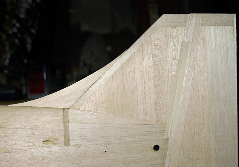

Handglider: Is your rudder larger in chord than shown on the plans?
Mike's instructions on this have me a bit puzzled. I think he is saying to increase the rudder chord,but I am not sure.
Thanks Both H.G.& Mike

Rudder question: No the rudder is about the same, you just add a piece of 1/4" as the tail post of the fin, which increases the chord of the whole thing by 1/4".

Hi Dave,
the rudder has the "stock plans" cord. I did add that curvy piece of balsa in front of the fin. I did trim the trailing edge a bit to thicken, my trailing edges are a little over 3/16" on elevators and rudder. That is a little thicker than the stock cores. You can see the extra piece of balsa at the hinge line of the rudder to maintain the length. I need to double check my length again. But I was about 1/4" short of 2M.
I am thinking I might add a curved piece of carbon lam behind the ducts to wrap the airflow downward along the firewall. The prototype plane that I am flying doesn't have the naca ducts and doesn't seem to have a cooling problem.
Anyhow the naca ducts just look really cool. and I like that fact that Mikes inspiration is from a '85 Z-28. It's fun filling in the ducts with epoxy /microballons. I need to do more sanding and a little more filling on te ducts, but they are looking great.
Well after the thanksgiving holiday, I'll be kicking up a balsa dust storm. Looking forward to getting paint on this beauty.
I guess I will be building two more planes this winter. I have another V2 kit and the Districts kit that I won to build/finish.
Dean

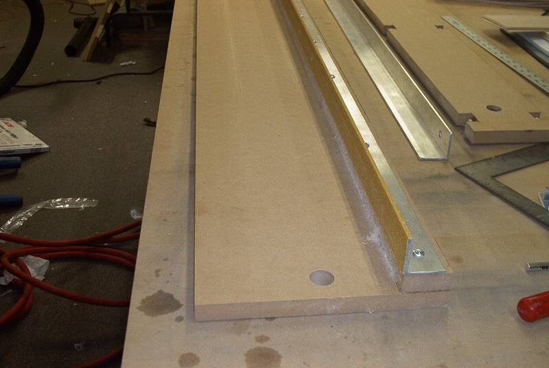

#847
Posts: 2,707
From: Woodstock, GA

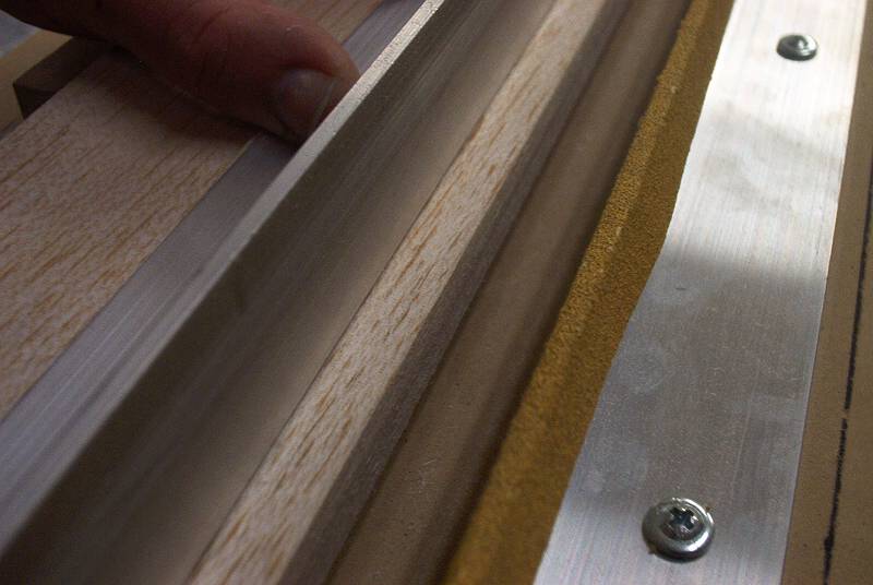

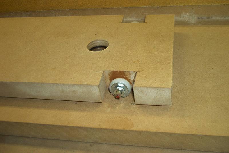

Here's a little present for ya.
If you're doing a good bit of sheeting, this is a really cool little tool and worth the time to put together. It's really quite simple so I won't go into TOO much detail.
If you're not doing a lot of sheeting, this may or may not be of use. but this sucker really helps to true up the edges of 1/16" sheeting before you join them.
All you need is a piece of 3/4" MDF board, cut to 50" long and 12" wide. Another strip is 2" wide and is secured to the board on it's edge. A length of 1 1/2" aluminum angle is then attached (using a straight edge to make sure it's straight). A piece of 80 grit stick on sandpapr run the entire length and you're all set for the piece that sits on the table.
The roller piece is a little more work. I made mine 40" long. I notched out 6 spots to accept shower door rollers that I got from Ace Hardware. I then drilled and tapped the notches in the center (low so the 3/4" roller actually sticks out and rolls). Then I inserted a piece of 8/32 all thread, hit it with some epoxy, and screwe on the roller. I added a lock nut to the outside.
Now all you have to do is stack the sheeting with it overhanging a small amount. I used another piece of angle with a piece of sandpaper on the bottom to keep the sheeting from slipping.
Now just apply a VERY small amount of pressure, and roll back and forth....voila, it trues up all of your sheeting for you in seconds.
I can't take credit for this one, I seem to remember one resembling this was sold a while back by Verne Koester? My memory might be hazy on this one. But I cought a glimpse of it and thought I could really use it. And MAN it has saved me some time!
I'll post more details if anyone is interested.
Have a Merry Christmas and make some dust, the 2007 season is just around the corner!
-Mike

#848
Posts: 630
From: Ossining,
NY
Hi Mike,
Slightly simpler way to do this although not as cool. I made my base from the a piece of the pre-finished 48" shelving available at the home center. Then just put the angle AL directly on its face. The shelving comes pre-covered with a formica-like substance that is slick enough to use with out making the roller.
Some times the piece on the bottom of the pile doesn't come out great but works well. Also, handy for squaring up formers!
