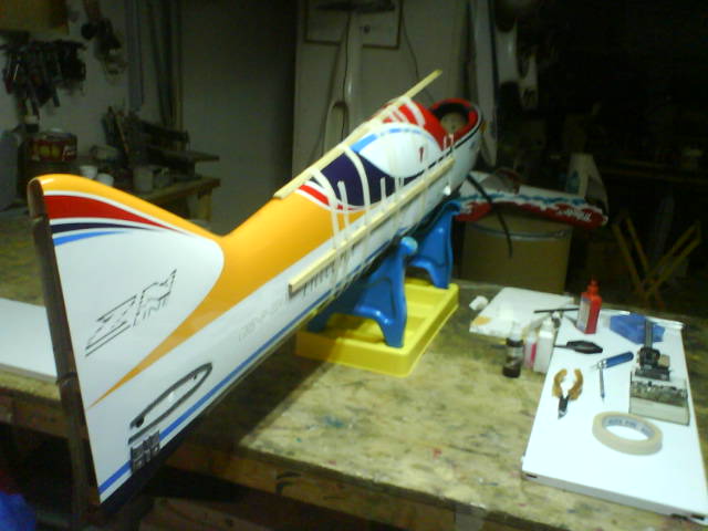

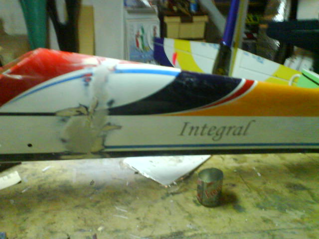

Hi there,
This is my A model for 2008, flew very nice had about 50 flights till I took off without re-fuelling and had a flame out low and at the end of the box, plane landed ok but hit a little plant and stalled half meter from the ground. Everything else is mint condition except the fuselage which had a crack, I could not believe it when I saw the cracked fuselage, that was two days before the Europeans in Italy.
Anyway now the fuselage has been aligned and glued, here is my friend (professional UAV builder) doing some work on it. The plane came very light with the extra glass, resins, filler etc. Now we have to repaint it, here is the new scheme.
Hope tha plane will fly as good as it was built.
Nikos

Great job Nikos, repair looks fantastic. Terribly disappointing when this type of thing happens, I'm glad you have it repaired now.

Yes it disappointing, but these things happen what can we do? In my honest opinion this was a structural failure but never mind. I thought of getting a new fuselage but I will test this first. Building a new fuselage is like building a new model and the cost of this part is rather high it is around 60% or more of the total kit price. Not worth it...
