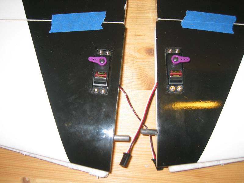

Hi Andreas
I am also assembling an Integral. It is a great winter activity.
You are right, F9650 is a bit bigger, than the place.
I usually use F 3150 at elevator(because of less slope), but it is too slim here so I have changed to F9650.
I had to refashion both elevator and servo, but it sits well now.
Here are some pics for your convenience:

I used Digital Hitec servos for elevator control in my first Integral they fit fine. In the second integral I didn't use servos in the Stab. I placed a single servo in the fuse just behind the fuel tank and used a dual pushrod system. The airplane balances much better that way.
Carl

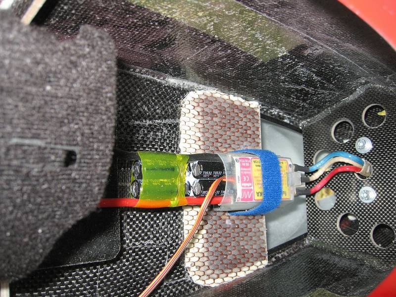

Hello,

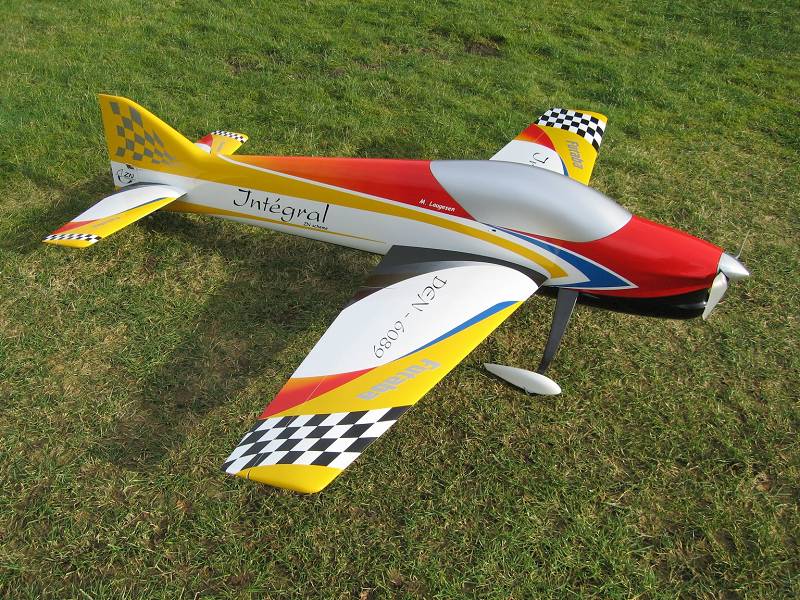

Well I finally finished my Integral and thought I would share a few photos of it. The completed weight of the airframe less battery is 3837 grams, so I have room for approx. 1160 grams of battery before going over the weight limit.
The setup is:
Motor: Plettenberg Xtra 30-10 EVO
ESC: Schulze future-32.80KA
Prop: APC-e 20x15
RX: Futaba R-5014 DPS G3
RX switch: PowerBox Digi-Switch
RX-battery: Kokam 620mAh, 7,4V LiPo
Rudder servo: Futaba S-9151
Elevator servos: Futaba S-9650
Aileron servos: Futaba S-9550
Battery: TP 5300 ProLite

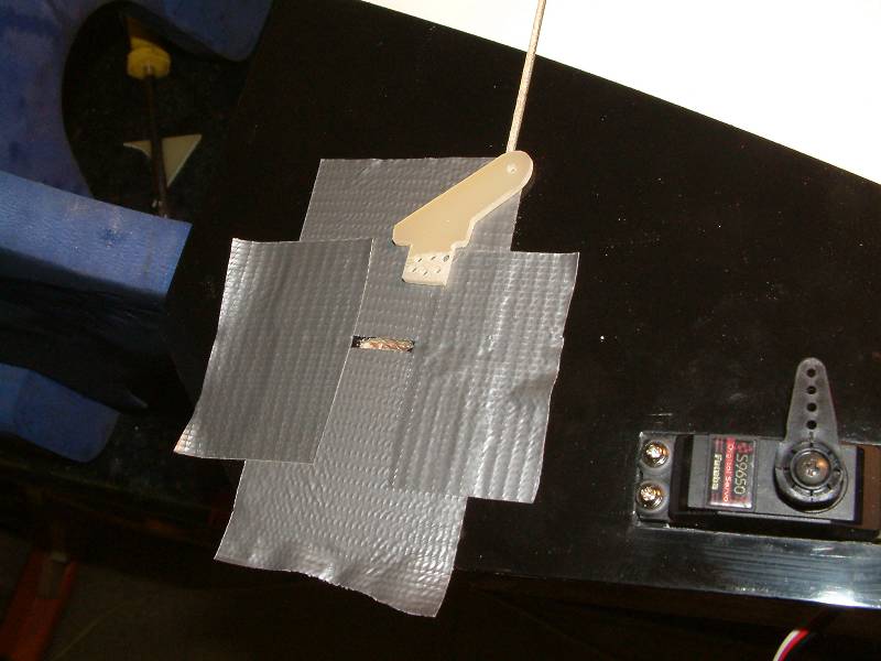

A friend recently completed his Comp-ARF Integral, and with an OS140RX it was nose heavy, even with elevator servos in the stab and receiver and battery at the rear of the canopy (ZN may be different).
Based on this, I would suggest a light spinner for sure.

I had to add lead to the firewall of mine to make it balance where I feel comfortable.
OS 1.40 Hyde mount Mueller header and Aeroslave pipe. Stab mounted Servos
185 mm back from the leading edge.
Carl

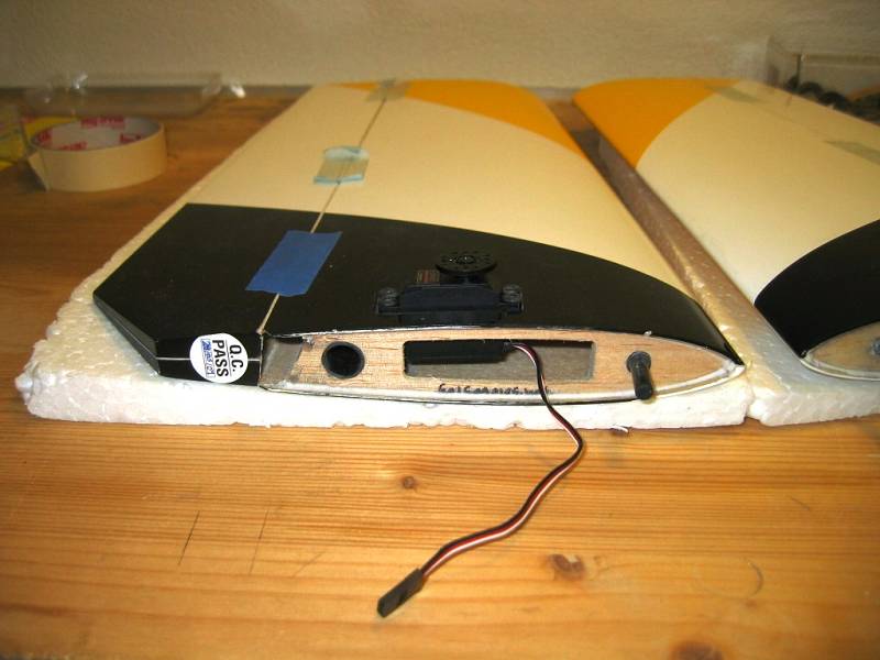

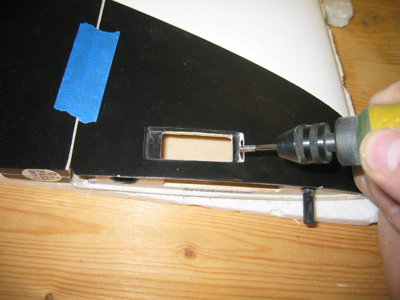

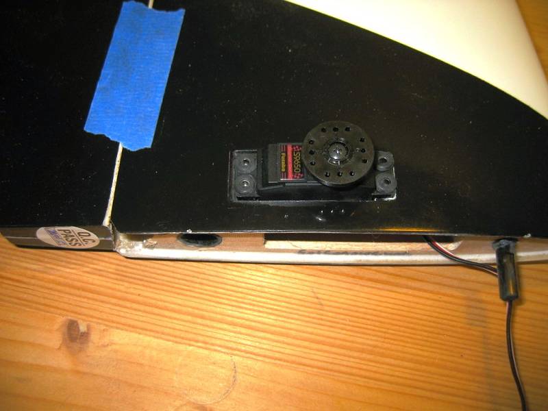

Please, can anyone help me.
I think the problem, I do not have alone. It is a common Problem.
I have made any fotos to show the Problem.
Foto 1 is the detail of the Balsa block. (is from manual). It shows the two holes and the center of the 30mm Balsa block.
Foto 2 shows the detail between the Servo arm and the ruder horn. The ruler shows the correct position of the ruderhorn. But there is no balsa block. only air in the inside. Foto 3 shows the difference 23 mm. Is this a joke fron composite. On Foto 4 shows the detail when I should install the ruderhorn. This is absolutly false. This is shi.....
Nobody make a ruderhorn of 30 - 35 mm. This is absolut false. My only idea is Dremel or Proxxon. Have anyone a Tipp for me. What can I do. And have anyone the E-Mail from Mr. Composite (Andreas Gietz).
Never with me. I hope I will see Mr. Zardini at Italy.
I'm angry, really angry.

You didnt have to put the horn in the centre of the balsa block, if you put it near the inside edge its fine.
Why are you showing the centre hole of the servo horn as a reference point, surely taking you measurements from the outer hole would cause less of a headache?
Also what your pictures are showing is not a rudder horn but a aileron i believe.
You could use a longer servo arm as Jason Shulman did, have a look at post number 83
Good luck.

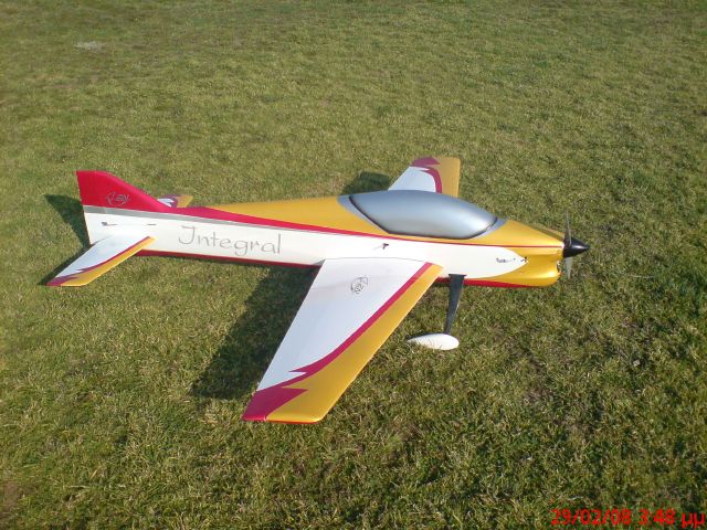

Hello i just finished my INTEGRAL and make a couple of flights.
All up weight 4550gr, CG 195mm from the leading edge.
