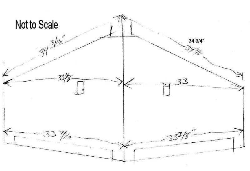

Well I have built up my Exceleron 90 wing now and just test fitted it to the fuse, E-Dave since you have recently been at this stage, did you measure the distance from TE tip to the center point at the tail? If so did you get equal measurements?
Mine are not and I am on hold for the moment. I'm a good 5/16" off and this bothers me big time. I tried measuring from other reference points on the wing, such as the tips of the ailerons and the corner pockets of the ailerons and come up the same.
My Root ribs are dead on so this makes it more frustratiing. The fuse is straight to!
I'm talking to global about it now, and possibly having to build up another wing, although I did check the wing for squreness to and it was OK, realy preplexing.

#36
see attchment drawing
I'm prety sure this would require me to cut the wing and then fill the short panel at the root rib.
Not a task that I am setup to do. I definetly learned something here, Measure the wing panels before joining them.
It would have been a piece of cake to laminate a piece to the short panel and make then even. [:@][:@][:@]

That's amazing. What A stroke of bad luck for you.
I've followed,participated in every thread on the Explorer/Excelleron I've found and don't remember anyone have this problem.
I have alwasy held the wing panels of a new ARF together side-by-side while aprecaiting the build quality. I didn't have a reason for it but realise now It's a good idea as I would discover a difference in length immediately by doing so. Sorry I know that doesn't help you in any way
Just a thought but would extending the wingtip of the short panel help. It would be much easier than cutting the wing in half.
I think if it was me, I would just relocate the existing wing cenetered on the fuse and fly it.

Well since thoose measurements are so small I have decided to ignore the root rib seem and measure the wing as a whole, and reference it that way, this means I have to slightly relocate the dowles pins and the rear mounting holes. If it presents a problem in flight that can not be corrected then a new wing will be fitted.

Built my excelleron last summer. Had the EXACT same problem. There is no simple fix, so I pretty much put the wing "square" in the saddle and accepted slightly different wing tip-to-tail lengths. Did not appear to effect flight trim. Good luck.

ORIGINAL: MikeRuth

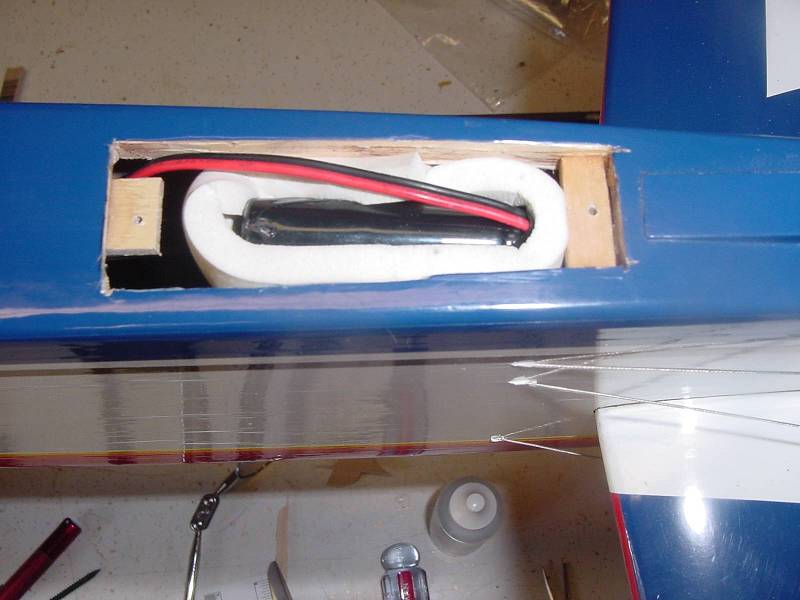

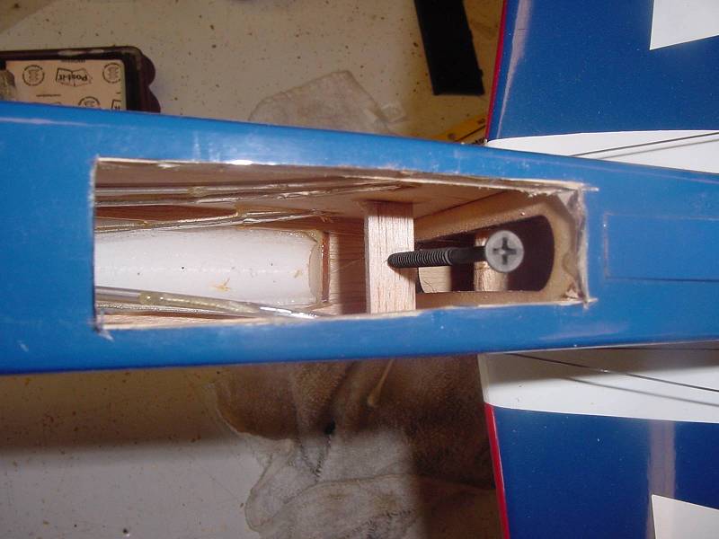

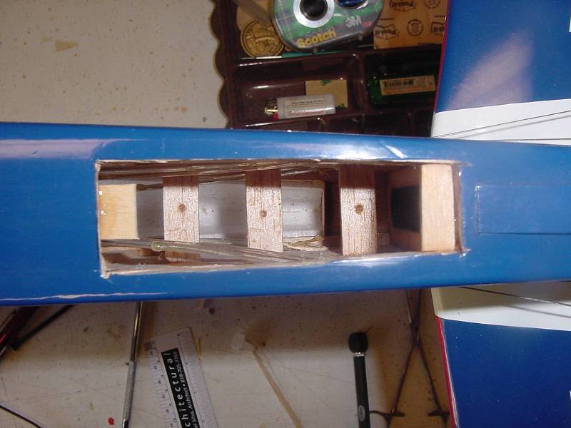

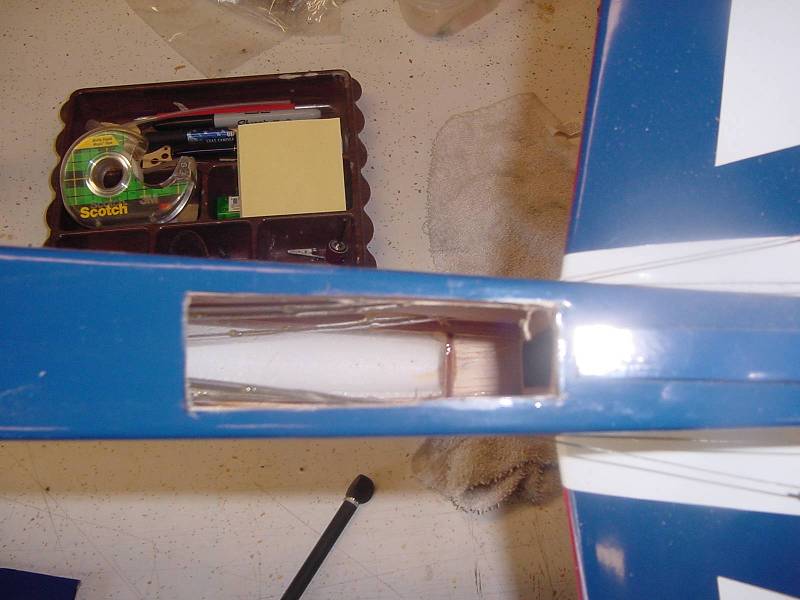

I took it out for balancing this weekend and wound up way nose heavy. But then I almost expected that, you see I have a GS2300 1.4 2 stroke up front with an aluminum spinner on it and APC 16 X 10 prop. I'm using a on board glow driver system and that along with the receiver and battery were located behind the CG former.
So I sent A PM to AreoBob asking about his battery setup and went with cutting a hatch in the tail and locating the battery just forward of the horizontal stab. I'm using a 5 cell 2500 mah Ni-Mh pack.
I'm a little heavy at 9lbs 6 ozs, but frankly I don't see that as a problem either.
some pictures og the battery hatch.
the maiden should be this weekend just before I leave for RCX
MikeR
MikeR
